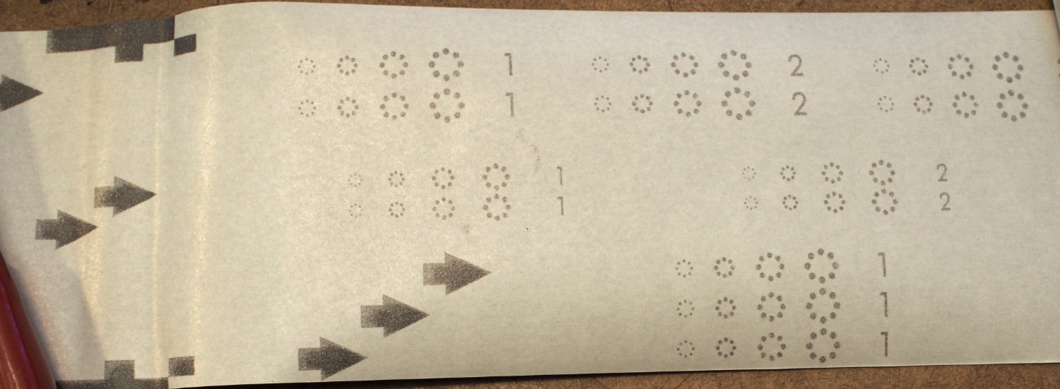

Yes, weak, sort of a fine 18% gray ink rather than black ink.
THere are two big fat arrows, then 4 dotted circles appear, followed by the 1. NOt easy to see with red windows.
