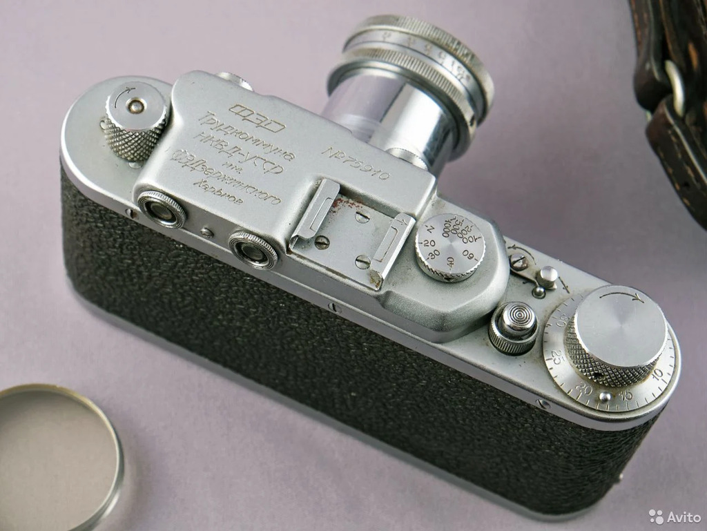

it was all hand made until 1935, with lenses individually adjusted to the bodies.
these early hand-made FED, numbered on top plate, with the inscription "Trudkommuna in the name of F.E.Dzerzhinsky" first, then "Trudkommuna NKVD-USSR etc" can be quite expensive. (trud kommuna = work commune). WW2 did suspend production but some batches for the military and these had a 1/1000 speed and are nicknamed "kommandirsky".
After 1935 the marking "Trudkommuna" is replaced with "factory" then "kombinat", as the "commune" was shut down and became a regular factory.
a Trudkommuna NKVD-USSR with the 1/1000s (from an a listing on Avito):

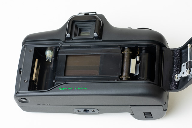

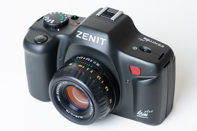

I briefly owned one of the last KMZ-made film cameras, the Zenit KM+, circa 2005. It felt bulky, it was noisy, and parts of the plastic housing flexed in a none too reassuring manner. And yet, I thought it was a remarkable last-gasp modernization effort, with the packaging alone being an enormous upgrade.

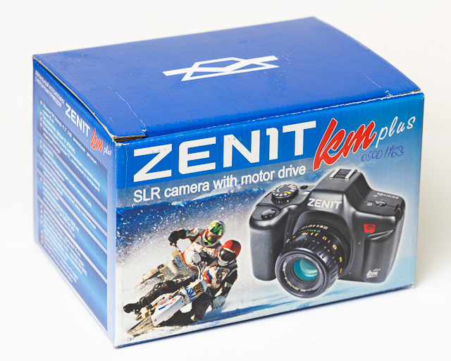

For comparison's sake, here's the packaging for the Zenit 212K. But the factory inspection date was a surprise: November 11, 2015, less than 5 months prior to my purchase!

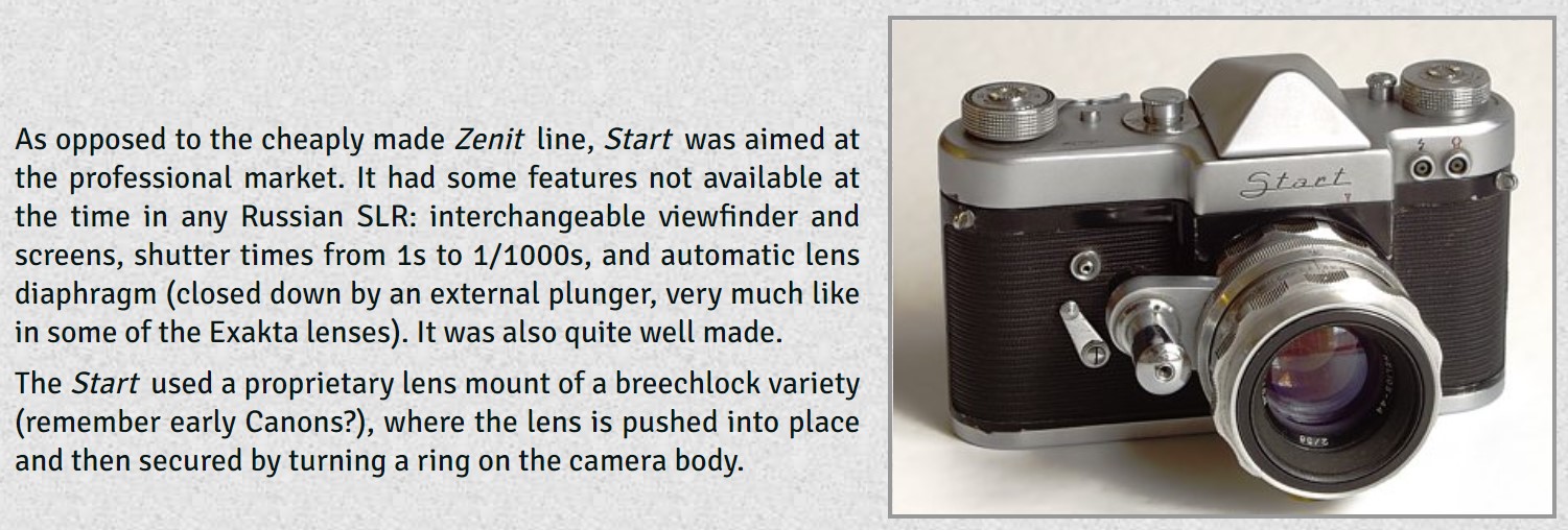

I have had a number of Russian cameras, a couple of Feds, a Kiev (lovely camera) but one that rarely gets a mention is also rare to find called 'Start' It was seemingly a hybrid design with features from a Zenith coupled with that of an Exacta. The lens was the ubiquitous 58mm F2 Biotar copy. The diaphragm was auto or manual operated like an Exacta with a plunger shutter release on the side of the lens pressing on the actual release on the body. There was a lever wind and a film cutting knife again like an Exacta. The shutter speeds appeared to be generally accurate 1sec to 1/1000. The mirror was not instant return but when you wound on the film a cord attached to the mirror pulled the mirror back into place.
The prism was removable as was the focussing screen.
There was also a 39mm thread adpter which allowed the use of early Zenith lenses to give a limited range of tele and wide angle
For what it was the lens performed very well and a decent 12x16 could be made sso long as the cammera had been on a good tripod
If you think a Nikon F5 was heavy you have not used one of these!
I owned it around 1964./5 and sold it to a friend in the Army to fund the purchase of a new Pentax SV.

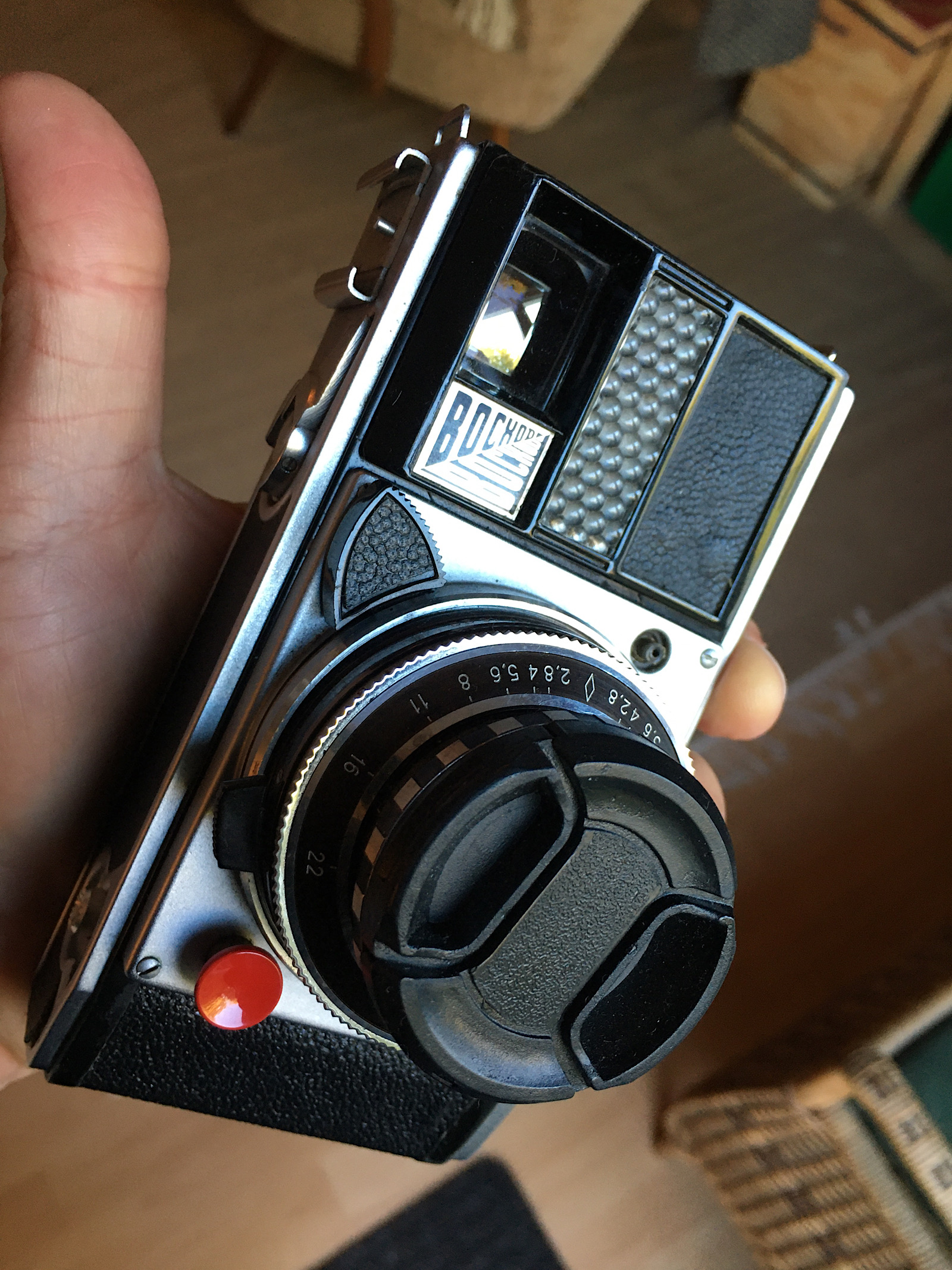

I’ve been getting some pretty good results with the LOMO Voskhod (Восход) recently. Definitely a weird camera but also well-made with far and away the best viewfinder, a very good triplet and some good weight to it. The shutter pull is very soft but I actually find that easier to shoot. The lens is also recessed very deep in the lens barrel which helps with keeping out stray light.
The image on Kodak Gold have that glows triplet vintage look, like the Lubitel just in 35 mm.
I can’t overstate how nice the VF is. Why did they never manage to put one like that in the Zorkis or FEDs?
