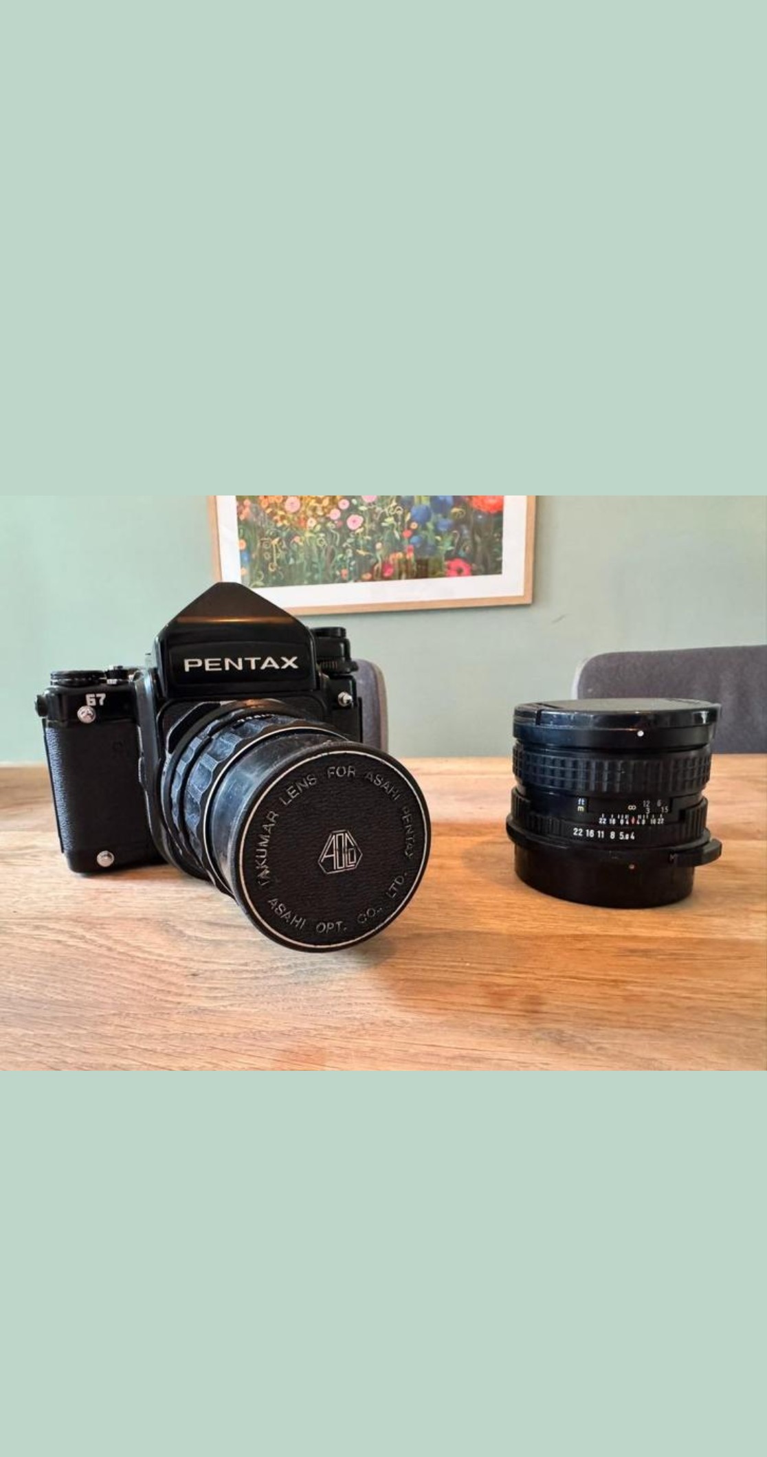

Hi,
This weeknd I’m going to inspect a Pentax 67 (Mark 3), that’s being offered for a good price, including two lenses. The seller says the camera was serviced by ACR (Amsterdam Camera Repairs) in 2023, with a new shutter mechanism, and he still has the paperwork.
Everything looks fine in the ad, but I know appearances can be deceiving. Since this version doesn’t allow dry-firing without film, testing the shutter speeds by ear isn’t straightforward (I’ll probably use the YouTube workaround).
For those familiar with this model, are there any specific things to look out for besides the usual checks (mirror lock-up, light seals, film advance, etc.)?
I really hope this turns out to be a good buy... This is supposed to be my last, beautiful camera purchase in my collection (I say that with mixed feelings, because if I come across another beauty, my backbone tends to be about as firm as an overripe banana 🍌).
Thanks a lot for any insights, and greetings from the Netherlands!

The seller keeps calling it a Mark 3, but officially it's a 67 (model previous to the 67ii) so it's the 3rd generation
yeah, thats a bit of a misleading description by the seller, it should be enough to call it a 67, vs the 6x7 or the 6x7 MLU.

The price for the set is 850 euro. Is this an o.k. price? (In Holland)

What exactly is included in the set, which lenses and which prism ? A photo of the kit would make it easy. Prism, if metering type should be with plain PENATX on front, no Asahi. If it is and it is AE type then it is as good as it gets.
It's this camera. Comes with SMC Pentax 45mm f/4 and SMC Pentax 150mm f/2.8

They've sen better days. Prism is correct match to body, it has blue cell (vs. CDS in older ASAHI prism) so assuming it works correctly it's best news. When I read about shutter having been replaced at last service I was wondering what hardship must have taken to get shutter mechanism to replacement state. Now I think there are signs of heavy use on every part of this set. In my judgment 850 EUR is a border line deal, and only acceptable if lenses have no marks, focusing screen is clean, meter is 100% working correctly, and mechanically there are zero issues (service should suggest there are none, but it's been 2 years since).
All in all, if everything is clean, aside from external cosmetics as it can be seen, I would not call a great deal. But it also depends on your priorities.
I tend to value cosmetics as much as internals, partly to cosmetics being prior use indicator, so this I would not buy myself. But value wise: 150 lens is in 150 range, 45 lens is in 250 range, but both in much better cosmetic condition, that body with that prism ??? HERE is a link to one body on ebay.de (close to you) in seemingly great condition (offers taken) .
Also keep in mind that with that lens pair you are likely to feel the hole between 45 and 150. Getting 90 alone is some 300-350+ getting 105 is more (I disagree on 105 with myth around it, but I'm in minority). So, if you're thinking of standard lens 90/105, it's best bet to hunt for a set with it.

Thanks for the advice brother! I didn't think about the gap between the 45 and 150. It's true, I want to use the camera primarily for portrait photography for now. So you got me thinking, also about the cosmetics of the camera. It doesn't say everything, but it says something. Also the seller does not want to sent me the photo of the service receipt and the service done on the shutter mechanism for me thinking... I think I'll pass on this one. Thanks for the heads up!
I think it's a good choice for now. I would suggest to monitor these auctions and in 6 months you will find a nice example. As for portrait lens, 150 is not bad, but I would go with 165 instead. There is 2.8 and a Leaf Shutter 4.0 if you need fast flash sync. Either is to me perfect combination for P67 doing portrait work. And there is also a soft focus 120 if you care for one (typically quite cheap).
Also on lenses, prices you see on high side ... well they don't sell. I got a 45 in like new condition for 250, there was a 165/2.8 last year for around 200. Most lenses, with exception of 75 AL and 75 shift, can be had very reasonably, patience is all it takes.
