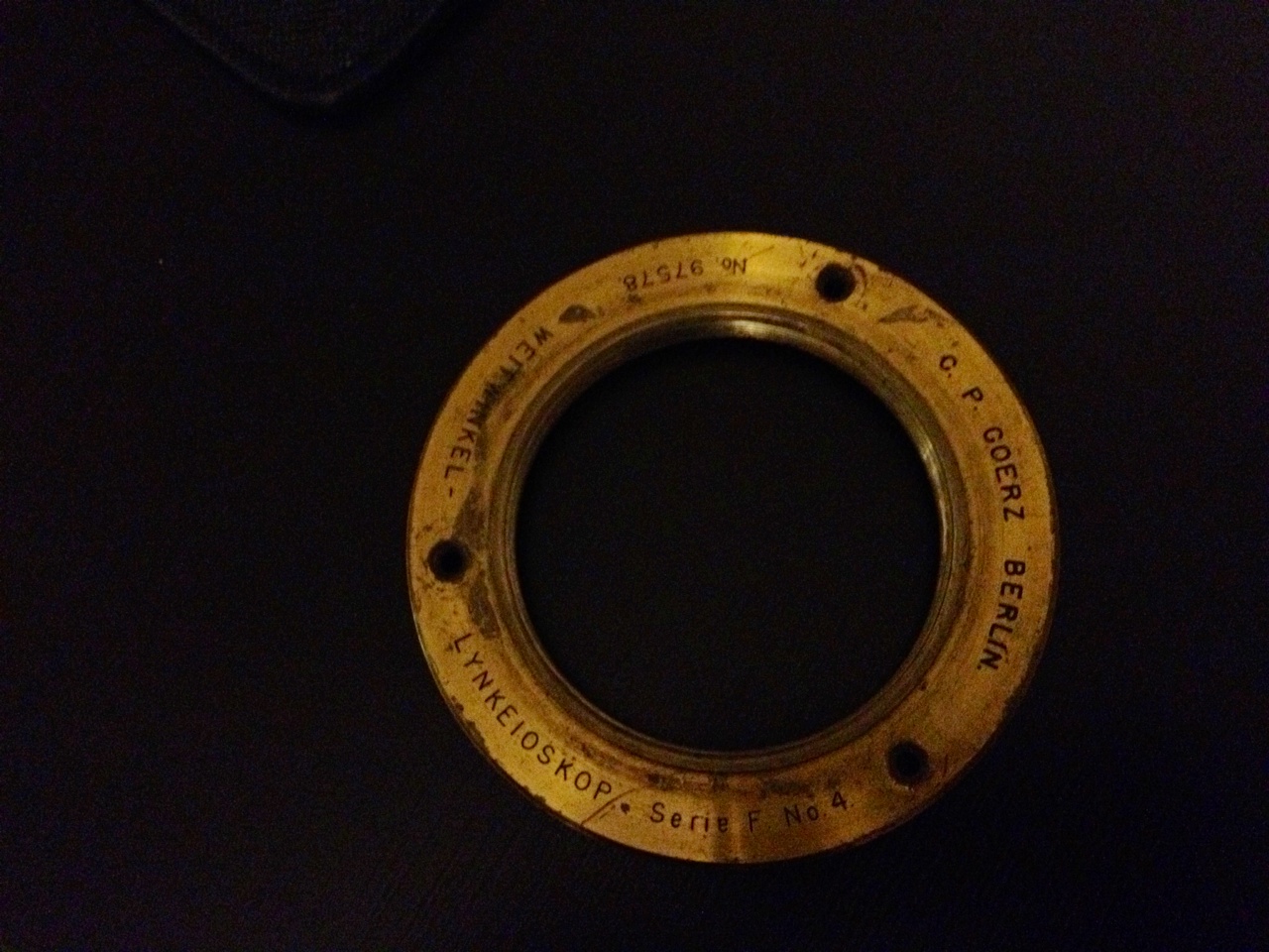

Hi All,
I just got a new treasure: Goerz Weitwinkel Lynkeioskop Series F No4, serial 97578.
Actually it's in really good shape, the glass looks almost perfect.
Anyone got more info on that? Focal length? How much it covers? When it's made? How much it can worth?
thanks

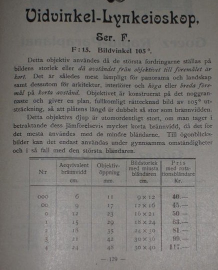

I got another source of information:
FL: 60-240mm
f: 15
angle: 105°
designed by: F. Weigert
offered: 1890

A quick view of what is available on the web place it at 1902/03 (http://motamedi.info/serial.htm#ross)
with a value in the range of 2-300 Euros (Dead Link Removed)
The standard Lynkeioskop appears to be a Rapid Rectilinear configuration (http://www.lungov.com/wagner/c/104c.html). Wide angle versions of that type of lens are not uncommon.
Whitey, you linked to the serial list for Goerz American lenses. This one was made in Berlin, Germany.
It's a wide-angle rectlinear, and a pretty good one. Not knowing the focal length, I can't say what it covers.
Dan Fromm
Mar 23, 2005
6,806
Per P-H Pont's Goerz chronology, 97578 was made no later than 1900, perhaps in 1899.

thanks pierre! Based on this info the lens will cover an A3 sheet, that is around 20 inch. Sounds huge to me.
