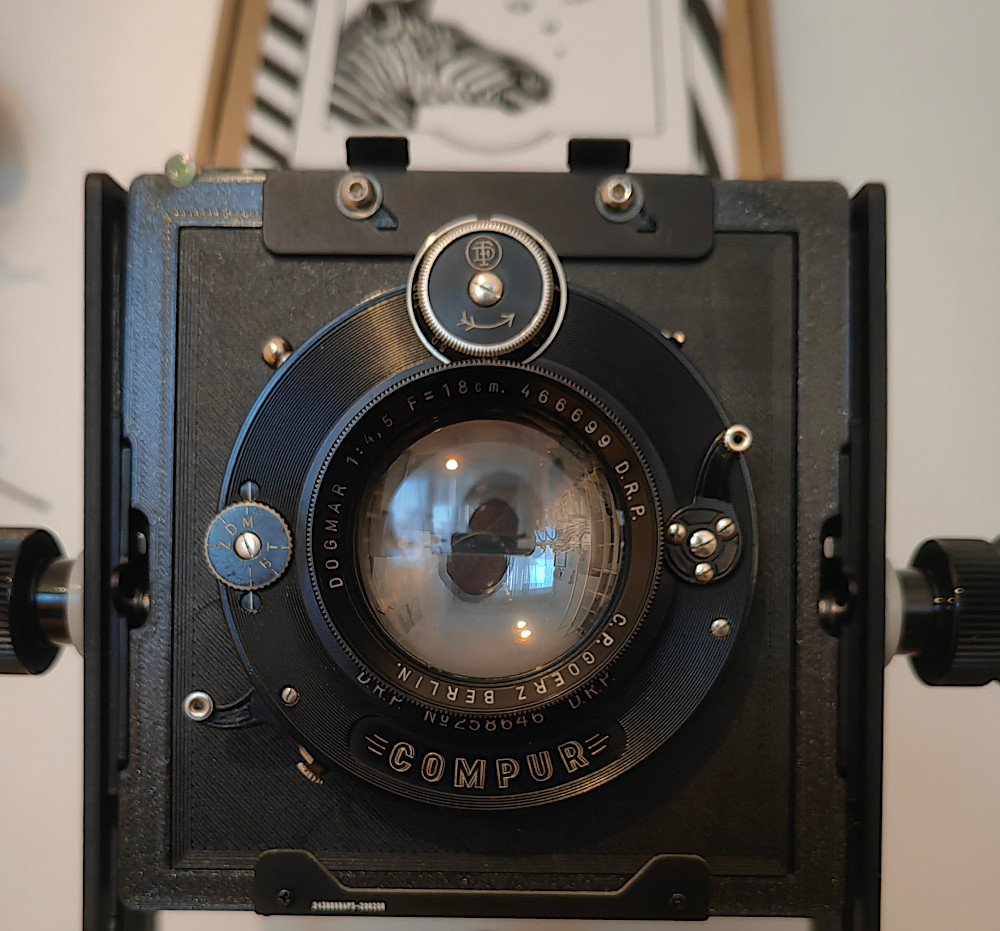

Hi Friends,
I have already received my Christmas present, my Dream Lens in mint condition and ZEBRA Dryplates :smile:

i am happy its a goerz in mint condition, nobody worked on this lens and its still fully functional, i clenaed every element and now its like new. i always wanted to have one like new, its small and sharp lens with a little bit lower contrast, for some images perfect.
this winter i am going to use it exclusively.
Very nice! I get fine contrast with my Dogmar and black and white film, and it's very sharp. But it's good to be careful with uncoated lenses like this.

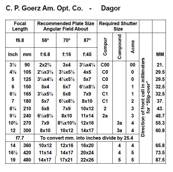

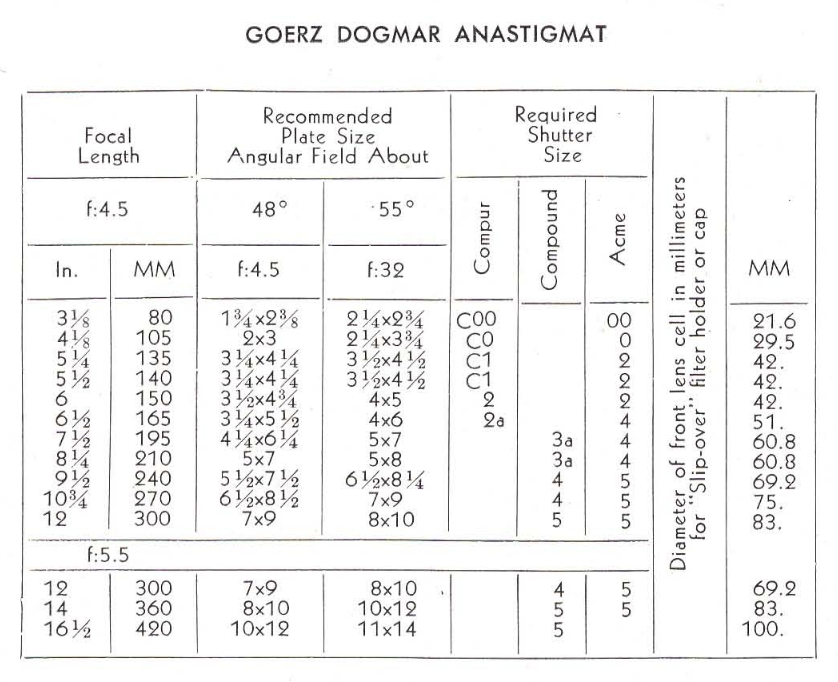

C.P. Goerz American Optical Co. also made the Dogmar. My copy of a 1938 catalogue and price list shows them available in focal lengths of 3 1/8 inch through 16 1/2 inch. 3 1/8 inch through 10 3/4 inch were f/4.5 lenses; the 12 inch was available both as an f/4.5 and an f/5.5 lens. The 14 and 16 1/2 inch Dogmars were f/5.5. These were available variously in Compur, Compound, and Ilex shutters.
These were still shown in the 1951 Goerz catalog on cameraeccentric (website not available at this time so I can't check the details). These would have been coated. Currently there is a C.P. Goerz A.O.C. 6 1/2 inch Dogmar, s/n 771680 on ebay. It is in a No. 3 Acme.
The Dogmars are not shown on my 1960 C.P. Goerz A.O.C. price list, the next data point I have after 1951.
Thanks for that info. The vast majority of Dogmars I've seen for sale are in the 150mm-210mm range (or inch equivalent--6in-8in). I'l love to find a larger one in a shutter, but they seem very uncommon--even the barrel lens version are hard to find.
David
Got a look at the 1951 C.P. Goerz A.O.C. catalog via the "Wayback Machine". By 1951 all the f/5.5 Dogmars were gone, the 12 inch, 14 inch and 16 1/2 inch focal lengths. The longest available was the 12 inch f/4.5. Wollensak Rapax, Ilex Acme, and Ilex Universal shutters were supplied depending on the size of the lens.
