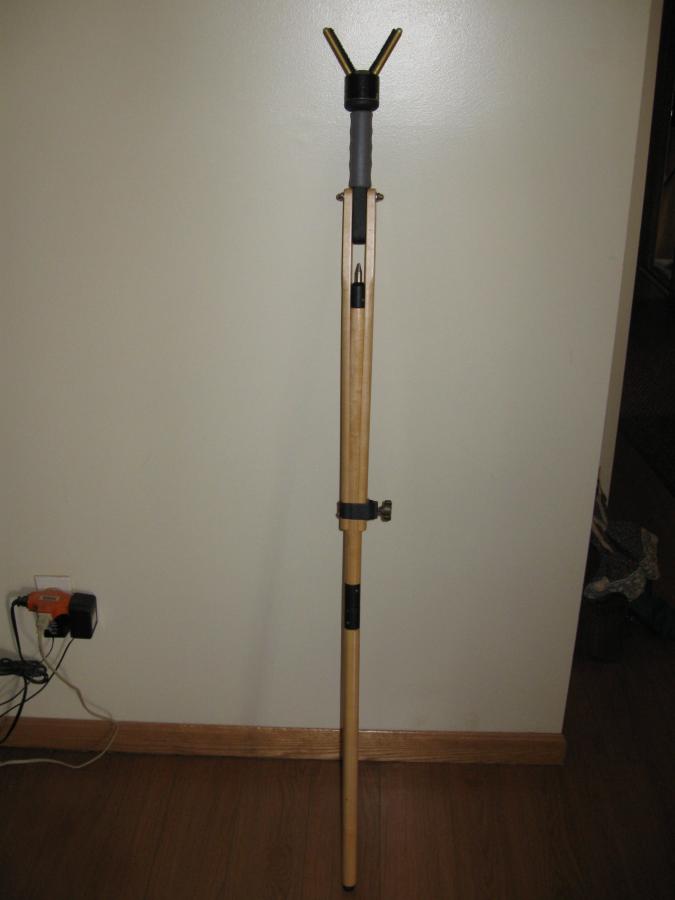

As far as weight goes, that is something I always have to contend with. I own a Wisner 8x20 Expedition. It has both vertical and horizontal backs and front standards. In either configuration, especially the vertical, this 11lb camera shoots with some pretty large lens. I use a 17x20 Wollensak Versar (22 1/2") lens that is a pretty heavy cannon. I just use this under the lens. The problem with this camera is not ever the weight of the lens but the small 5 1/4" lens boards that it was designed with. I'm still scratching my head on that one. If Ron ever reappears I'll ask him why such small boards on ULF cameras. (there was a url link here which no longer exists)
