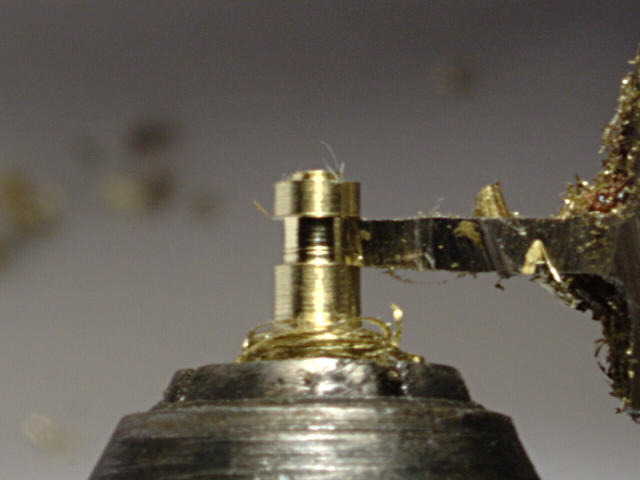

Make a few extras as those tiny pins have a tendency to jump out of the holding tool when attaching.
Lost the pins I made the other evening, fortunately the lathe is still set up. Three more turned this evening :smile:

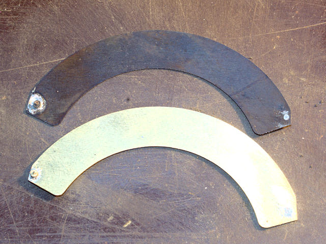

Settled down to solder a replacement pin to the old blade last night. Gently scraped some of the black stuff away and found more black stuff underneath. It would appear that the blades are made from a phenolic laminate.... Also noticed a couple of the other blades have cracks around the pivot points, so it looks like I'll be making a few more :sad:

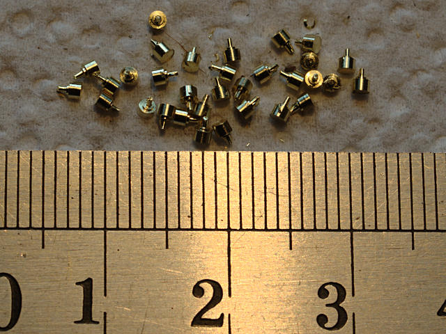

Whilst waiting for some shim stock to arrive (thanks trythis, much appreciated), made a few pins - 1.5mm diameter, 1.25mm long, with a 0.20mm shoulder. Lost a few in the bottom of the swarf tray, and a few more pinged off in to the dark recesses of the workshop.
Ended up using double sided sticky tape to hold the brass to the table while cutting the blades. Cutting forces are minimal with such thin material. After soldering the pins in place and filing down the pips, dropped a blade in to a ammonia copper carbonate solution. This was prepared by dissolving a spoonful copper sulphate in ~100ml water then adding sodium carbonate a little bit at a time until it stopped foaming. The precipitate was then filtered and washed a few times by pouring hot water through the deposits left in the filter paper. The precipitate was then dissolved in ~100ml of household ammonia (nominally, a 5% solution) and a blade submerged for 20 minutes or so. The attached image shows the result - Should be more than adequate for an aperture blade.
For reference, should anyone come looking for information, I've also attached the CAD file. This is for a C.P. Goerz of Berlin 360mm Dopp-Anastigmat Series III Dagor - Other variants of this lens may use the same shape and size of blades, but no guarantee.
