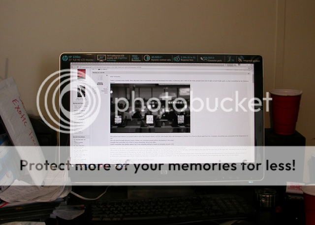

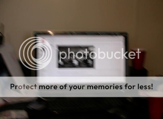

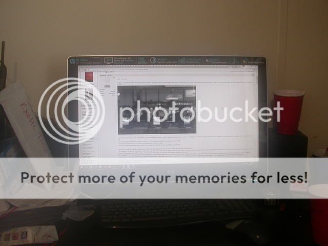

^^^ Not to mention that: 1. It looks nothing like motion blur and 2. The 'glow' radiates from the center outward.
It's either moisture fog or internal fog on/in the lens.

Straight pic...
Motion blur...
Lens fogged with breath...

Old-N-Feeble - excellent example.
Thank you, Truzi. There's nothing like entering into the realm of the 'real'. :D
