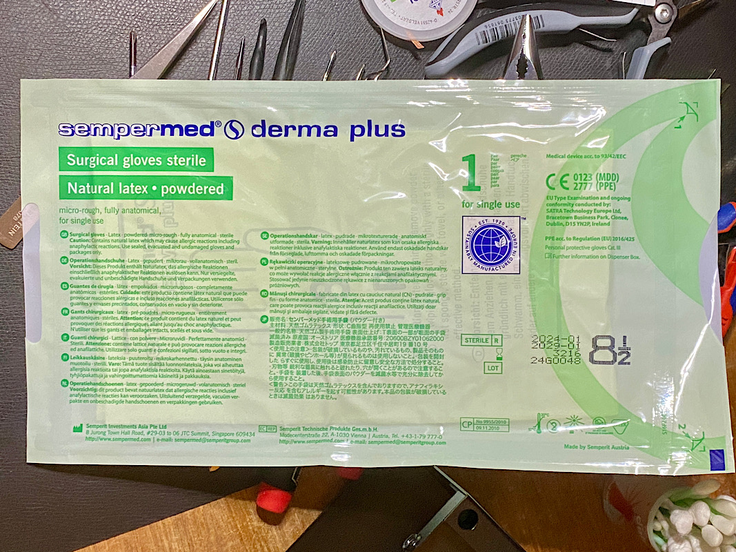

Yesterday I went to see my surgeon for a minor operation. He has such beautiful, delicate tools that I could also use for working with my SLRs. For this reason, I also like to go to my dentist 😌
I asked him where I could buy surgical gloves. They fit perfectly, and if you can perform operations on patients in them, they should also be suitable for working with cameras.
The gloves I've been using so far are less suitable for delicate work and don't fit tightly.
My surgeon was so nice and gave me three pairs from his stock.
Today I tried them on and I'm thrilled.
Nothing is loose; they fit wonderfully, tactilely ideal, powdered on the inside, and made of latex, which apparently also resists acetone, at least longer than the blue nitrile gloves I've been using so far.
Only these and no others, even if they aren't cheap! 🙃
