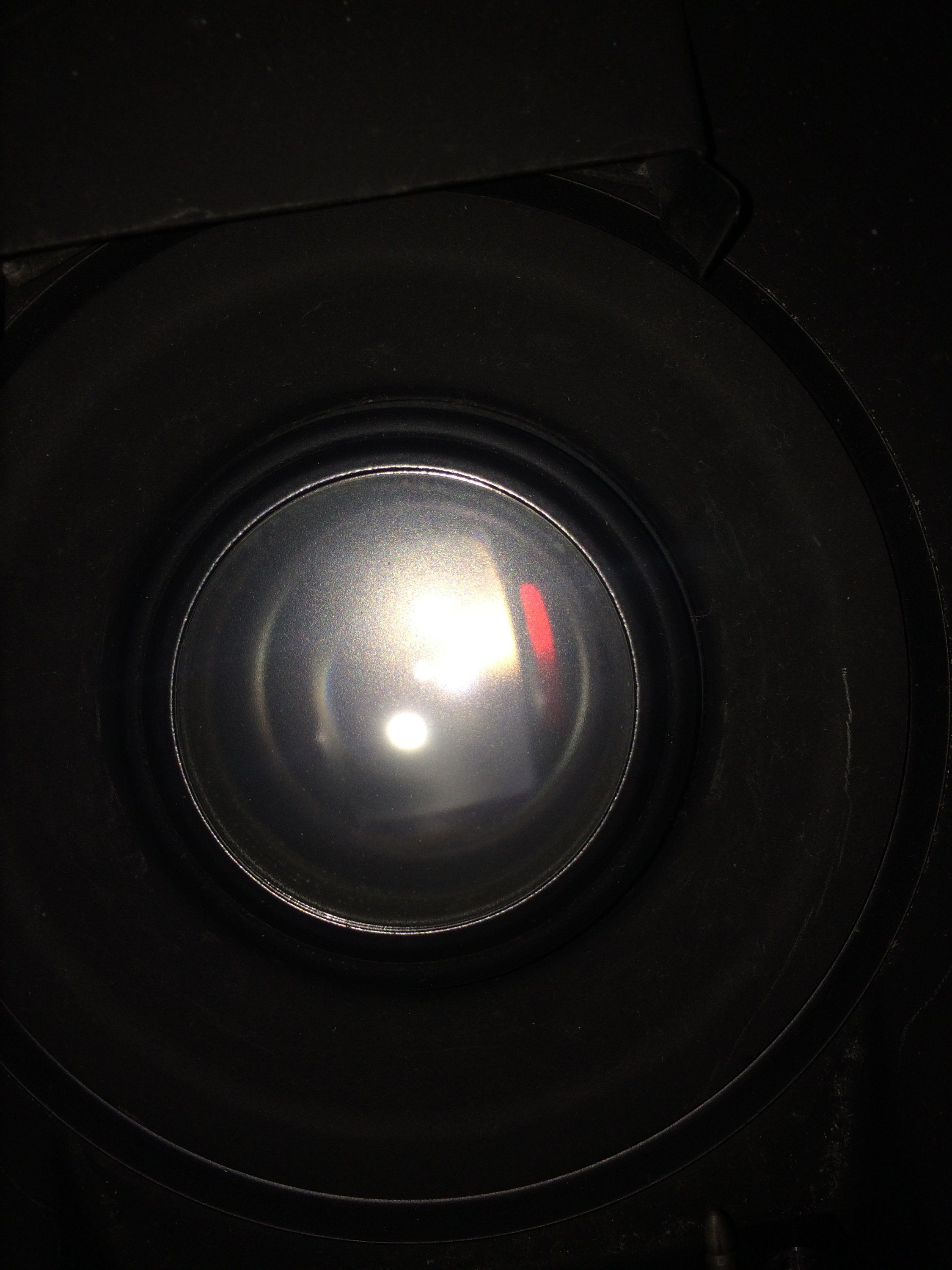

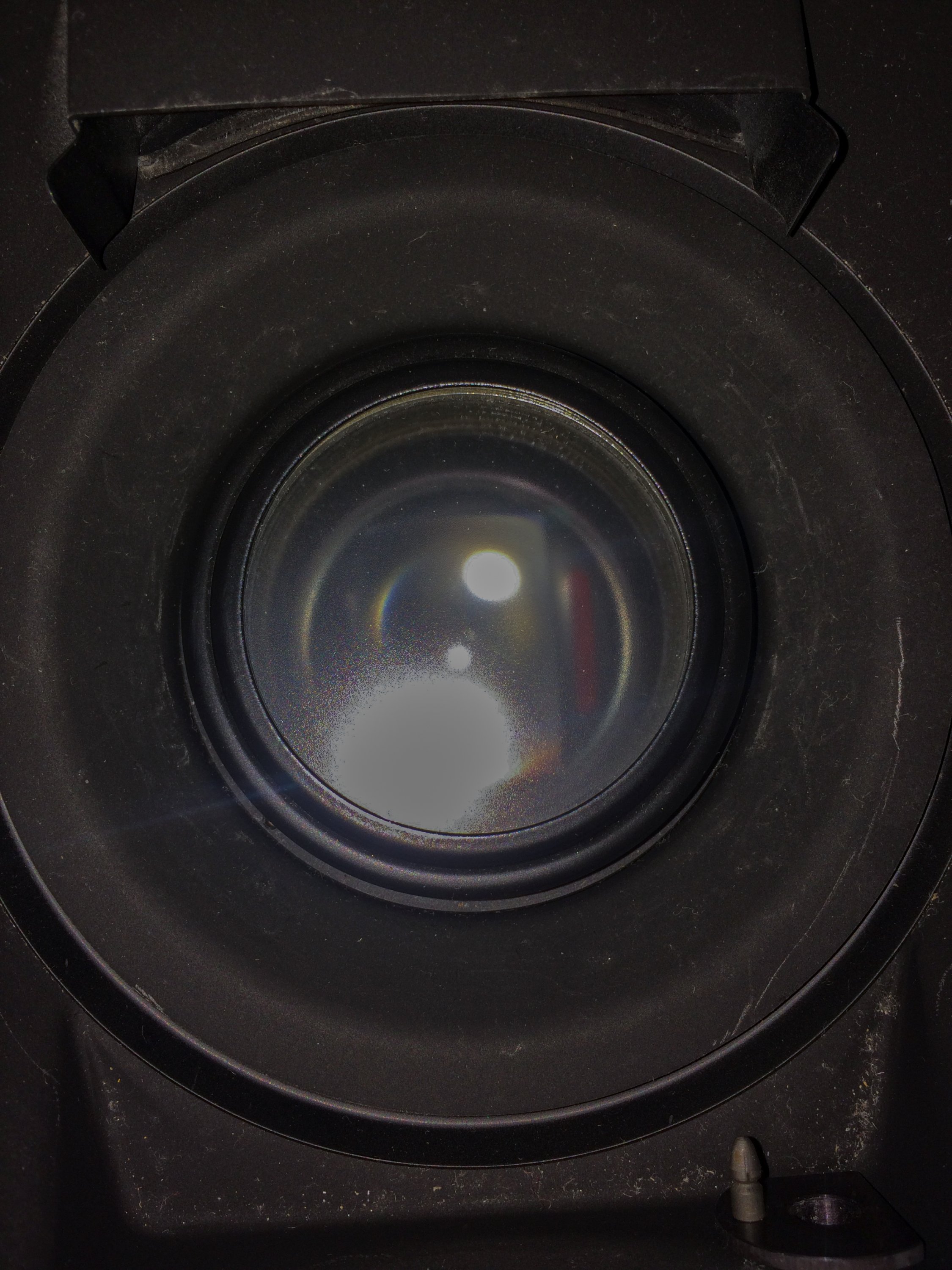

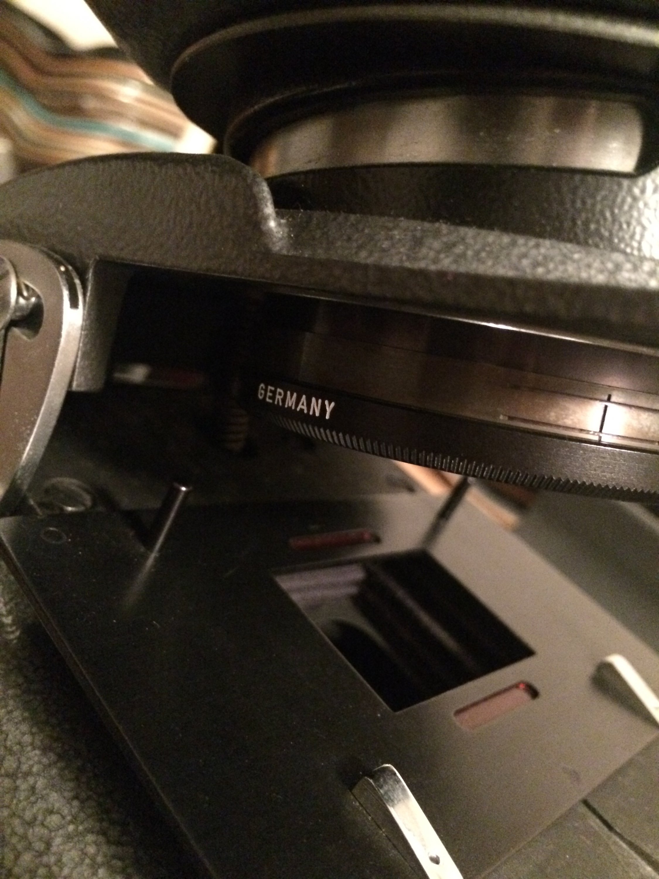

I took some pictures. Sorry for crap old Iphone pictures.

The first image shows the anti-newton ring thing over the bottom of the condenser. The second and third look to be some sort of ground diffusion glass over the top of the condenser ... it won't hurt anything. It is there to soften the light going through to minimize scratches on the negatives ... i have a Minox enlarger that has a very dense diffuser that does the same thing.
You could probably remove it unless scratches on your negs are a problem. In addition to minimizing scratches it probably reduces definition a titch...the head of a focomat is designed to diffuse the light a bit already, so this seems to me to be overkill.

Difficult to see what exactly is on top of your condenser. Can you take that glass on top of the condenser out of there and take a picture of it?
At one point you will have to take out the condenser to clean it. When you do first take away the AN glass, otherwise it falls off when you bring the condenser up !

Thanks.
When I looked at it it's very slightly frosted on one side so it make sense that it is a kind of diffuser. I'll try it out some day. The best thing is maybe that it prevent some dust on the condenser. I'll have to do a cla on the enlarger. I noticed that the helicoid need some grease, it have some kind of play.

Question: How is the glass seated up there so it isn't coming in contact with the filter tray? Just for fun I tried to fit a diffuser in mine so I could use a vario cold light that was meant for a bessler. I could never get the diffuser to seat so it wasn't in contact with the filter draw.
It sits just under the bajonett mount of the condenser. It is a round piece of glass the fits over the spring.

Ahhh. Over the top of spring below the filter draw. Thanks.
It is difficult to know if this glass was Leitz made. It sounds like anti newton glass (slightly frosted) and therefore not like a diffusing glass. That would be more white. Anti Newton glass has little, if any, effect on the print. That depends on the intensity of the frosting.
I have an extra condenser that fits on to the standard Ic condenser and it comes with a white round diffusing glass that you can drop into and on this extra condenser. Made by Leitz for sure - probably to be used in combination with a point light source.
Anyway, also with the Focomats people made their own modifications and they're often interesting.
