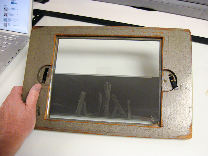

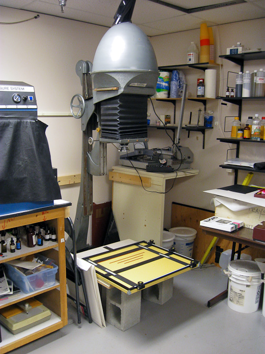

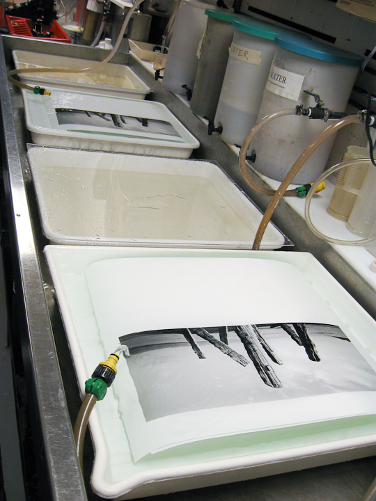

Windex diluted down with distilled water, some paper towels and some canned air. NO dust or Newton Rings on my prints from last night. Regular old window glass. I've thought about getting some AR glass for this negative carrier, but so far I haven't needed it.
