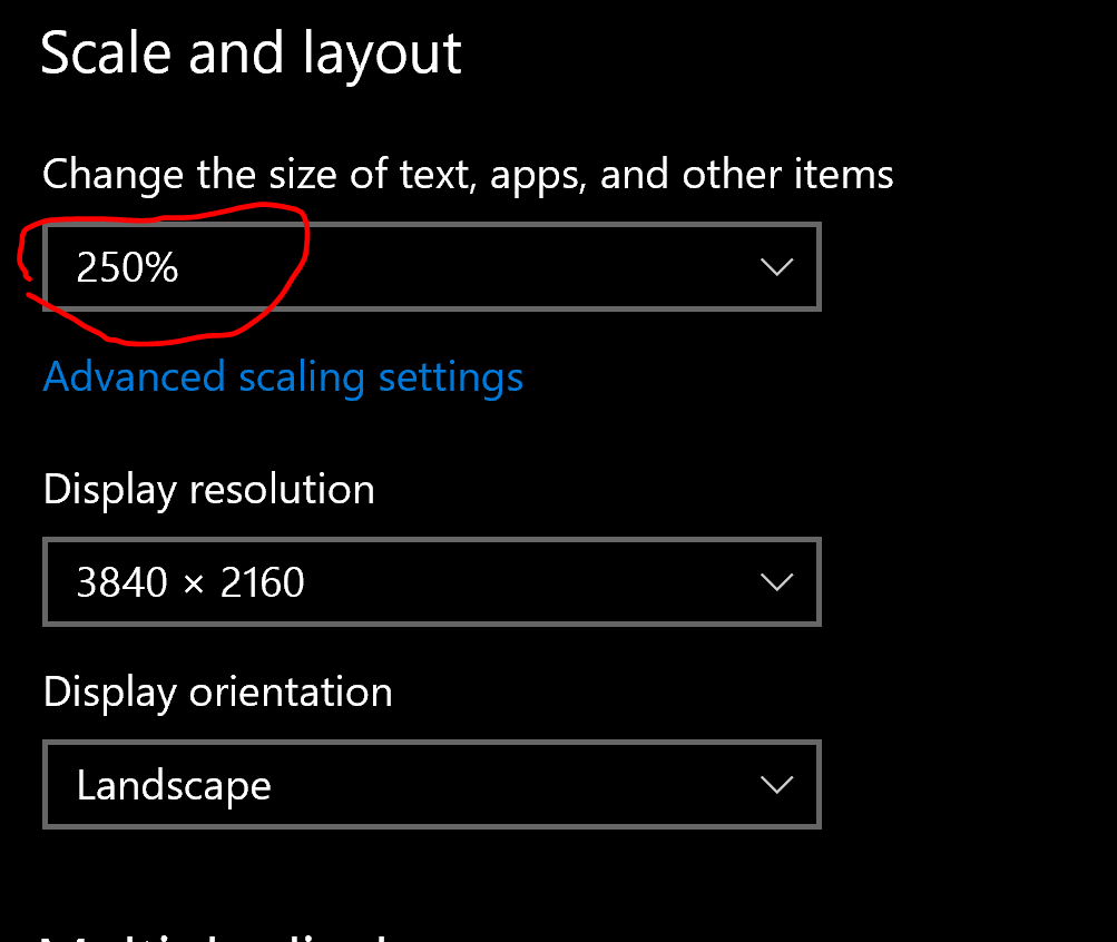

It may have something to do with either your screen resolution setting or the setting for the amount of "zoom" your OS gives to the UI of apps. Many pieces of software built with older frameworks don't play nicely with large screens. Mouse movement will be involved with the scale the OS thinks your UI elements are at, which sounds like it isn't being communicated properly to Gimp.
In Windows, the setting looks like this:

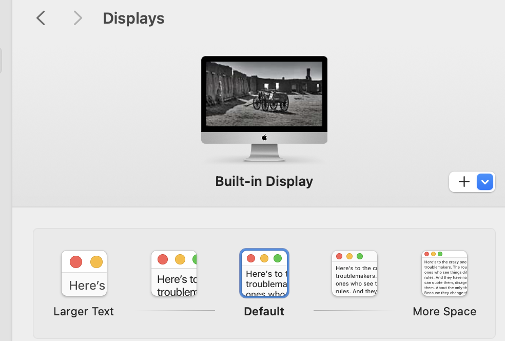

To find the screen resolution settings on a Mac, go to System Settings, then Displays and you will see:
If you hover your cursor over one of the five icons (Larger Text ... Default ... More Space), then the pixel dimensions of the screen for that setting appear under the icon.

Thanks for that, don't know how I missed it. So now I've tried it, and can report that changing the screen resolution in that way didn't solve my mouse/GIMP problem. Anyway it rather spoils the point of having a nice hi-res screen for photo-editing.
