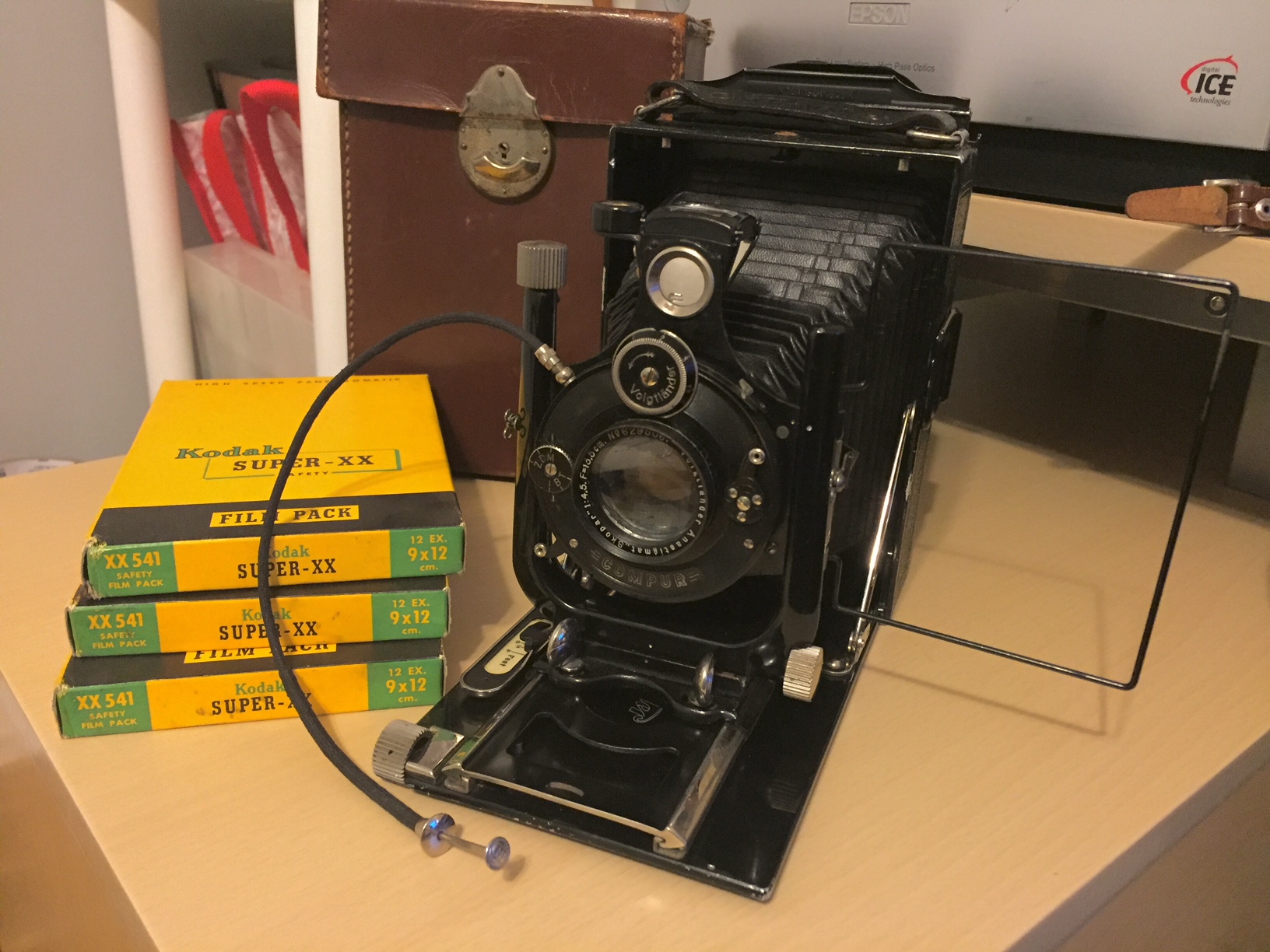

A colleague at work grabbed me in the hall and said he waned to give me something to help him clear out his basement. I was quite happy when he handed me a very nice Voightlander AVUS 9x12 in its original case, cable release and 3 x 12 exposure packs of Kodak Super XX (expired in 1954)!

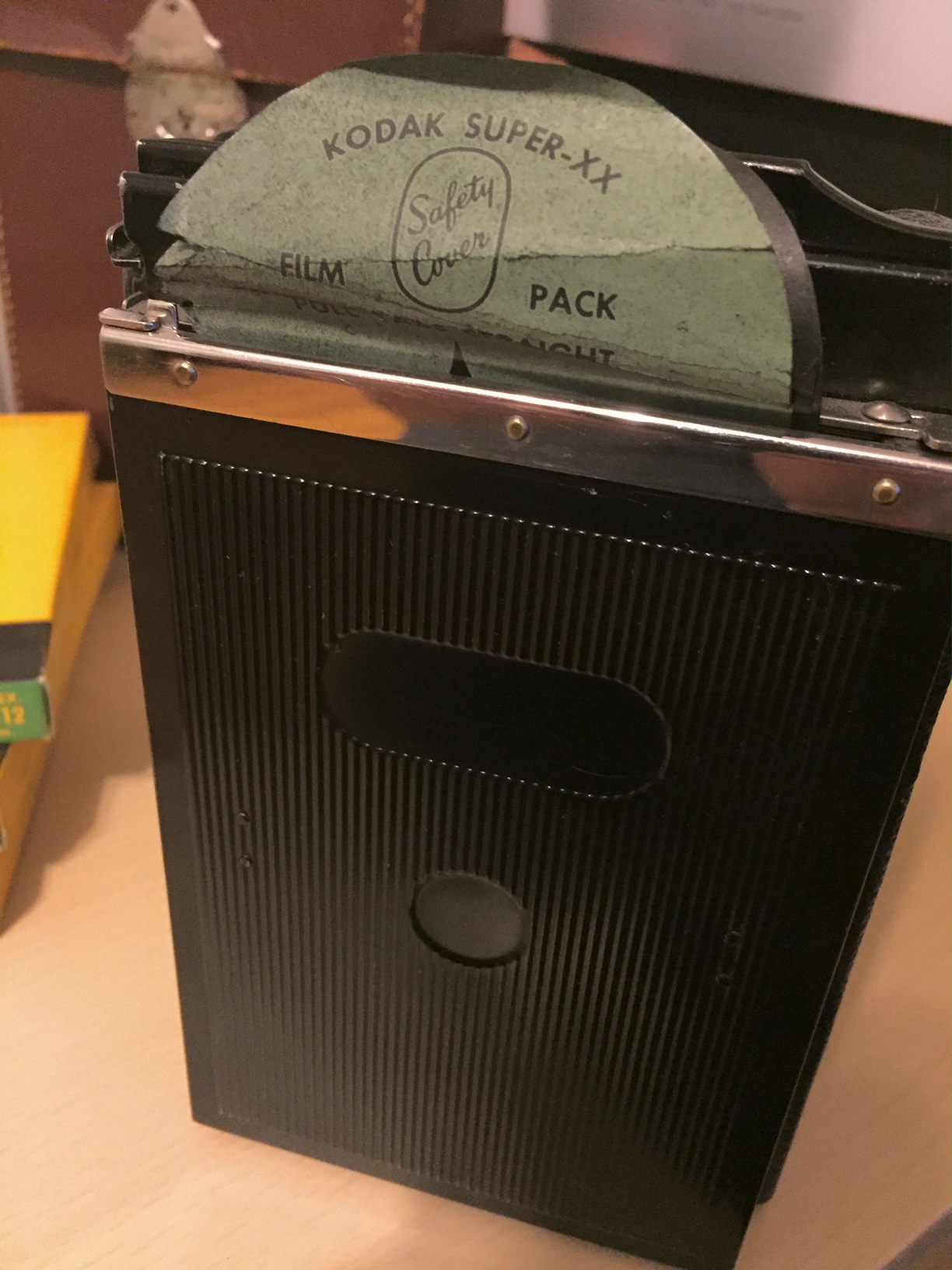

I later discovered that the film magazine had an additional 12 unused exposures of Super XX in it as well. Who knows if any of the film is good, especially the loaded magazine, but at least the 3 boxes of film are still sealed.
I, of course, will be looking for (at a minimum) both single film holders, plate holders and a ground glass to make the camera more fully functional and am piling back through past posts here to get some information.
There are some problems: the front lens element appears to have some fungus or separation and the shutter doesn't appear to have correct speeds below 1/50th a second.
I cannot tell if the front element is cemented or will come apart; looks cemented, so I might have to live with a diffusion filter built in until I can locate a replacement shutter/lens combo.
Really would like to find a ground glass for this camera and try out the limited rise and slide functions of the front standard.
Maybe I'll make it a point of detouring around closer to this person's desk each day, just in case he finds a Hassleblad or a Deardorf that is crowding his basement shelving...
BTW: Has anyone ever tried reloading a used Kodak Film Pack or are they destroyed in the process of shooting?

A search of the Camera Wiki.org site on Compur shutter serial numbers places this camera built in 1925!

Got the shutter sorted out with the help of this URL: https://www.photo.net/discuss/threads/dial-set-compur-cla.154324/
Not too sure about the 1/5th to 1/25th speeds, but they seem to be improving the more I exercise the shutter, so it might just need to be used to break in again.
Now if I could just get the front lens element apart and clean it...

You can make a simple groundglass by taping strips of matte scotch tape on a piece of plexi glass that's been cut to fit in the filmpack holder.
It took me a while to find the Voigtländer plate holders and 9x12 film sheaths, but it was worth it. The Voigtländer plate cameras are of high quality and fun to use. The lens takes the common 37mm slip-on filters and hood.

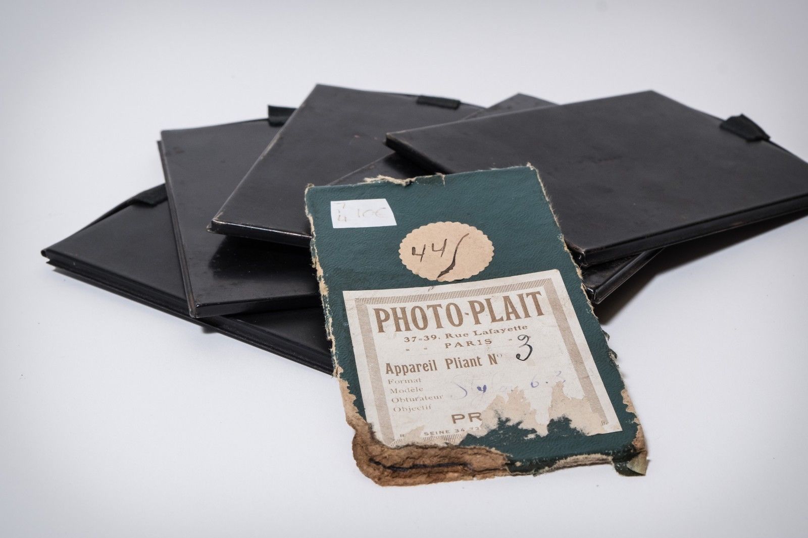

Well, I just bought some plate holders on Ebay. I hope I bought the right ones...
They look thin enough for the AVUS. We shall see...

I have seen those, but I think that some of the folded parts would have to be cut off with a Dremel for them to work in the plate holders or the focus will be off.
The inserts look so simple. Seems you could make them yourself with a small sheet metal handbrake, thin sheet metal stock and some black paint.
"Seen" is not "used".
Even the Kodak film inserts would be the same. I have numerous film inserts and all shift the film plane slightly but it's probably not enough to make a difference in practice. The ASA/BS standard has a reasonable margin on T distance. No-one comments about the differences between the old T distances used for 5x4, 7x5 and 10x8 and today's DDS Film holders.

I tried holders that had a frame and pressure plate so they could be used with both plates and sheet film on a 6,5x9 camera, but they were practically unusable because they had this problem of a slanted focus plane. I think they were Kodak holders. The focus was off by decimeters when you compare the top to the bottom of the frame.
