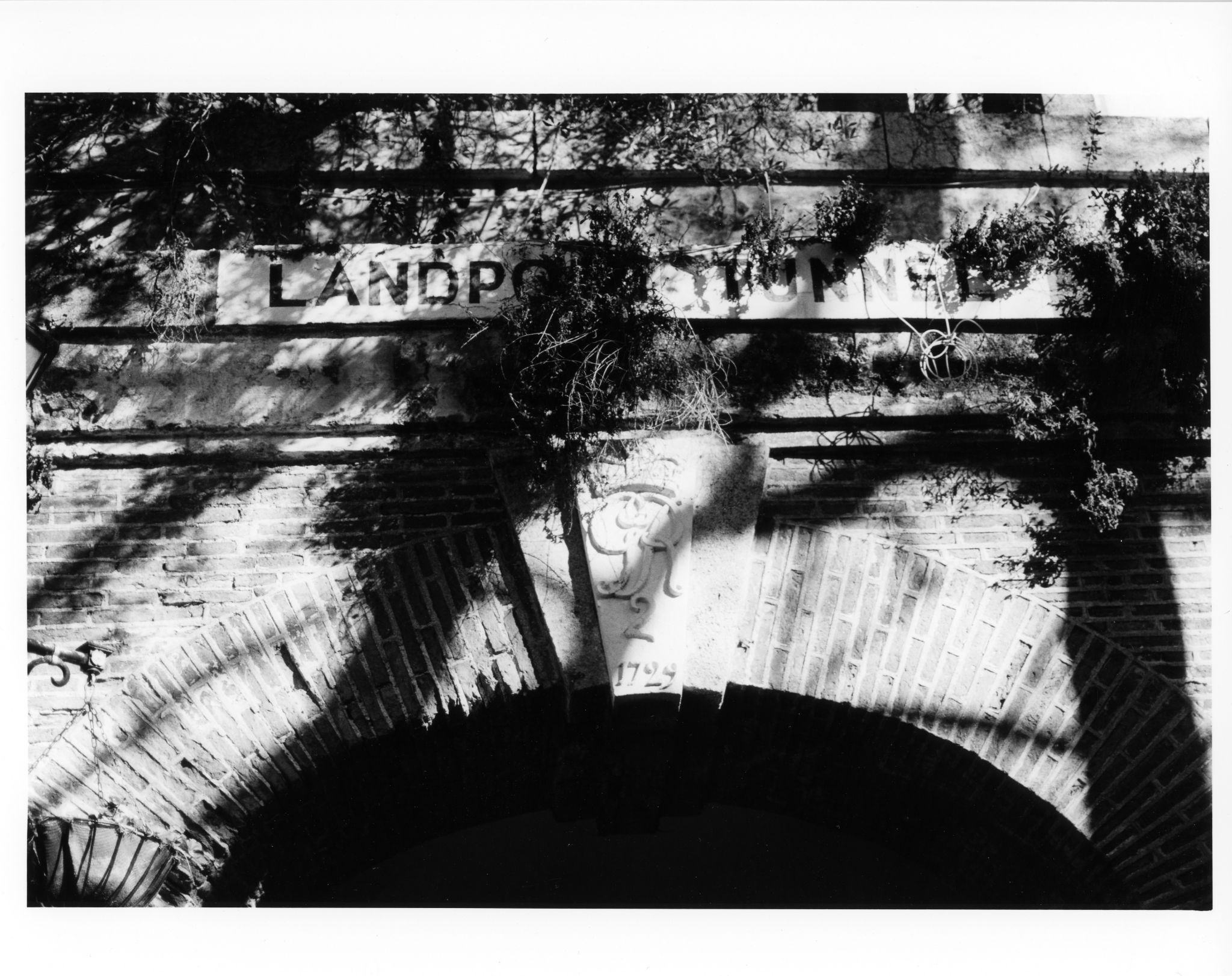

    I am based in the UK where contrast is very moderate even in the Summer (allegedly we do have a Summer in the UK). I've never had issues with contrast being too high (sometimes too low though). My prints print readily at grade 2 most of the time and occasionally need the printing contrast raised to 3 or 3.5.
    I am posted to Gibraltar 4 times a year. For those who don't know, this is a strategically important overseas territory on the Southern tip of Spain, approximately 15 miles from the coast of North Africa. It is a peninsula jutting into the Mediterranean Sea with numerous military installations including a navy base.
    In Gibraltar the weather can be very variable. The Rock influences the local weather to the point that it can be overcast in Gibraltar but sunny a few miles away. Often there is blazing sun and light reflected off the sea. This creates challenging light for photography and the contrast can be so high that some of my frames (never a whole roll) are almost unprintable even at very low printing contrast. The pale limestone of The Rock also reflects light strongly in sunlight.
    1) I wonder whether I should adjust my exposure and developing to deal with this. I often (but not exclusively) use the Kodak TMax films. This time I will probably just take 35mm equipment. Kodak recommends overexposure of 1 or 2 stops (which would take TMax 100 down to EI 25 or 50 a bit slow for handheld) or TMax 400 to EI 100 or 200 (very usable). If the roll is a mixture of high and "normal" contrast scenes I don't want to ruin the normal contrast shots by altering anything too drastically.
    2) As above but any adjustments to make with Ilford FP4+?
    3) The same but what about colour films e.g. Ektar 100?
    PS: I will often be using a yellow filter for B&W landscape shots. This has a much stronger effect than in the UK mainland where sometimes the effect of a yellow filter is minimal even with blue skies and fluffy clouds. In Gibraltar there is significant darkening of the sky.
    TMax 400 is probably the most versatile option as sometimes I will use longer focal length lenses to photograph wildlife and a higher EI helps to keep the shutter speed up for handheld shots without shake.
    Here are some example shots from the gallery which include films details:

    @juan @David Allen Thank you for your advice. I have never used a two-bath developer or made up anything from scratch. It sounds like it may be worth a try. The difficulty is I cannot say that a whole roll of film is filled with high contrast scenes as I don't shoot film that fast. I could for example, over expose the high contrast scenes by a stop or two and develop the roll normally in my usual developer (Xtol or DD-X). That is what Kodak suggest in the TMax instructions but I have not tried this as it is not a problem I usually encounter. Perhaps I am trying to have my cake and eat it by wishing for a way to expose and develop rolls of film with both high and normal contrast scenes on it without sacrificing either. My present way of doing things makes for easy to print normal contrast scenes and (sometimes) very difficult to print high contrast ones.

    You are very kind Doremus. Thank you. I do base my exposure on shadow values using a spot reading. I don't meter the deepest shadows but I suppose what you would call shadow with detail that I want to retain. Usually I just expose at whatever that shadow reading is. It has been suggested in this thread to meter the shadows and stop down 2 stops but if this is a high contrast scene where it would be advisable to add 1 or 2 stops the net effect of exposing at the shadow reading is to take the reading, subtract 2 stops and then add 2 stops i.e 0 adjustment of the shadow reading.
    Yes sometimes the negative is well exposed but has to be printed at a very low contrast (e.g 0.5, 0) but this does not happen that often so I may be making a mountain out of molehill.
