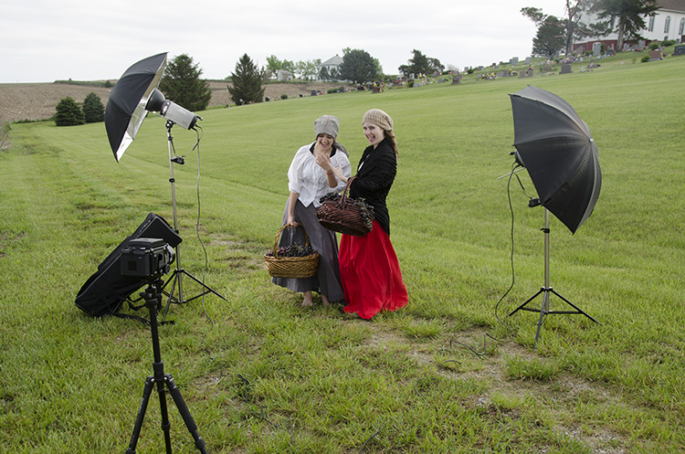

Not exactly Hollywood budget level stuff, but I find myself doing more and more shooting like this...

I second getting a light meter that measures flash. Getting enough output out of a small on camera flash to compensate for a sunny day might be tricky though, especially when you have to balance color temperatures with gels. If using more complicated setups with larger flash heads is not an option I would use a reflector instead of the fill flash. This should at least bring you reasonably close and allow you to adjust for the exposure difference during printing.
Your two exposures are independent - first work out the exposure that you want for your subject - which will be illuminated by the flash. This will come out to be a particular f-stop, and the subject exposure will be pretty independent of the shutter speed. Now that you know what aperture you will be using, figure out what the normal exposure for the background is using this f-stop. Let's say that you end up deciding to use f16 for your subject, and for the background to be properly exposed you want 1/30 at f16. Usually you will want some separation between the subject and the background, so to make the background darker, just increase the shutter speed - to 1/60 or even more, if you want the background brighter, then slow down the shutter speed.

strong flash will fix your situation, or getting a pc cord and an off camera flash closer to your subject ...
there is a lumedyne kit being sold in the classifieds currently, and it might be the solution to your problem ..
