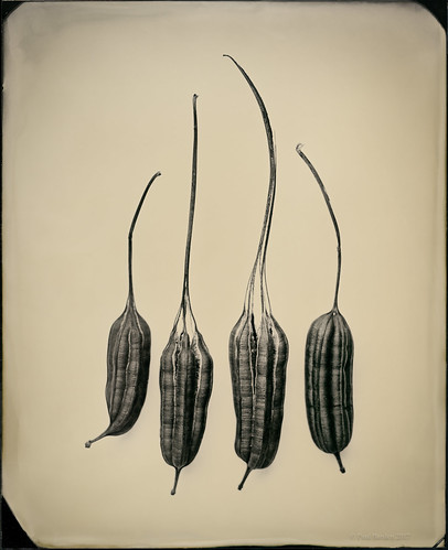

A recent 8X10 plate I made using freshly mixed Old Workhorse from B&S:
(Click here for a larger version)

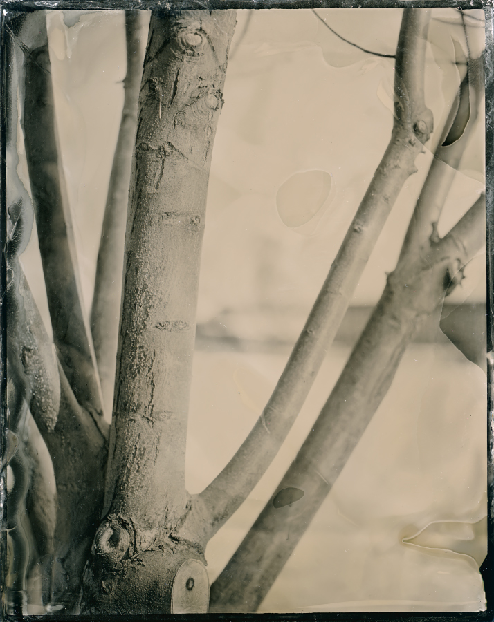

My first wet plate!
My aluminum came in, so I shot my first plate. Pouring the collodion is going to take some time to learn. I don't have a proper silver tank yet, so I just sensitized the plate in a 5x7 tray.
This was just a test shot, so I just took a photo of a tree outside my shop.
Shot using Lea's Landscape collodion.
Tintype Test 1 by Andrew Marjama, on Flickr
