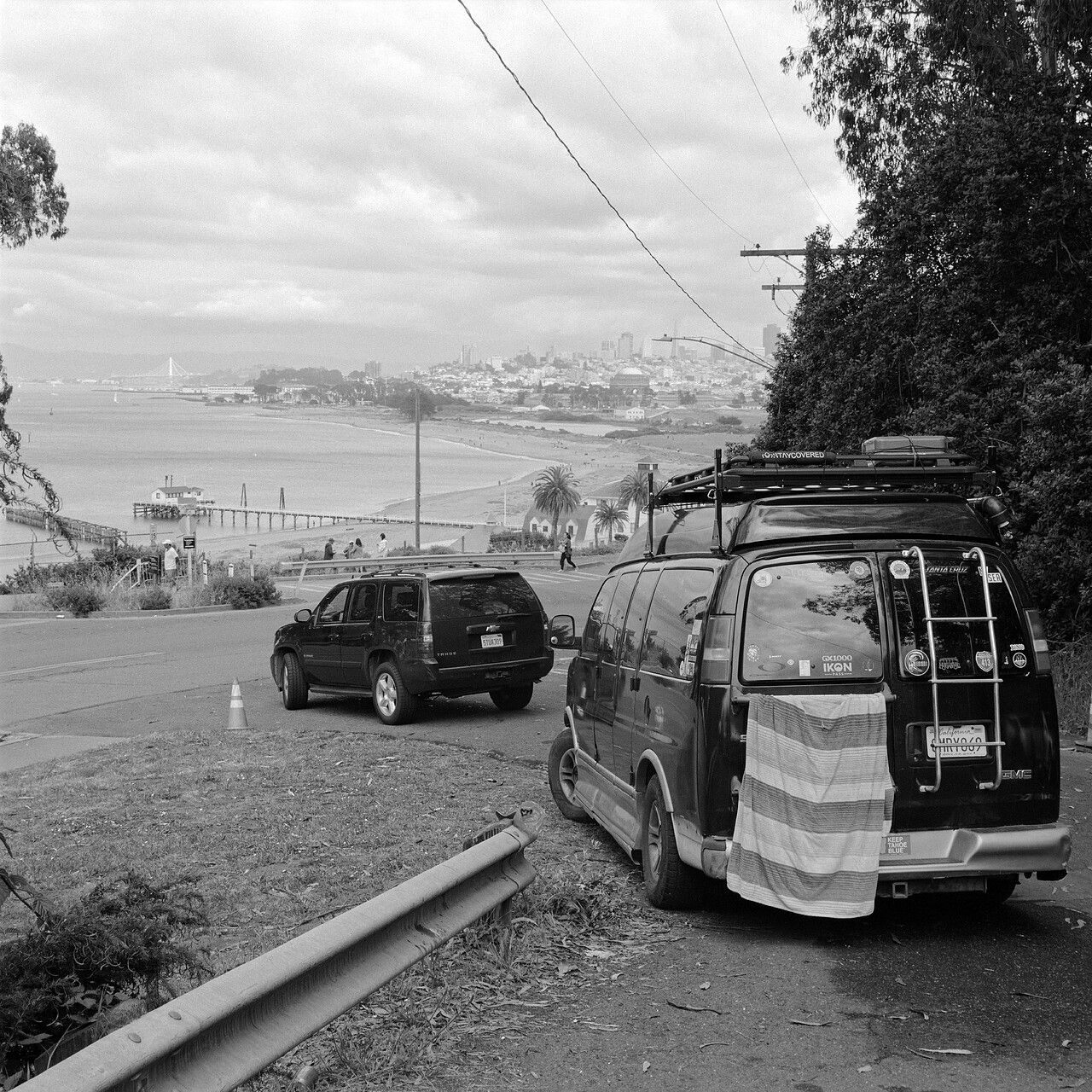

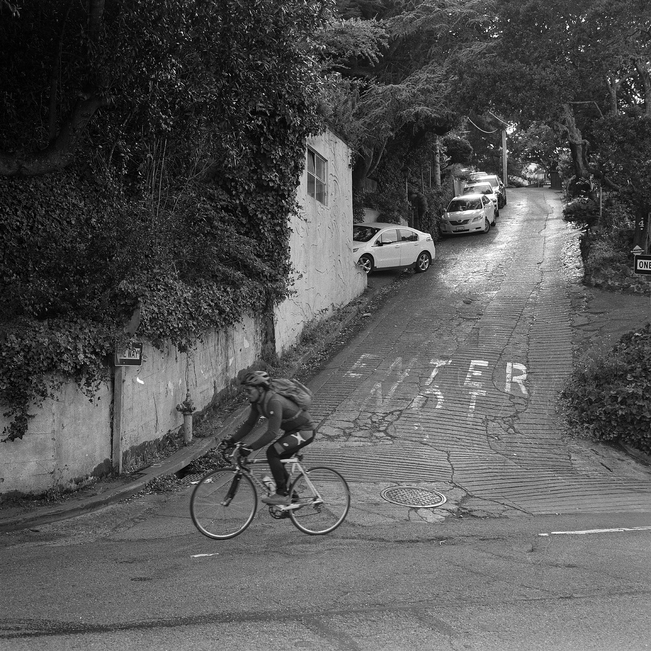

Here are some Ultrafine 400 samples developed in Ultrafine D76 developer (I used D76 time for Kentmere 400), they're all medium format though. If you like these results, I hope this will keep you motivated to nail your process:
Golden Gate Bridge
Surfer Van
Sausalito BIker

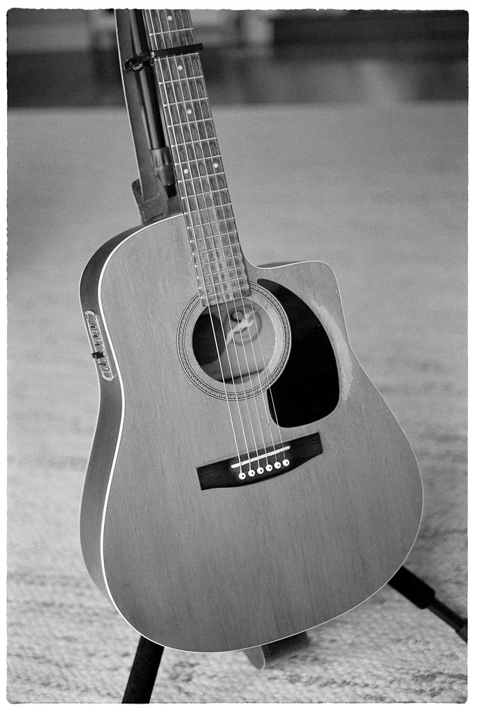

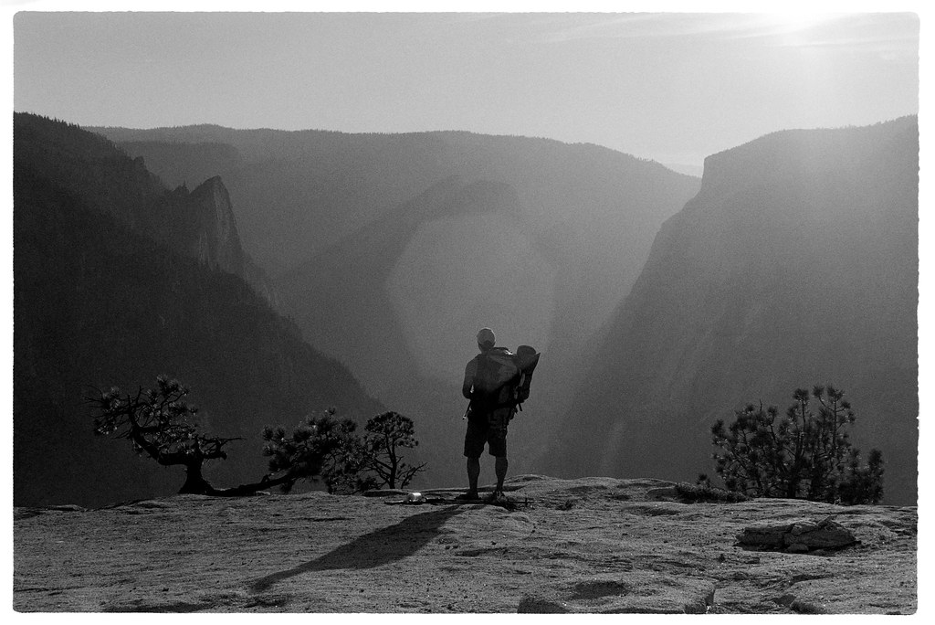

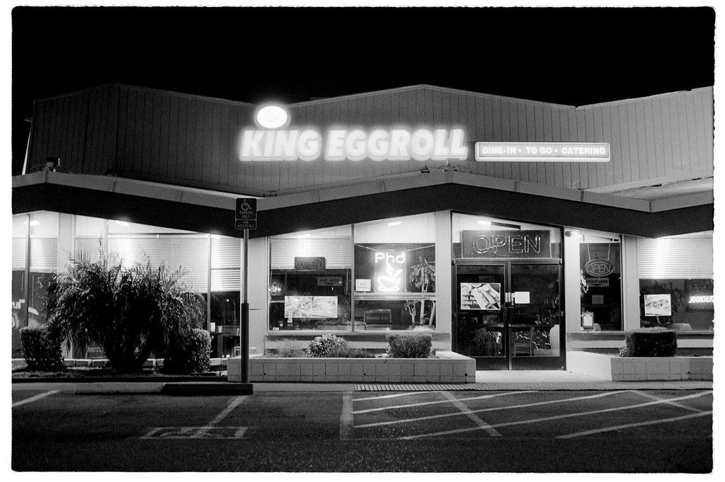

I pretty much agree with Bormental. I don't think the halation is bad at all, but it does show up from time to time. Here's an example, though I wonder how Tri-X or HP5+ would fare under the same conditions:
Here's an example shooting into the sun:

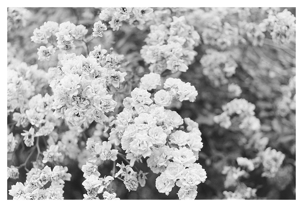

And here are some of those subtle, gentle tones that Bormental mentioned. You can also see some slight halation on the bridge of the guitar:

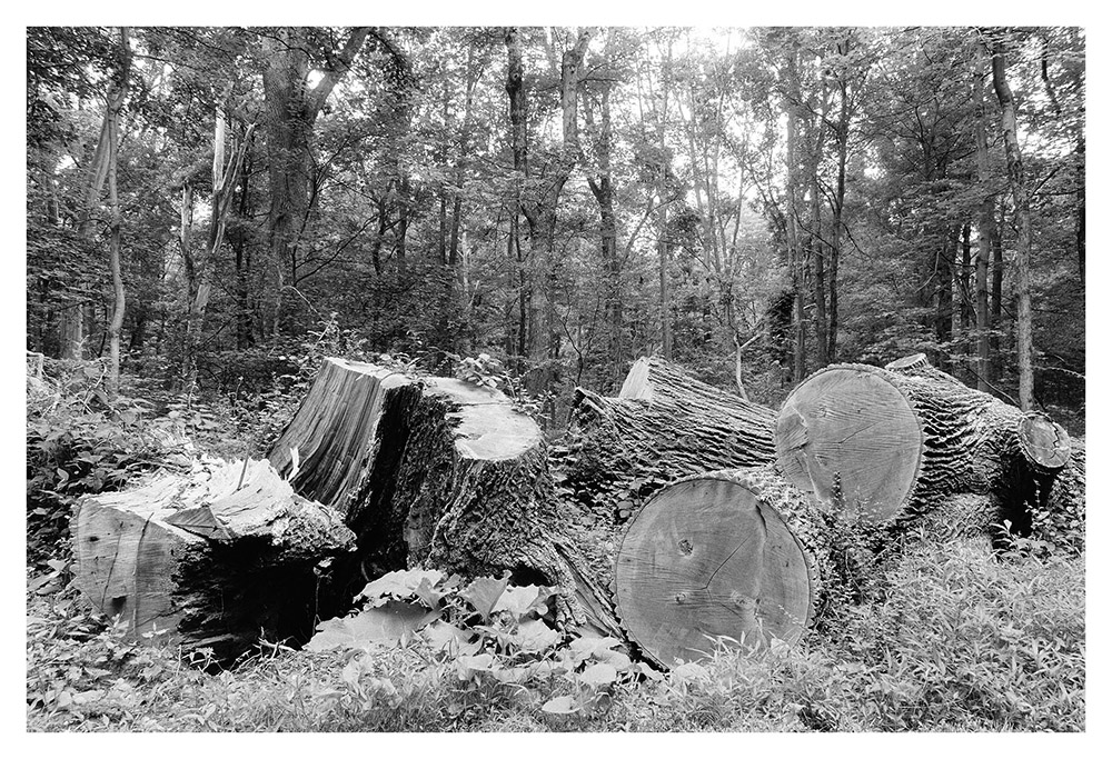

All - many thanks for the helpful suggestions. After 12 rolls of the 400 speed and 3 of the 100 speed UFX, I have results I like.
In particular, I am pleased with my results from UFX100. Regarding the UFX400, I haven't yet figured out the film (despite shooting a dozen rolls)... in the majority of shots I don't like it (my results are too "mushy"), but for some images it just works.

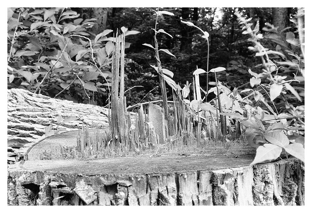

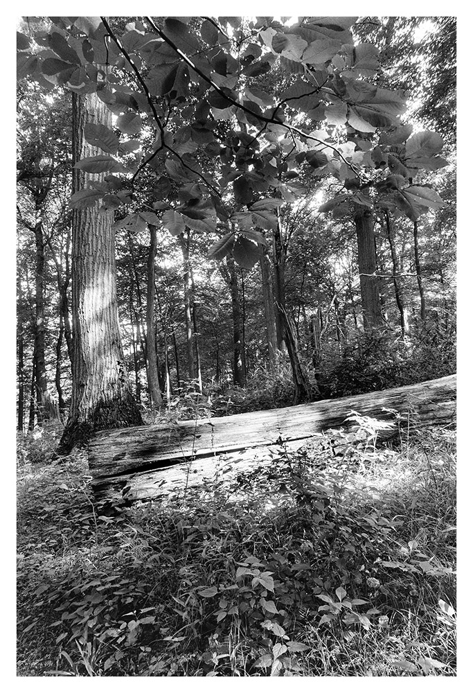

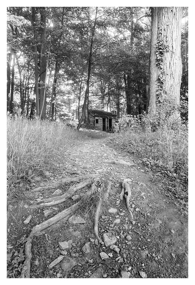

Here are some of my results from the UFX100, in Ilfosol-3:
1. Log hut
2. Chopped
3. Skyline in wood
4. Bright flowers
