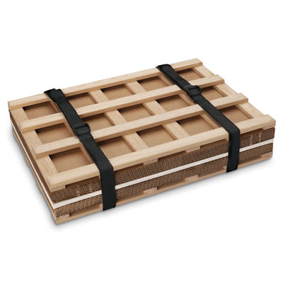

I am having great success in drying fiber papers flat using one of these plant presses.
The fiber papers go in between the blotter papers and the corrugated sheets and I leave them in the press for a week or so. After they come out of the press they are very flat, but over time they regain a slight curl length wise, but I don't have a problem mounting them.

Corrugated Board is correct; just in case somebody is
interested in this superior method of achieving dry and
flat in one move. I used blotter rolls many years ago
when doing up to dozens of prints; Sorority and
Fraternity work.
Now days I use a flat version of the roll. I refer to it as
a Corrugated Board Stack dryer as blotters are not used.
Blotters are an absorbent material. Rather than that I use
separator sheets of non-woven polyester, a non-absorbent
hydorphobic material.
Corrugated Board Blotter Roll and Stack dryers were quite
popular years ago. Besides Kodak and their roll there were
Salthill, Burk & James, and others who made available the
stack type. The Luminos site had a page detailing the
method for really FLAT and, I should add, DRY.
A DIY Corrugated Stack dryer can be extremely inexpensive,
light weight, compact, and have little to great capacity. The
prints dry slowly, gently. Not for the impatient. Dan
