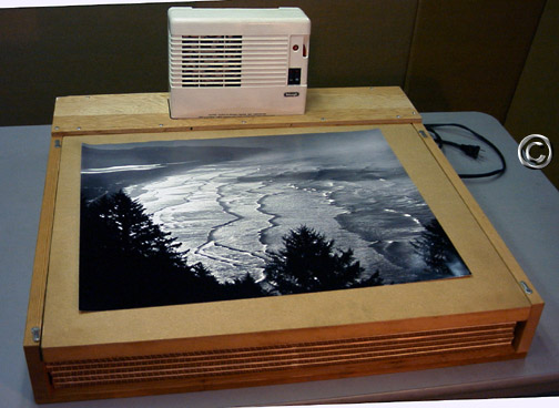

Corrugated fiberboard sources:
Your local appliance dealer has refrigerator and dishwasher size cartons for free. Cut them into any size you want, just make sure that the corrugations run parallel to your airflow so the moisture can be easily blown out of the stack. It's usually a heavier grade of paper, so they'll last a loooong time. Don't worry about water resistant board, you'll remove all standing water off of the print before putting them into your drier anyway.
Ask any dressmaker about interfacing, and they'll use the phrase "Pellon". Read about it here:
http://www.pellonideas.com/content/view/14/30/
For non-woven materials, DuPont's "Tyvek" is very good. Read about it here:
http://en.wikipedia.org/wiki/Tyvek
It's available in thicker 18lb sheets (thicker = better), 25 sheets, 17 x 22", $38.99 here:
Dead Link Removed
Another non-woven olefin product is "Reemay".
Gaylord promotes it as "an interleaving material when drying wet photographs" here:
http://www.gaylordmart.com/adblock.asp?abid=2123&sid=A70968E7878647678611A8DA39F707
Personally. I find acid free blotters work very well in my homemade drier discussed here:
http://www.classicbwphoto.com/Blog/A40AA6E8-A280-11DB-9B69-000A95E8D0C0.html
Conservation grade blotter papers are also from Gaylord here:
http://www.gaylordmart.com/listing.asp?H=3&PCI=128007
If you want to go First Cabin, you can get archival corrugated board from Gaylord here:
http://www.gaylordmart.com/listing.asp?H=3&PCI=128003
That oughta get you started.
Have fun.
Reinhold

I don't squeegee them (too much risk for me) and I suspect that the curling happens in the final stages of drying, so squeegeeing might help shorten the drying time, but I think relative humidity has more to do with the amount of curl, or "frilling" of the edges than anything.
I have tried all of the suggested methods, and for years, blotters, with the corragated separators, which produced the flattest prints, by far, but I got tired of worrying about lint and accumulated contamination, careful as I am.
Screens were ok, but often left a pattern, also need to be cleaned, and had curl.
The back to back hanging is the simplest and works best for me.
I just now did a search on Google for "photo blotters" and found this article - which aligns with most of my experiences - http://www.heylloyd.com/technicl/drying.htm.
In any case, my experience is that no matter how flat they are (even if I flatten with a dry mount press after drying), if I store them in archival boxes, or old paper packets, the relative humidity the day I take them out to mount them is what really matters. Prints that were once perfectly flat might not be the day I take them out to frame them, so - I just hang them as described, and deal with whatever they are on the day I frame them.
FWIW, I have had exactly the same experience and reached the same conclusions.

Reinhold - thanks for your last post. My workflow when using either blotters or screens, many years ago, was to hang them back to back first, until they were nearing the point of beginning to dry (how do I describe that - still moist but not dripping), then put them into the screens or blotters. This is what I would do if going back to blotters. I'll have to think about this. Last night I found that I actually still have an unopened, virgin set of Kodak blotters big enough for 16x20 that I may use.

Dan and Reinhold - thanks for your most helpful responses.
One more question: if you are using a good facing material
(as you describe) do you have to worry about the acid
content of the corrugated material?
By "facing material" you mean the polyester separator
sheets? I can't see that an issue. Pre dried by sponge or
squeegee and placed upon those non-wetting separators
precludes contact with the corrugated board. No more
than water vapor transfers from the prints, through
the boards facing's, and out of the stack. A print
layer with top and bottom separators. Dan
dancqu
Sep 7, 2002
3,649
Willamette V
"I use paper blotters, and Dan uses a synthetic non-woven,
but we both remove all standing water off of the print before
putting them into the drier. I'll let Dan chime in, but I'm totally
confident that acid bleed is not a problem if your prints are truly
free of surface water. The interleaving should not feel wet.
Remember, your prints are in the drier for only a few
hours, at most.
A comment:
I can believe that there is some bleed from print to paper.
The stack is weighted on top and contact is intimate. Perhaps
that is as it should be. Paper separators as with many other
materials used in darkroom work date from ages ago. The
paper in direct contact and under pressure will absorb
moisture and direct it to the two face sheets of the
bottom and top corrugated boards.
I couldn't say how much of the very little chemistry
left in the paper is transferred. Cellulose is hydrophilic
so making it more believable that some transfer occurs.
So much for transfer from paper to separator. The print
is cleaner for the transfer and if there is no reversal of
transfer, as may be the case, then no problem.
There is another matter to be considered in the choice
of separator material and that is permeability. Will the
material allow for the free passage of water vapor? As
I see it the corrugated board's facing sheets present
the greatest barrier. All of the non-woven very
hydrophobic separator materials I've tested
are extremely permeable. Dan
