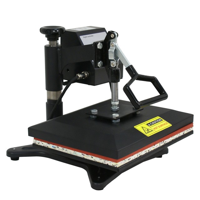

Ok folks. Is a hot laminating press the same thing as a dry mounting press?
TOTALLY different beasts!
A laminating press heats up two plastic sheets, between which one puts something to be 'laminated'; ie waterproof, finger proof etc.
A mounting press is VERY heavy and has a temperature dial, for you to set manually for different uses of drying and flattening FB prints between mounting card and of course, to mount photographs onto mounts.
And then there is the Ebay 't-shirt transfer press' (not sure of actual name), that has been asked about on here a few times. This gives you the heat (but not enough of I think?) but lack of a weighted and hot top to it, so may or may not be usable. You would have to search the forum for these threads to see what comments have been made. :smile:
I presume you are looking for something to mount prints with? BTW I was lucky and got one at a good price on ebay and was, when it arrived, surprised that it was delivered, as it felt like it weighed a ton or so!!!! And the wrapping to stop any damage (mostly to other items I would think) took me about an hour to take off completely, so no I won't be selling it in the near future! :smile:

I saw a laminating press on gumtree and it looked kinda like what I was expecting a mounting press looks like.
Hopefully this will work.
This is a photo mounting press:
And this is a t-shirt mounting press:
Yes, there are some similarities but the photo one will be a lot heavier in build and (probably) has a higher temperature available.

That Seal press illustrated in Terry's post is a photo dry mount press.
This $100.00 eBay listing is a T-Shirt heat press:
