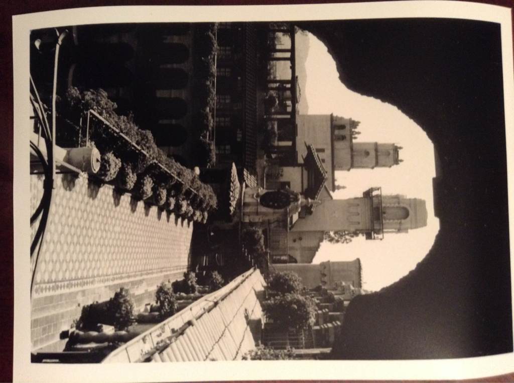

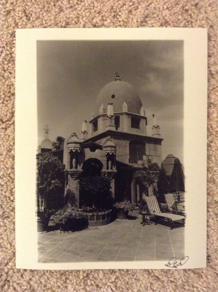

Ok, thanks so much to everybody that posted here. I dig out my enlarger today, and put both filters I had in the drawer. I then exposed at f8 for 16 seconds, developed for 2 minutes, fixed for 2 minutes, then washed for 3 minutes. Not perfect, but miles better than what I had:

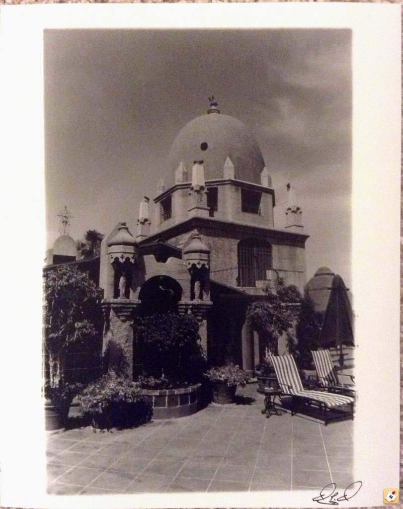

Surprise, it works for 8x10s too! Just double plus 2/10 and you're good to go...

Nice!

WW12345: Your borders are grey. That means either age-fog or light leak in the darkroom. - David Lyga

Actually, those borders are pure white - one more limitation of digital photos - in order to get the blacks "black," the white borders came out grey. :S
I do have some paper that is age fogged, so I am on the lookout for that symptom.
