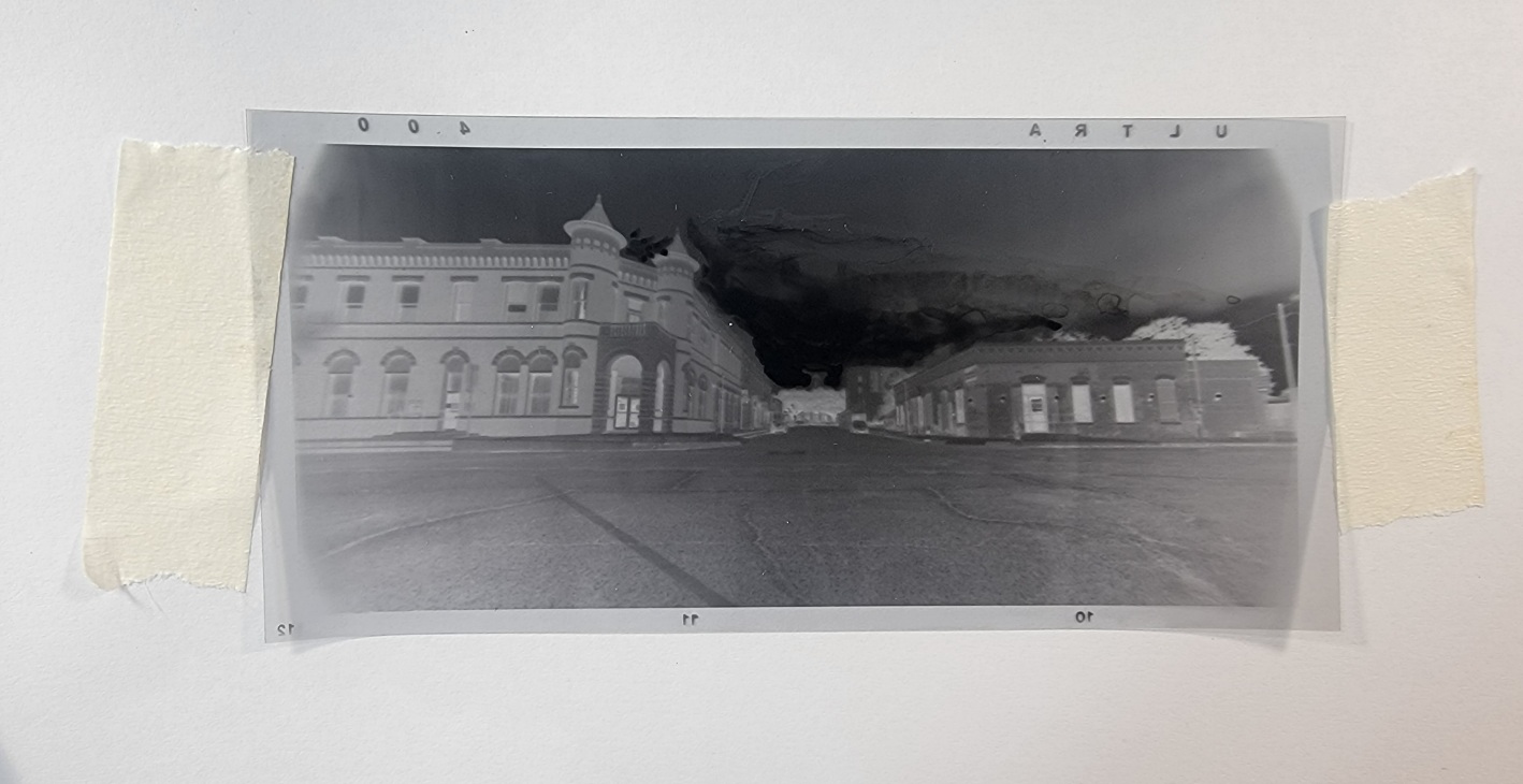

Figured I would try a little experiment today. Speedball ink on the film negative (in the sky( to see how it adds hightlights. Has this been experimented with, Am I re inventing the wheel?

Figured I would try a little experiment today. Speedball ink on the film negative (in the sky( to see how it adds hightlights. Has this been experimented with, Am I re inventing the wheel?View attachment 284392
I wouldn't apply anything directly onto the negative. I've used a piece of frosted mylar from the art store, and a soft pencil... but that acted more of a way to dodge, rather than to increase contrast. Why don't you try adding a wee bit of potassium dichromate to the sensitiser? For starters, mix up a 3% solution of the dichromate (ammonium dichromate could be used, too), and add say a drop to your sensitiser. You'd have to experiment. If too much contrast, then make weaker solution. At any rate, you will most likely have to increase the exposure of the print, depending on how strong the dichromate solution is, or how much is added. I would rather go this route than marking up the negative.
Yup, good ideas! Thank you for the suggestion. Just a sunday experimenting :smile:
looks like a plan! You might also experiment with a sheet of computer paper. Wax 1 side with paraffin and use that to add texture to your retouched area…. Combination printing is as old as photography itself .. :smile:. Have fun thinking outside the box :smile:
