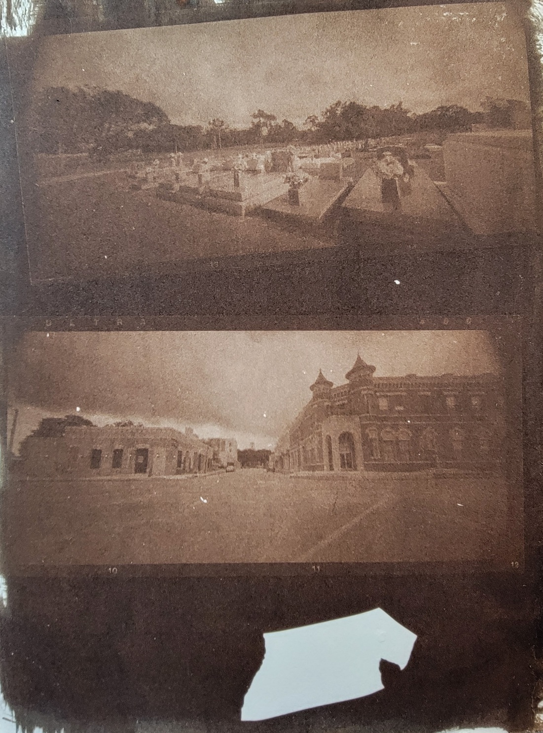

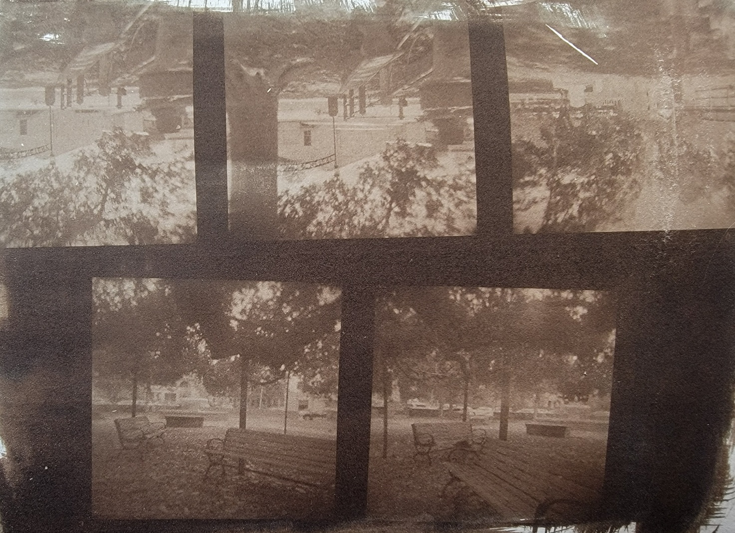

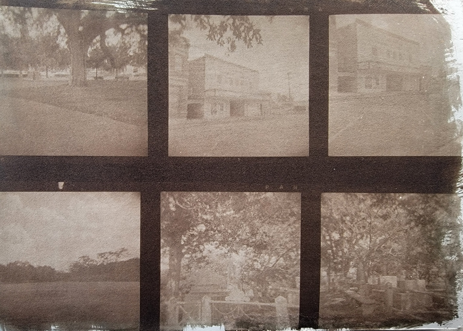

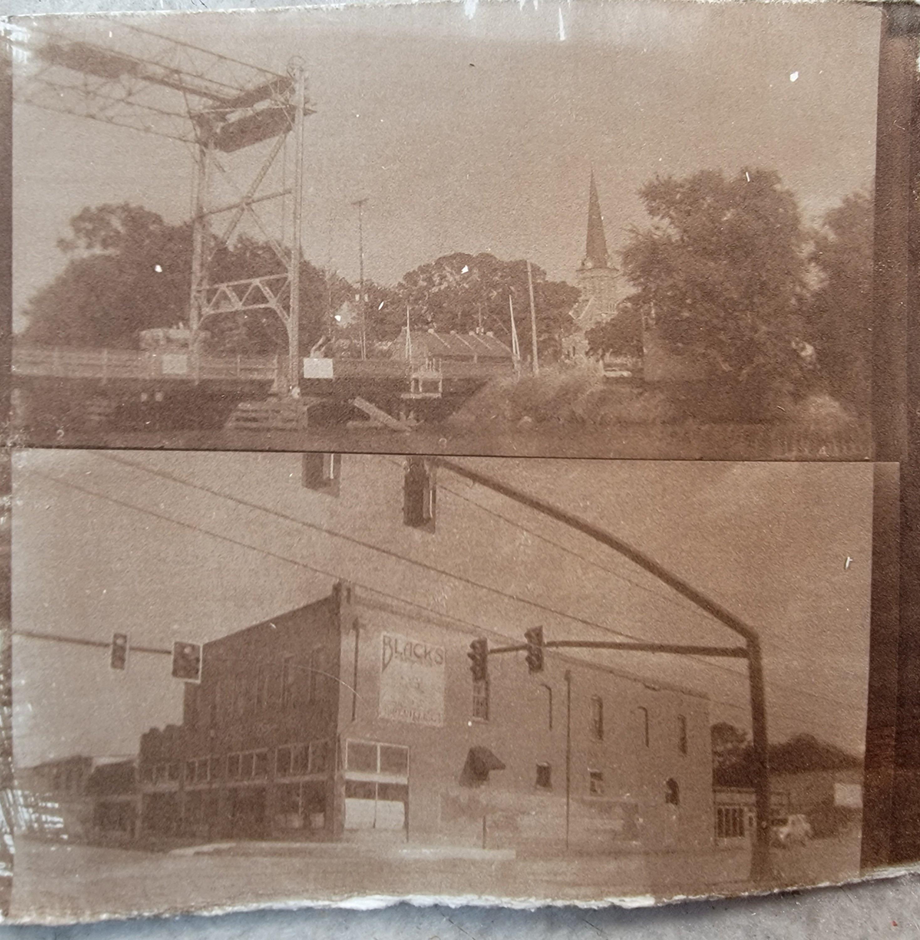

Heres some van dyke experiments i did today, to see if I was having fogging etc. (The completely white area was electrical tape only during sun exposure) Ultimately, it seems the negatives are the issues. (I haphazardly coated the paper just so i could experiment)

FP4 is a very nice film for alt processes that I dabble in...carbon transfer, kallitype, gum, etc. I also use HP5, but to get it to work in alt. I use a high contrast developer such as DK-50, as recommended by Vaughn. It will give you the required DR, without bumping up the base fog. I'm not familiar with Foma films, so I have no idea how it's base fog is affected by extended development times. If I recall, DF96 is a monobath developer... I personally would not use a monobath if alt printing is intended. This could be the problem that you are facing. Try a conventional developer like D-76, or even Xtol.

It looks like your negatives are too flat for Van Dykes. Scrap the monobath, and try a conventional developer. I do use Pyrocat-HD, but probably a non-staining developer will be all you need. Good luck!

Personally, I don't think these look too far off. I understand the contrast issue you are getting at, but some of them seem close.
A couple of other questions that might help us:
  • What paper are you using? Not all papers are great at clearing.
  • Any sense as to whether your water is naturally acidic or alkaline? I have heard/read about clearing problems when washing in alkaline tap water. My understanding is that a few tbsp of citric acid to your rinse water should alleviate this issue.
I don't know enough about VDB to know if you can use a drop of something like ammonium dichromate (I hope that is correct) to increase contrast.
