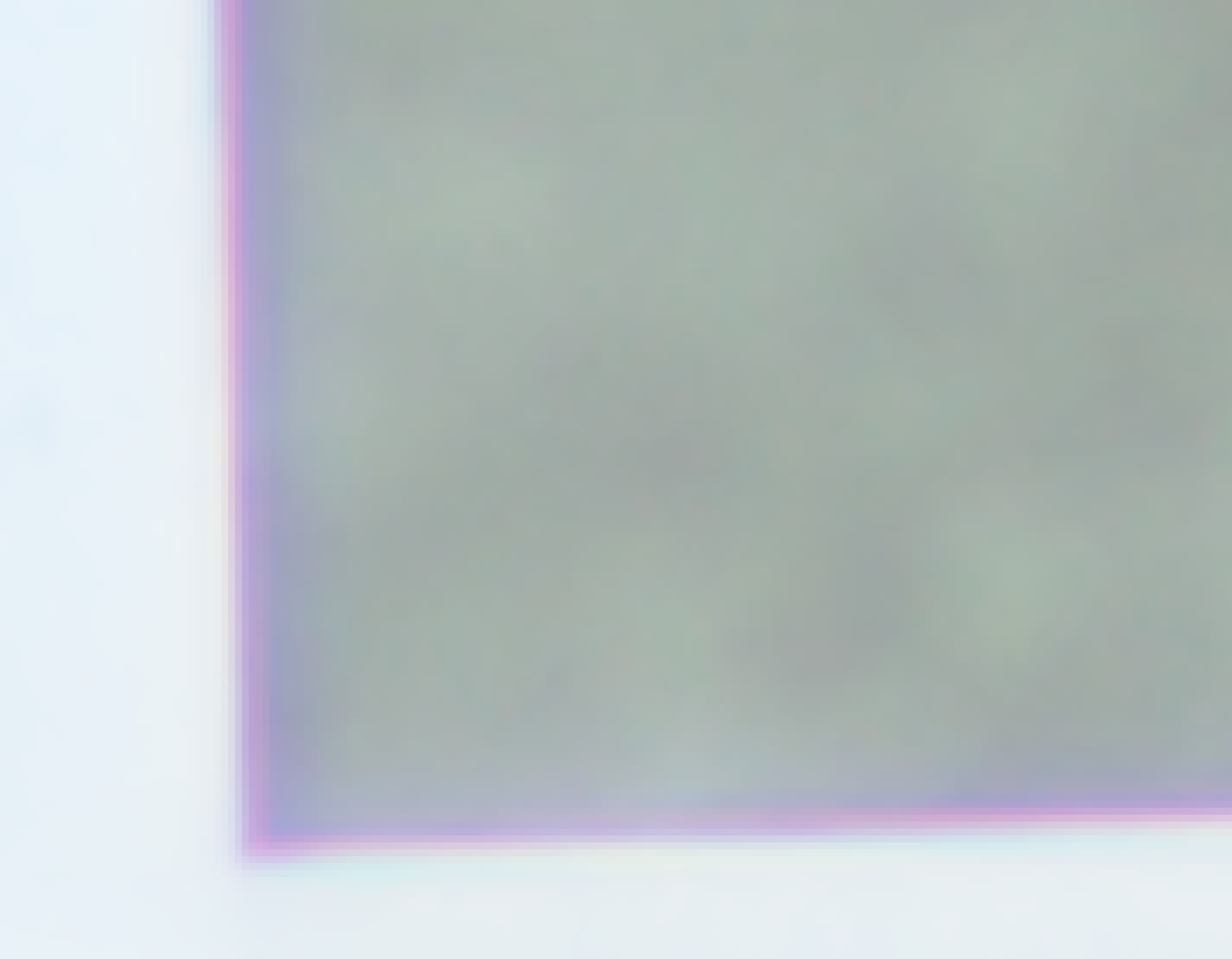

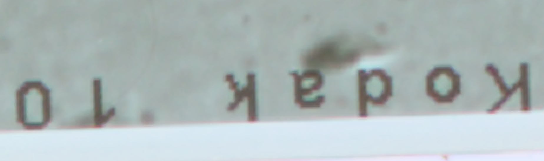

add on: anything I do in color ends up with this sort of rainbowy effect on the edge of things? I've noticed my sensor does seem to have very high amounts of noise, more than other folks have reported with a 5D, maybe it has something wrong with it? or is this the fault of using an oled tablet as a light panel? (I have a diffuser between the film and panel)
Even when attempting to focus on the lettering on the edge of the film, I still encounter the same sort of jumbled up mess
looking closely, it's almost making me consider the possibility that the camera might be unable to capture at a high enough resolution? If this might be the case, my next move will be attempting to find a nearby library with a half decent flatbed scanner.
Just offering a thought about the lighting. An OLED, or indeed any three colour luminous display, is only outputting a limited set of red, green and blue frequencies of light,
Natural light and various other types of artificial light have a much wider range of frequencies.
If the RGB frequencies from the tablet doesn't line up with the RGB frequencies of the sensor sites on the camera, then I imagine you could get some odd colour effects.
Prints can have an effect where they look different under natural light, than under limited frequency artificial lights. Called metamerism. Because some of the pigments fall into band gaps not present in the artificial lights. Perhaps there's something similar here?
Of course, I may be entirely wrong. :smile:
But I wanted to offer it as a thought.
