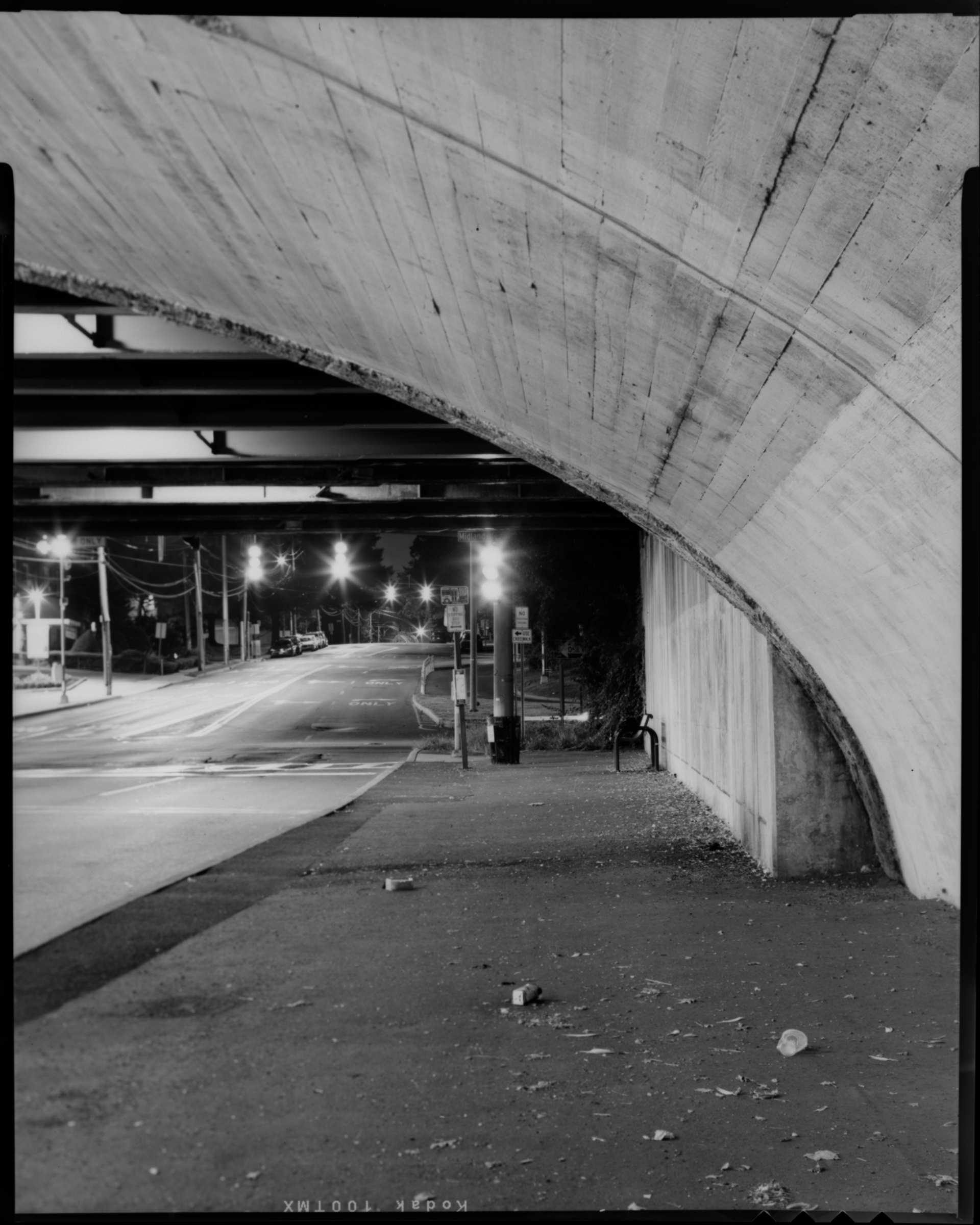

I've been experimenting with DSLR scanning my 35, and recently my 4x5 stuff as well, I'd really prefer to make analog prints and flatbed scan those for a digital copy, as i've done in the past, but I don't have access to a darkroom right now. I purchased an Essential Film Holder on recommendation from someone on here, and overall it does its job fairly well. My problem comes with trying to get a solid focus on the grain of my images.
I've tried a number of equipment combinations in search of a lens/camera setup that can get a solid focus on grain. So far, I've gotten a grand total of nothing.
My best attempts, working on 4x5 film, have been:
Canon 5D Mk III with an EF85 f/1.8 (shot at 100 ISO at f/8, tried to focus at f/1.8 and then stop down from there)
Canon 5D Mk III with a crap old 70-300 Sigma macro, at all sorts of settings, but there's a ton of noise and color crap (chromatic aberrations? I ain't sure)
Canon 5D Mk III with Nikkor F/1.8 50mm (one of the older ones with manual aperture)
Nikon Z50 With Nikkor Z DX 16-50 (A lens that don't deserve the title of Nikkor, it's a crappy kit lens, and it ain't a prime or a macro, but I was getting desperate, it's my partner's camera anyways)
Nikon Z50 With Nikkor Z DX 50-250 (again, not a prime, but I've been told APS sensors are easier to focus with?)
my only conclusion is that I must be doing something wrong? I guess my use of low grain film isn't helping here but?
Attached is an example of a scan (downsized a lot, apparently the 2mb upload limit is a lie?), alongside a zoomed in screencap of the same image.

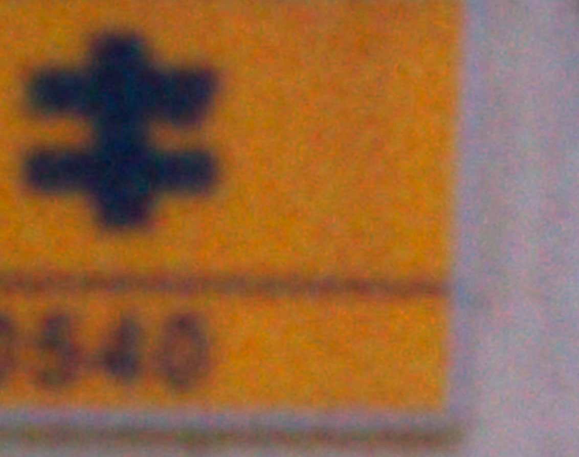

add on: anything I do in color ends up with this sort of rainbowy effect on the edge of things? I've noticed my sensor does seem to have very high amounts of noise, more than other folks have reported with a 5D, maybe it has something wrong with it? or is this the fault of using an oled tablet as a light panel? (I have a diffuser between the film and panel)
Something like the edge of the film, or even the edge print on this sheet.
Even when attempting to focus on the lettering on the edge of the film, I still encounter the same sort of jumbled up mess
looking closely, it's almost making me consider the possibility that the camera might be unable to capture at a high enough resolution? If this might be the case, my next move will be attempting to find a nearby library with a half decent flatbed scanner.

rainbowy effect
Diffraction around small features; is this the corner of the sheet you're showing? Diffraction is wavelength-dependent, and thus, it'll be colored. Lens aberrations can play a role, too. They tend to be colored for similar reasons; the angle at which light rays 'break' is dependent on their wavelength = color.
Well, yeah, but it's not really the camera's fault in terms of something to do with the sensor etc. You're running into a combination of factors: very shallow depth of field making it very difficult to accurately focus, and myriad optical effects (lens imperfections, fundamental physics/behavior of light around/through film etc., flare) are affecting the effective resolution of the entire imaging chain.

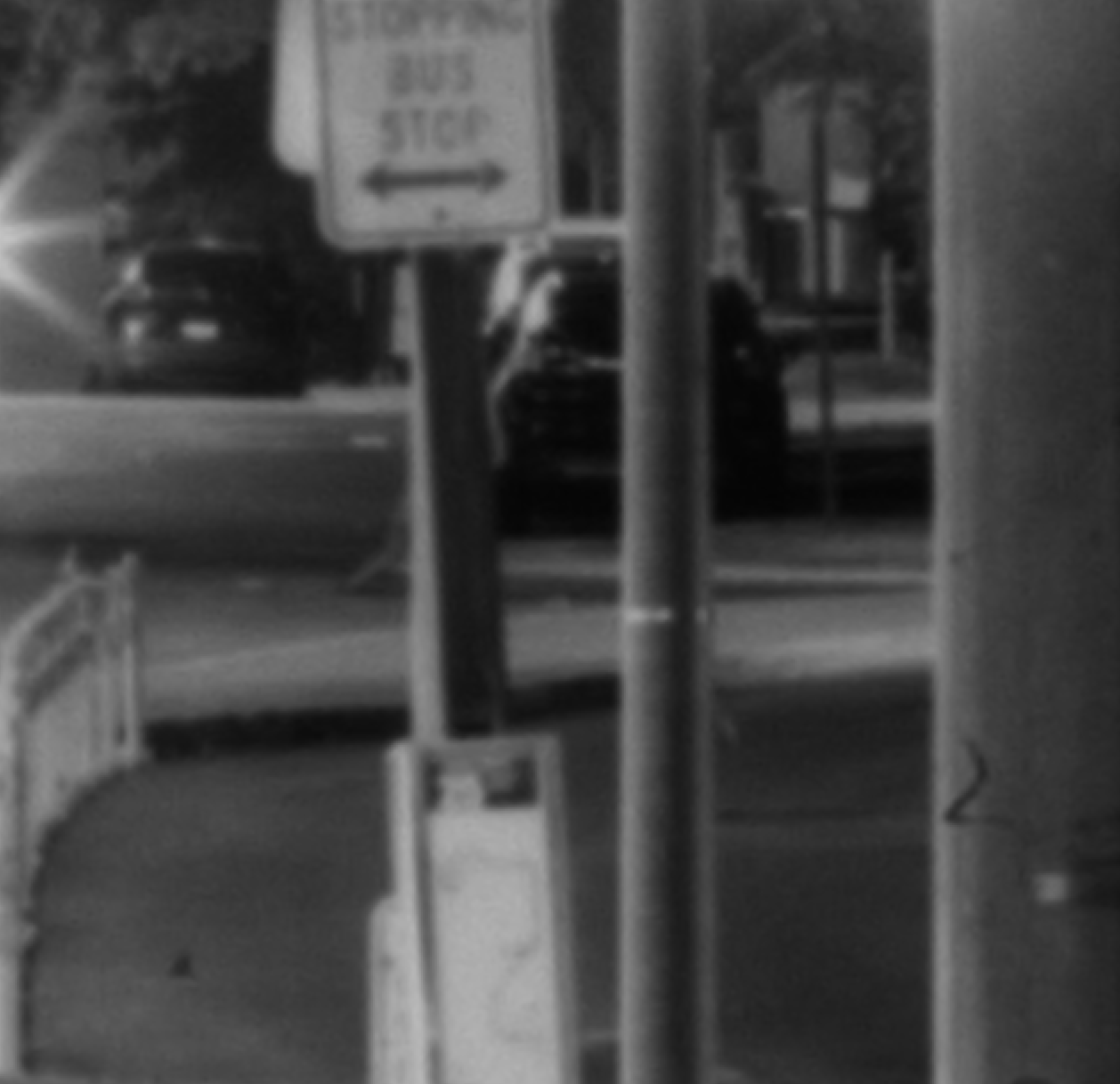

@f/Alex , are you scanning 4x5 on a 20MP cameras without stitching?
If so, forget about resolving grain. You are getting about 1000dpi (at best!, it's probably half that in reality), there is no way you will see grain in such scans.
You will need to scan at 1:1 or even past that and then stitch to see grain. And at that point you will probably hit the limitations of your non-macro lenses.

i may seem stupid here but what is stitching and how is that acomplished? (24mp, not 20, but the same issue seems to occur with 35mm)
24MP vs 20MP doesn't really make a difference in 4x5", but if you don't start to see image "texture" (there is still some way to resolving grain) on 35mm at 1:1 then there might be some other issue at play. Btw, if you are not using macro rings, how do you get to 1:1 macro with the lenses you specified in you opening post?

that rainbow "noise" effect is still present, in a way that it I don't think it should be at 100 or 200 iso. This is a fairly high grain film. A roll of harmon pheonix that my partner took to japan with her.
my attempts to use extension tubes have resulted in little improvement and multiple other issues. With the 4x5 stuff I still can't resolve the grain at all, theres too much sensor amplification noise.
View attachment 374963 View attachment 374964
