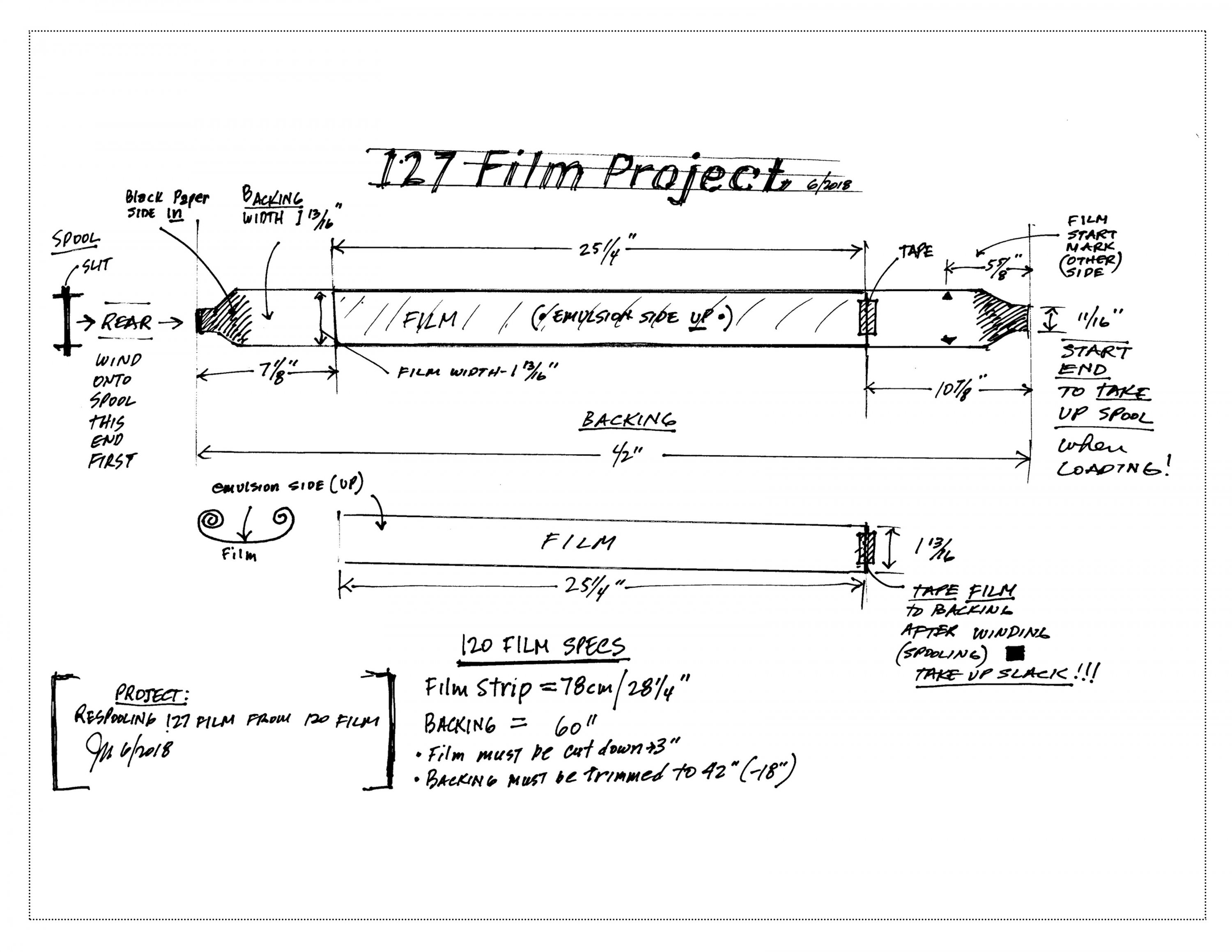

I slit 120 film along with the 120 backing paper as I don't have the facility to add the film to 127 backing paper. Once it's slit the numbers will start at 16 and count down, I would start at 14 to be safe. If it's re-wound after slitting it will start at 1 and only give you 8 numbers, but you can use the largest dot in between them as a number, but again I would start at 2.

When I've cut 120 to 127 I've reused the paper. Works great for a 4x4, you get 16 frames with the red window, and extra space between (because the 120 half frame is wider than 4 cm). Never tried it in a camera with a counter -- my Yashica is the "simple" model, limited shutter speeds and red window only.
Rewinding the film after cutting shouldn't make any difference; the 6x4.5 framing track winds up along the center of the cut roll, so you'll get 16 to 1 if you run it backward, or 1 to 16 otherwise. The auto advance will most likely freewheel after 12. If this is (as suggested above) a length-counter (friction roller operated) you should be able to reset the counter at any point and have it continue -- shooting 1 to 6, and resetting after advancing to 7, should get you 18 on recut 120 (works this way for 828, same frame width, if you have a camera that uses a friction roller to stop advance).
