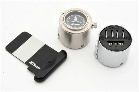

IIRC, there were some data backs for film cameras that would allow you to put sequential numbers on to the film.
So you might be able to design something that would synch those numbers with a separate geotag.
Correct. The Nikon F2 Data came with several erasable data inserts upon which you could write lots of information -- if your handwriting is small enough. Then the photographer could push the insert into the Nikon "MF-10" data back and all the writing on it would be shrunk and optically imprinted inside a small rectangular area within the frame.
https://cameraquest.com/nf2data.htm
