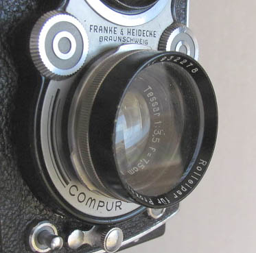

Here's my 1938 Rolleiflex with the Rolleipar(keil) with 28,5 mm push-on mount sitting securely on the Tessar:

Uwe, on my picture the Rolleipar(keil) is upside down with the double arrows on the bottom, and it sits secure. The black part of the Rolleipar(keil) can be rotated.
But push-on filters and hoods can be tricky, they can sit too loose or too snugly and you need to adjust the small metal tabs in the mount. That's why Franke & Heidecke started with bayonets on the lenses - so filters and accessories would sit secure. But I don't understand why a push-on accessory would be more secure if it had a bayonet-push-on adapter. Then the accessory would sit just as loose or snuggly on the adapter instead, not making it more secure.
From 1939, the year after the book was published, Franke & Heidecke started making the Rolleiparkeil with a bayonet mount.
