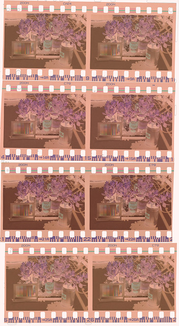

I did. Soft of. It was part of my troubleshooting the streaking on some large format C-41 film that I was getting. I thought that maybe streaking was caused by sudden, but not uniform introduction of developer and then sudden, but not uniform introduction of bleach after developer. I tested various tweaks to the standard C-41 process. Pre-soak > then standard C-41, pre-soak > dev > wash > then standard, pre-soak > dev > stop > wash > standard, developed at lower temperatures... I can't find all the negatives anymore to show here, but I found no difference in negatives that were first pre-soaked (about 5 min) and then developed following standard C-41 or pre-soaked > developed > stopped > washed and the bleached and fixed.
I found a difference if I pre-soaked and used water as stop (increase in Dmax with no significant colour shift which is a result of water being a poor stop), significant difference when processed at 32ºC and of course even bigger difference at 30ºC.
Top to bottom:
1. 30deg, 8:00
2. 38deg, 3:15 (standard C-41 (no prewash, dev., bleach, wash, fix))
3. 38deg, 3:15, prewash, wash before bleach
4. 32deg, 6:30, prewash
From memory, I would say that if I had to "imagine" (I didn't have a densitometer at the time) a difference when using prewash it would actually be a very very very slight increase in Dmax, so the opposite to what you assume should happen. But that is totally irrelevant and could be down to variation in my processing. I wish I could find the negatives that didn't display any observable difference so I could examine them with densitometer. But my take on pre-soak is that it has no meaningful effect on densities of the negatives. Temperature on the other hand has a big impact, so prewash is no brainer if it helps you with the temperatures and only a waste of time in worst case.
