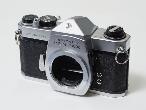

I've started to focus more on posting repairs to iFixit when I decided youtube was too much work. They have a great infrastructure for it. And you can even download PDF's of the guides! Here's my page for the Pentax Spotmatic as an example.
