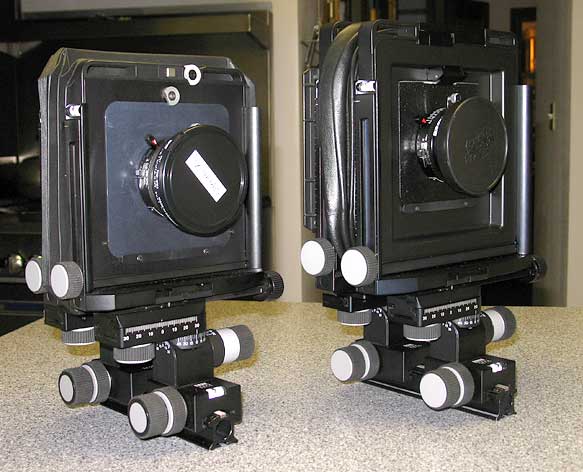

eclarke said:
I have 5 of them, The old 8x10, a new 5x7, 2 4x5-141mm and 171mm and a 6x9..Evan
Here is a quick snap of the 141mm and 171mm Arca 4x5..Evan
