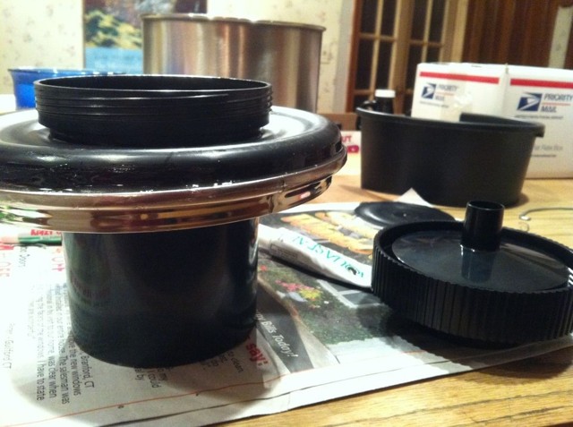

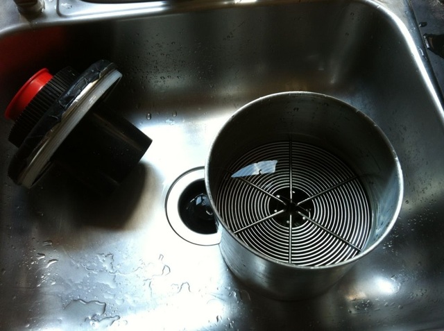

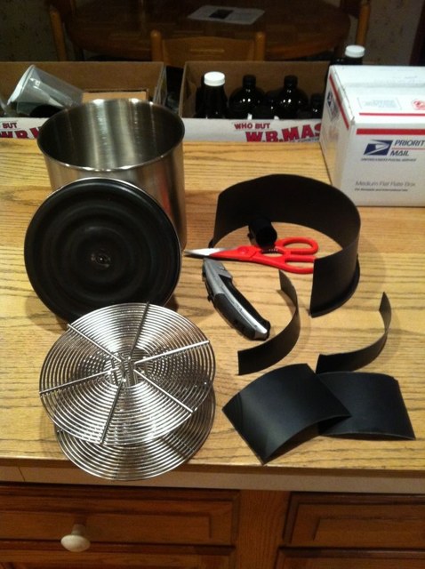

In case anyone wanted to see my mod for my daylight 70mm tank...
It has some light leak issues I'm working out. Still hoping an actual daylight tank appears that I can buy off someone, if they even exist...

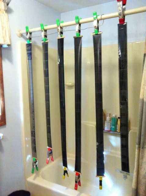

Yea, pretty sure I metered wrong, or I Maybe should be shooting at EI 100... The date stamp of expiring nearly 30 years ago would put my stop correction (1 stop every 10 years right?) at almost ASA25... I think that's a bit much.... But my tri-x arial was MUCH worse, putting it from 400 to EI 25 based on tests and expired in the 80's... Crazy... Tri-x can't handle time...

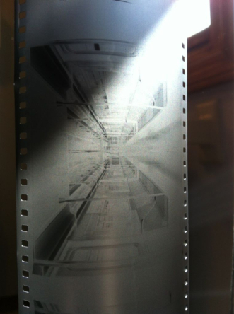

BTW, your hanging film shows no perfs, but the closeup sample has perfs. Whats up?
PE
I think I need to pay for the privilege of viewing your photo gallery, as I "don't have permission to view this" :sad:
You have to look closer, zoom in on the closest strip, the perfs are there I promise :smile:

I'm on my iPhone, the original image is now only on my computer and iPad so I tried to crop, can you see?

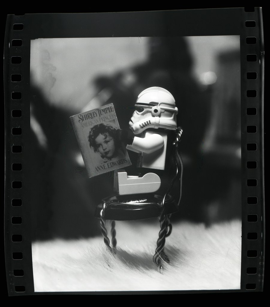

So now that time has passed, how to I get a scanner holder that will fit 70mm haha, I have the epson v750-m pro
Flat on the glass doesn't work as its out of focus slightly and gives a soft focus look...
If I raise it up on glass (wet scan glass specifically) I get newton rings and can't get it flat...
This image was a joke and a challenge by a friend photographer who wanted me to shoot a macro shot without a macro lens and use expired film so the 1967 GAF 70mm was the natural choice :smile:
