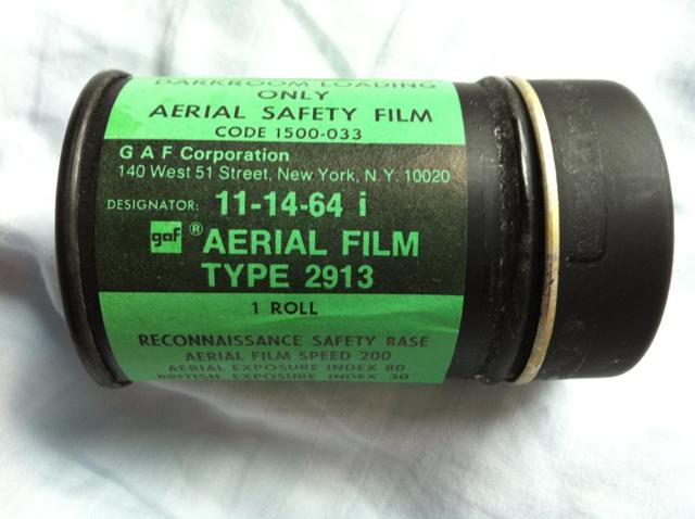

So I have a bunch of rolls if GAF Corporation arial film, I could find NO data on this film and only a bit about the company itself. (At the time I wasn't on APUG) so I did some experimenting using ilfsol 3 (1+9) and seemed to get a good exposure, but I just shot a bunch of hurricane images and I kind of want to know if there is any official data, what developer was originally used and if it's still around, times etc.
I've been shooting it actually at the 200 ASA mark, I know this doesn't make sense but at the time I was experimenting with the development and didn't realize arial film had different EI for ground shooting and I'm probably pushing the film and not realizing it.

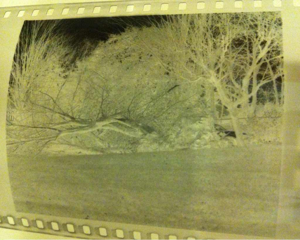

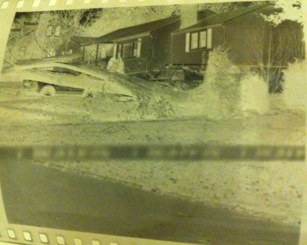

Thanks PE, however I've already developed a few rolls of it, and what's the point of keeping film you will never use? I'll keep the canister and box?
It's not at ALL fogged, I was shocked the first roll, it's in better shape than my 100' roll of tri-x aero film which was badly fogged, but this stuff, nothing, and the fact that I'm shooting it at its listed ASA and getting good stuff is amazing, it comes out just like the pan f plus I shot side by side for comparison.
However I haven't had any of it scanned yet, so I don't know the grain (well I a section of it scanned with my 35mm scanner, but a whole image, not yet).
It's drying right now... See?
Hope you can see them. But I'm totally winging it here with times etc, would be nice to know the correct ones.
That link above that the other guy gave to eBay, you can see the scanned image.
I want to buy another 10 rolls from the guy (hope this post doesn't get me to lose all of them) lol

I am very surprised and happy for you that the film is not fogged. It must have been exceptionally good for keeping and it must have been stored very well. Looks like you have the exposure and process times locked in.

Well if you think it's correct, that's good enough for me!

Alright, I have checked the USAF Handbook for Photo Lab Processing (AFM-96-11. In it, it lists films used by the Air Force for all purposes and for aerial use only Kodak and Dupont are listed. GAF is listed for small camera and sheet films. No joy here! Sorry.
Also, it gives the standard developers to be used. All films must fit a narrow gate for time and temperature in these developers.
All must be able to use darkroom or field equipment.

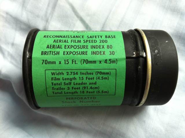

Thanks for looking. What I found most annoying and strange is they come in canisters of 15 feet each like standard Kodak 70mm except NOT in load able canisters, but just on spools, and the spools do NOT fit in 70mm canisters so I STILL have to re-spool them as if they were on 100 feet spools, why didn't they at least fit inside standard canisters... Ugh, I'm sure they are some proprietary GAF product but still silly, at least the bigger spools prevented heavy curling...
No Doubt if you hapen to have a USAF Arial Camera they probaly drop right into the magazine...

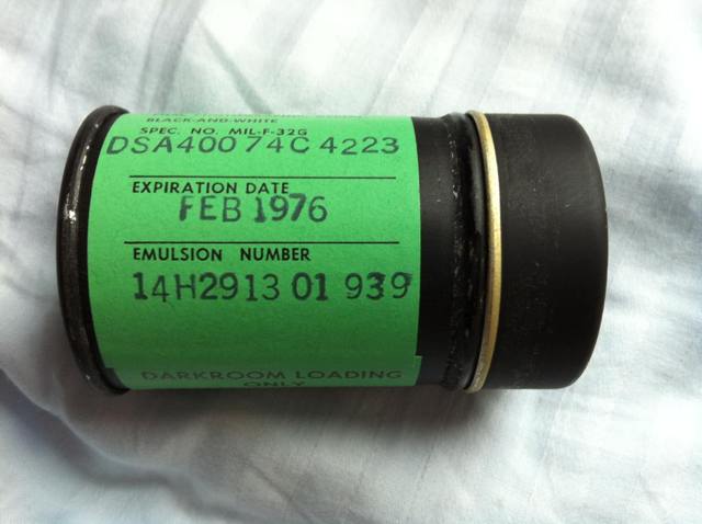

Gaf got out of the Photographic buisiness in the mid seventies. They droped products, as I recall our High School Camera club got a closeout deal on a case of Gallon Cans of GAF Acid FIxer, while some of the members were using bulk rolls of GAF film from Freestyle.. I worked at a camera counter after high School, and I recall GAF Colour 110 Film came out with C-22 Process, while every other 110 Film was C-41. They dissappered completly shortly after that.
A web search for the NSN (AKa NATO Number) on the can gives the news that it is no older than 1963
FILM,PHOTOGRAPHIC
(NSN 6750005774637)
FSG (Federal Supply Group): 67 (Photographic Equipment)
FSC (Federal Supply Code): 6750 (Photographic Supplies)
Date NSN Established: 1963001 (January 01, 1963)
AKGP FILM TYPE AERIAL
MATL MATERIAL PLASTIC, CELLULOSE ACETATE
AKGS EMULSION TYPE BLACK AND WHITE
AKGT REPRODUCTION TYPE NEGATIVE
AKGW EMULSION SENSITIVITY PANCHROMATIC EXTE

Well, from the scant information, the GAF film may not be for USAF use. That is a guesstimate for now.
Our cannisters and rolls fit our cameras as easily as any other camera. I have some 5" and 9" rolls here AAMOF and they look just like film rolls.
