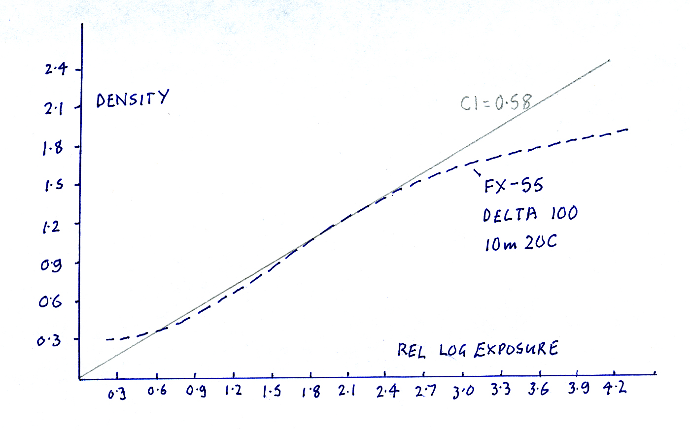

[They are different: I don't like XTol very much because of the grayish (lifeless) mid-tones it delivers, at least to my eyes. FX-55 gives me better satisfaction on this point.
My thought was that by diluting Xtol and thereby lowering the sulfite concentration it might be possible to get better gradation.
I agree. At the sulfite concentration of the working solution FX-55 looks more like an acutance developer.
Alan thanks for postings these curves. Actual data is better than speculation.
