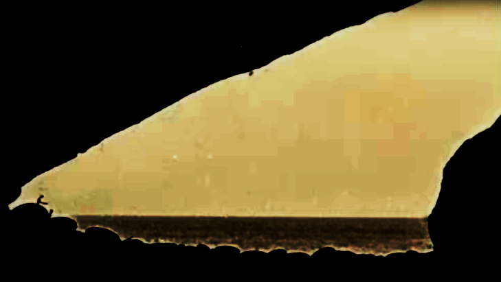

My results with FP4 cine film at EI =100 seem to be as described above, no noticeable adjacency effects round edges, a bit harsh on enlargement.
btw 25 years after the Crawley quotes above, BJP 1986 p100 says under the listing for FX-1, speed increase 1/2 to1 stop and there is no mention of dividing films into groups.

Thanks Alan. Is that the cheap FP4 cine film that the likes of Secondhand Darkroom Supplies was selling recently? If so then your pictures from the tree shot to the Wells next The Sea one are clearly from 35mm negs and FX1 developer so is there any way to translate your scans above into an equivalent size or range as darkroom prints?
They look good to me and while afficionados might have a problem with shadows or contrast I suspect that most people's desire when they think of b&w prints are just such pictures .

Yes it is the film you mention.
When I used to make 16x12 in silver gelatin prints using FX-1 I got a similar result to what you see here and started a thread on how to get more visible sharp edges:
If you want to see some edge effects I suggest try the recommendation of Sandy King to use diluted FX-1 and semi-stand. In my pic above there is a slight white line between the black roofs and the sky at full magnification.

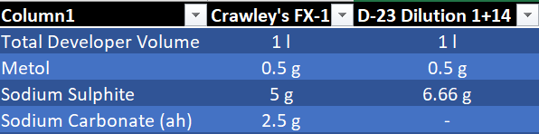

Nice results @Alan Johnson! Is this FX-1 without Iodide?
@chuckroast: D-23 dilution 1+14 is quite close to FX-1 (without Iodide) but doesn't have Carbonate.
So if we add 2.5 g Sodium Carbonate (ah) to 1 l of D-23 dilution 1+14, we get something very similar to FX-1. This is definitely weaker in activity than D-23 dilution 1+9 + 0.5 g Sodium Hydroxide that you're familiar with, but similar in spirit.
Hmmm, I will have to try this. My 1+9 w/lye was all done with extended minimal agitation. I would expect this to require the same.
