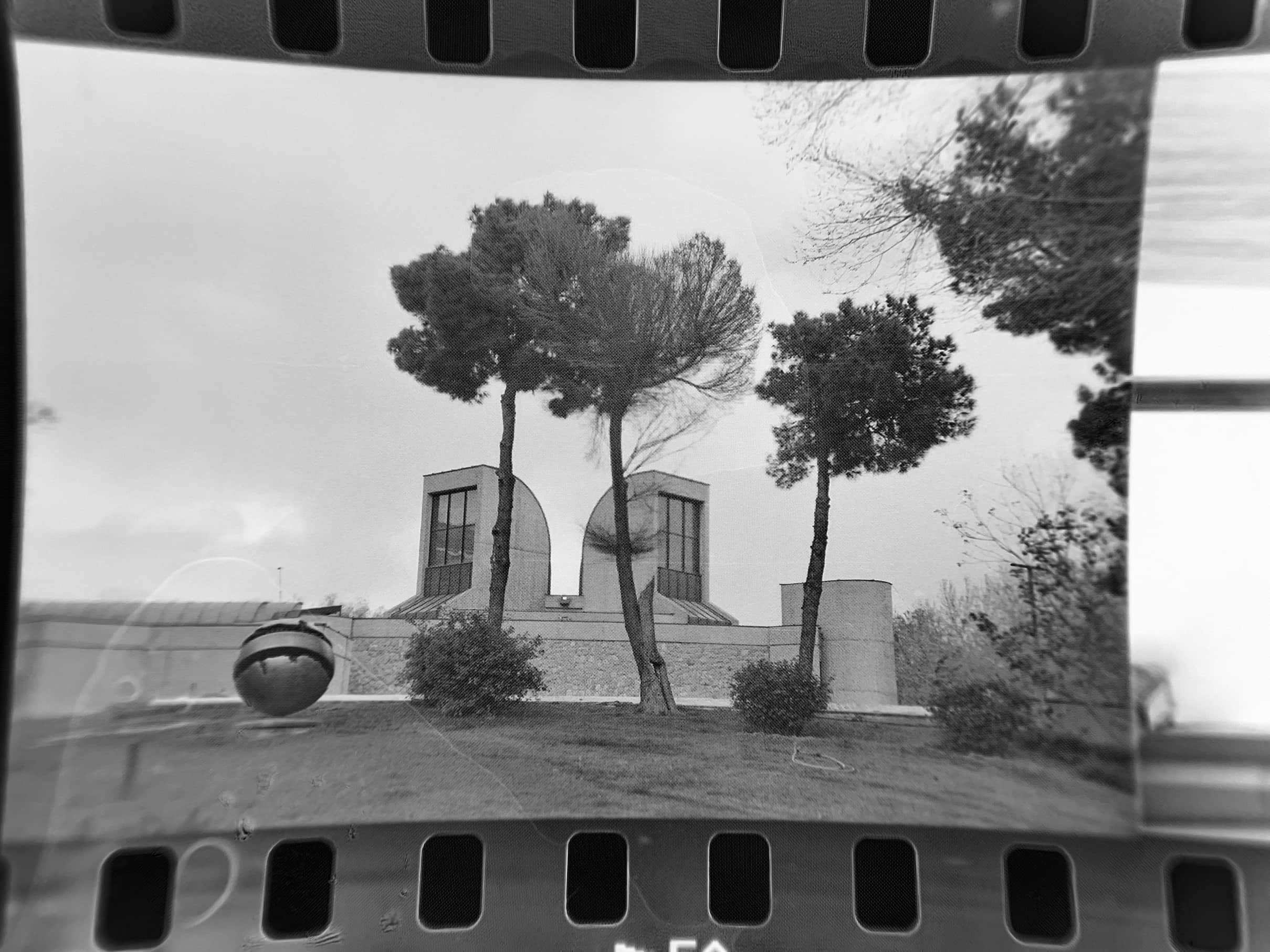

Hey everyone!
The other day I mixed up some FX 1 for my Kentmere Pan 400 since I heard its acutance is really good for traditional film and I developed it for 11 minutes. I came out pretty good but judging by my bare eyes I couldn’t see that special edge-effect that I wanted to see from this developer but I should say that I haven’t had the chance to scan it thoroughly. I was wondering if this developer stands up to the promises of this so-called highest acutance and is it even a good developer for Kentmere films? I also know that it works ideally with slow to medium speed films so does that mean it‘d work better on Kentmere Pan 100? And finally is it really that sensitive to agitation(less agitation=more acutance)?
I should also mention that I‘m not looking for recommendations on other developers and films because I’m really concerned about FX-1(and ultimately FX-2) on Kentmere films.
Here are a couple of less-than-review-quality scans from the developed Pan 400(ignore the water marks these are from an undried negative strip.

Decrease the amount of time between agitation cycles. Back in the 90's, with HP5, I was doing constant for the first minute, then 10sec every 3 minutes. HP5 is noticeably grainier, and so was acutance.

If I look at your test pics: I think I do see strong Mackie lines in transitions to dark, e.g. the leaves in that plant at the window, and the tree trunks in the other pic seem to have them. I do not see such lines in transitions from bright to very bright (e.g. the building behind those trees), so FX-1 may have the largest effect in weakly exposed areas.
Thank you so much! I did actually suspect that I‘ve probably agitated a bit too much(every minute, 5 inversions). As you see it was probably way more than it should be. I’ll be testing your agitation method, thanks.
Maybe that's a good thing.
High acutance due to edge effects is ideally a fairly subtle thing and will be hard to see with the naked eye on 35mm film. If it's easy to see, count on the end result after enlarging the negatives being far too oppressive to be of use. Here's an example: https://tinker.koraks.nl/photography/to-a-crisp-an-extreme-example-of-edge-effects/
Certainly not the highest possible - by a stretch. See examples in link above for something far more pronounced. Far beyond what's usable, in fact - even for contact printing!
You may be right, but it's just as possible we're just looking at sharpening applied by the phone (?) that took the lowish-res photos of these negatives. All bets are off as far as I'm concerned; I'd wait for proper scans or enlargements.

You're probably right since it's actually just an iPhone 13 mini with a macro clip lens on it so I wouldn't count on it to show the exact results as of a decent scan. My scans will be ready by Monday and I'll see if it's OK. But I'm actually looking for the effects on the link you shared since I'm doing a fine-art architectural project on 35mm and 120 so I'd probably opt for less agitation to bring out that crisp quality you pointed out in your pictures.
