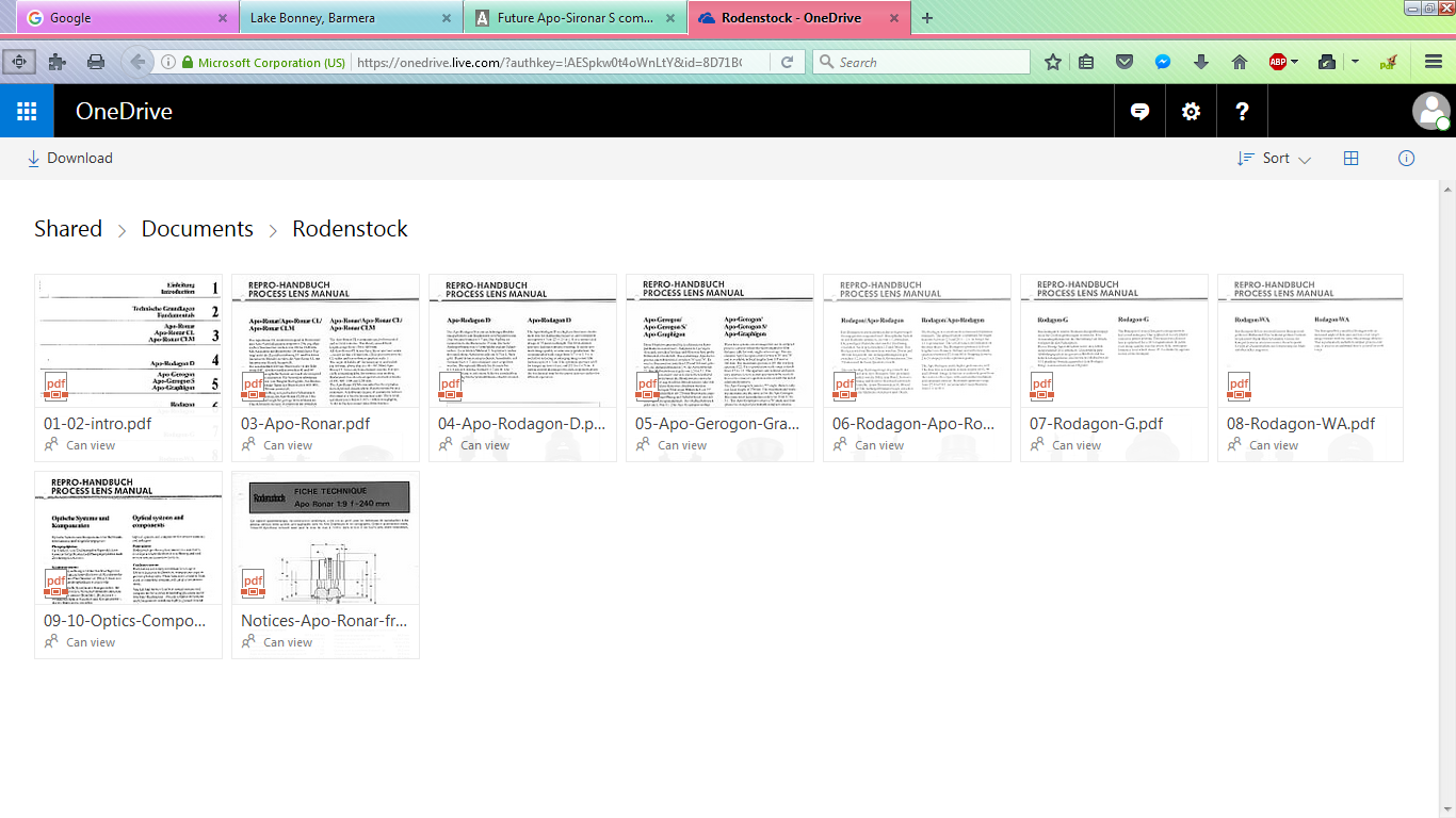

About the link. I tried it, it works. But try this one too. https://1drv.ms/w/s!AggQfcczvHGNh20tYC0PTw-0u69C

Poisson Du Jour
Jul 1, 2008
5,459
Digital
"Blank page"??
There are 9 pdf documents in that cloud...

Dammit, I gave you a simple link and the screen shot in post #14 shows where it will take you. Other people have used it successfully. Apparently using a simple link to a set of PDF files is beyond your ability.
