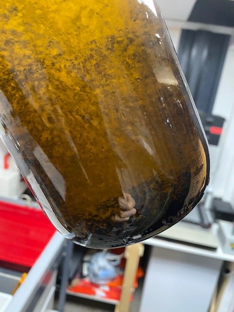

I’m using xtol replenished for all my film developping. I have a 2ltr bottle working solution, a few 1ltr bottles waiting to be used and 10 small bottles to replenish the working solution for each film I develop. All bottles(brown glass) completely filled. I do one or two films per week, sometimes more.
Yesterday I noticed that all bottles except the working solution had a kind of white flakes, looking like cotton wool in the solution.
Anybody had this?
Could it be a temperature thing?
The working solution is at a constant temperature of 24 degrees celcius, while the rest is on room temperature. My darkroom is only heated when I’m using it and this time of the year it’s 15 degrees or so.

My darkroom runs 15C most of the time (it gets more than its share of air conditioning), and I haven't seen anything like this in my Xtol, either working solution or replenisher.
Mold? Phenidone and ascorbate certainly could be food for fungi...
Mold? Did not think of that. Will filter it and see what it looks like. Was thinking of filtering it and than developing a test film to see if still works.
Question is why didn’t it happen to the working solution and am I the only one?
Regards,
Frank
I have had occasional problems with Xtol and some of my other chemistry growing things. Your picture looks similar.
I think it may be gelatin. I sometimes have these appear and they don't filter out using a re-usable coffee filter because they slip right through the filter.
This is what I first thought, but Frank said this only happens in the stock solution, not the working solution. For the record, paper coffee filters will likely work well, that's what I used to clean the gelatinous stuff from my Xtol working solution.

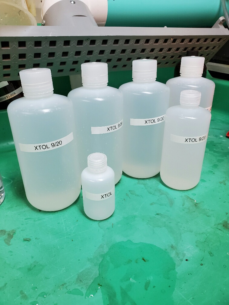

I use all of my XTOL as one shot. My XTOL always does what you are experiencing a couple of weeks after mixing. When it does I simply filter it and the problem never returns.
There's so much sulfite in XTOL, that unless you use purified water,i.e. distilled etc. you run the risk, especially at the low temperatures of the solution becoming so saturated stuff just drops out of solution. I have very hard water, dissolved calcium carbonate, I have a water softener that helps with washing machine, ion exchange substitutes sodium ions for calcium. So now the miraculous soft water is loaded with sodium carbonate. Neither my city hard water, or my whole house softened water is suitable for XTOL, works great for washing.

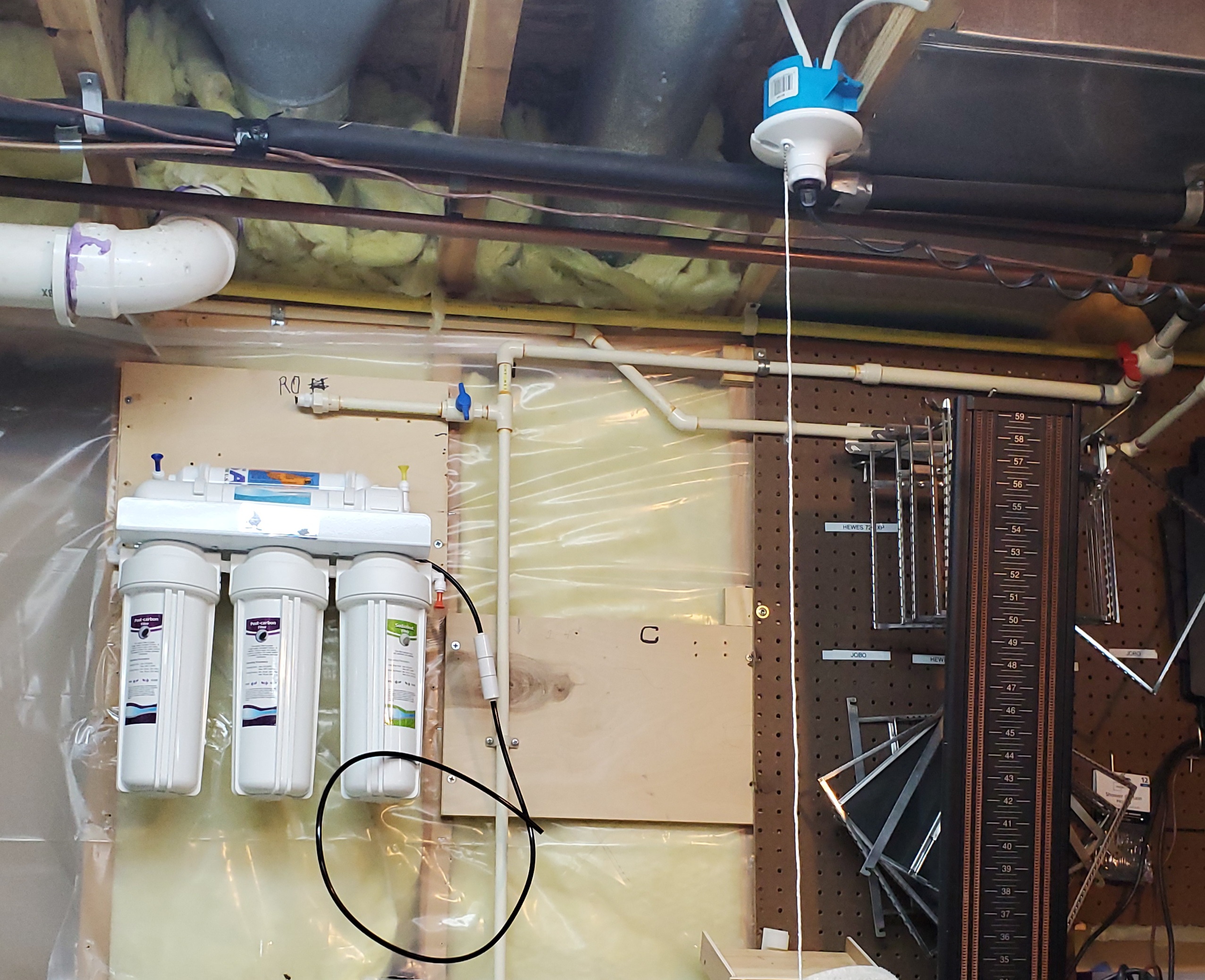

I am in the process of installing my 2nd RO system, this one is going in my darkroom so I don't need to carry water from upstairs to the lower level. In my old house I had the system in my utility room and I ran a line to my darkroom, kitchen, refrigerator and master bath.
I'm installing a 9 gallon tank, most are around 4 gallon, in my darkroom so I will be set. I have a 5 stage setup, costs about 250 usd to buy and about 50 bucks a year for service filters.
I store my XTOL for 1 shot in 125, 250, 500, and 1000mL Nalgene HDPE bottles it doesn't fall out of solution in the very cool winters.

PS the RO systems remove iron . This puts to rest the risk of the "sudden death" that's really some iron reaction. Of course the smart thing would be to order a bottle of Rodinal and DD-X and to hell with all this. I like to make things difficult. :smile:
