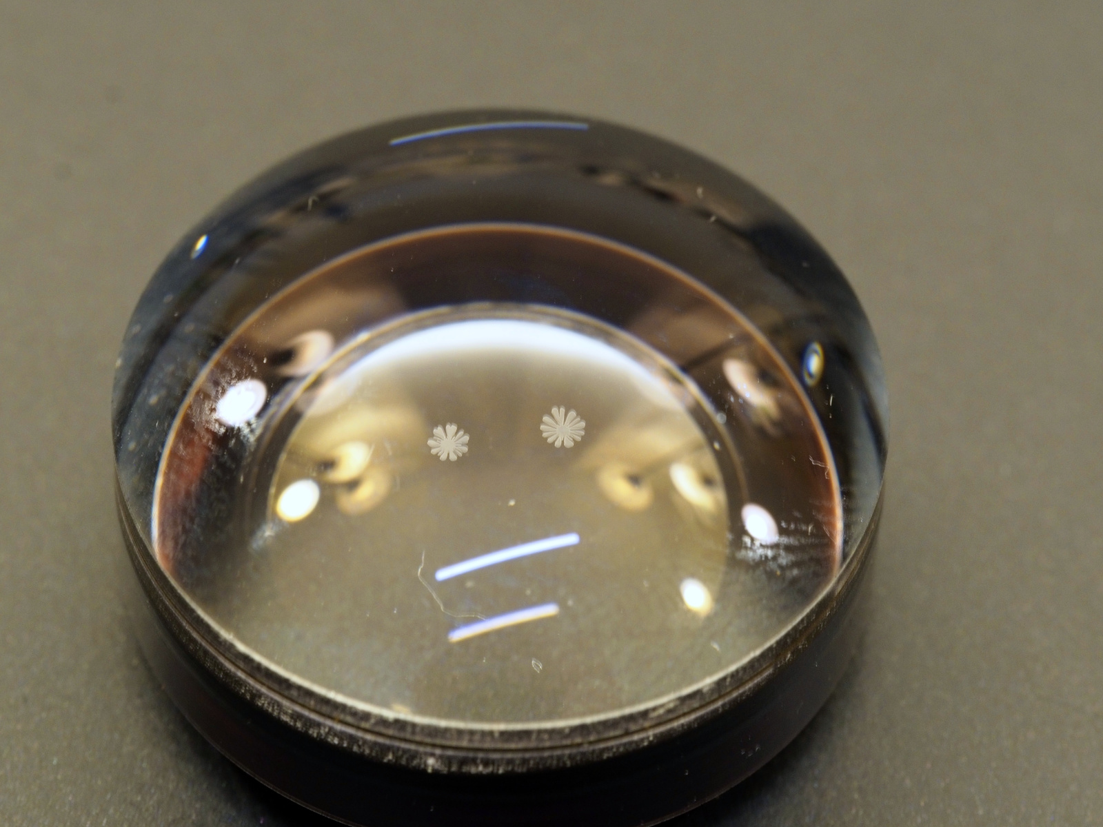

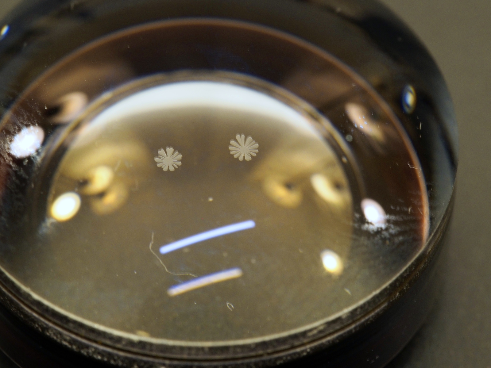

In the middle of a cemented pair. The two snowflake shapes. This is back pair of the front group of a Schneider Xenotar 2.8 (Rolleiflex D), from about 1955.
Opinions on what this is? Thanks.

I would vote for separation.
In my experience, fungus has some form of texture to it; this looks very "mirror-like".
lecarp
May 8, 2009
326
8x10 Format
Seperation, I've a Meyer Satz Plasmat with this issue, only one snowflake in mine. Whenever I've seen this, it occurs just off center of the lens.

Those are balsam separation artifacts. It's relatively common on Schneider Xenon lenses from the mid-fifties as well. This specific type of separation is due to the presence of a tiny particle of dust in the adhesive layer which primes the cemented pair for separation after years of temperature cycling.
You may find you can make those disappear by gently heating the lens group with a hair dryer and then gently pressing from both side of the group. I've done it once with one of my own and it succeeded.

Thanks all. Very helpful info. Now I need to decide if I want to risk heating the elements. Being much larger than the Xenons, I'll find a slower way to bring it up to temperature?

Keep in mind there is a risk of upsetting the alignment between elements with heat. Maybe you can mitigate by holding the doublet between V-blocks.

Yeah, I'll need to make a jig. Especially if I plan to apply pressure. The top element is convex on the otr surface and concave on the lower surface so one slip and the top element could just roll off.

Check the outside diameters of the two elements with an accurate caliper. if they are not the same ( often the case - deliberately ) then you will not be able to re-set the two elements using v-blocks. You will need an optical check using reflections and a rotating bearing. The tolerances in an f/2.8 Xenotar will be pretty tight.

But are you sure it's in the balsam? I seem to remember something about dust-speck in the coating process may give raise to this bype of blooms?

Apparently all you need to do is locally heat that spot, so I would be sorely tempted to try to do it with light. I doubt that a laser available in household use would have enough power, but there's always a magnifying glass and the sun. You'd need to experiment a little with the focus point since the element of the lens itself would have some power. However, you also probably don't want a perfectly focused point of heat, rather to move it around to heat the area of separation. It would be nice to experiment on a less valuable lens, if one could find a less valuable lens with the same problem. That goes for any of these methods, I imagine.
