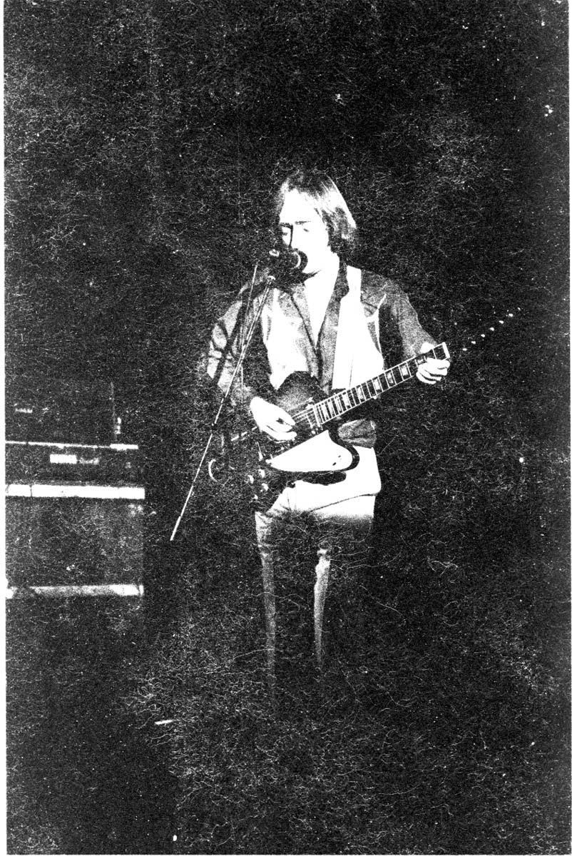

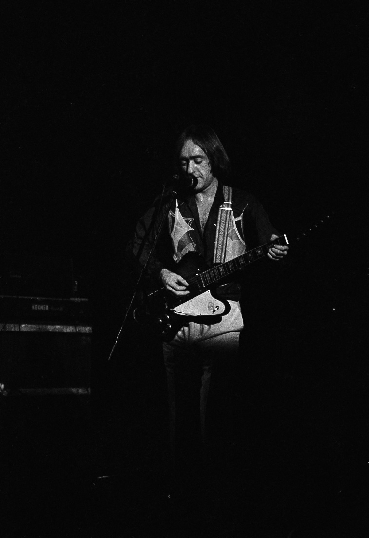

Frank53
May 18, 2013
660
Reuver, Netherlands
Before and after "treatment"

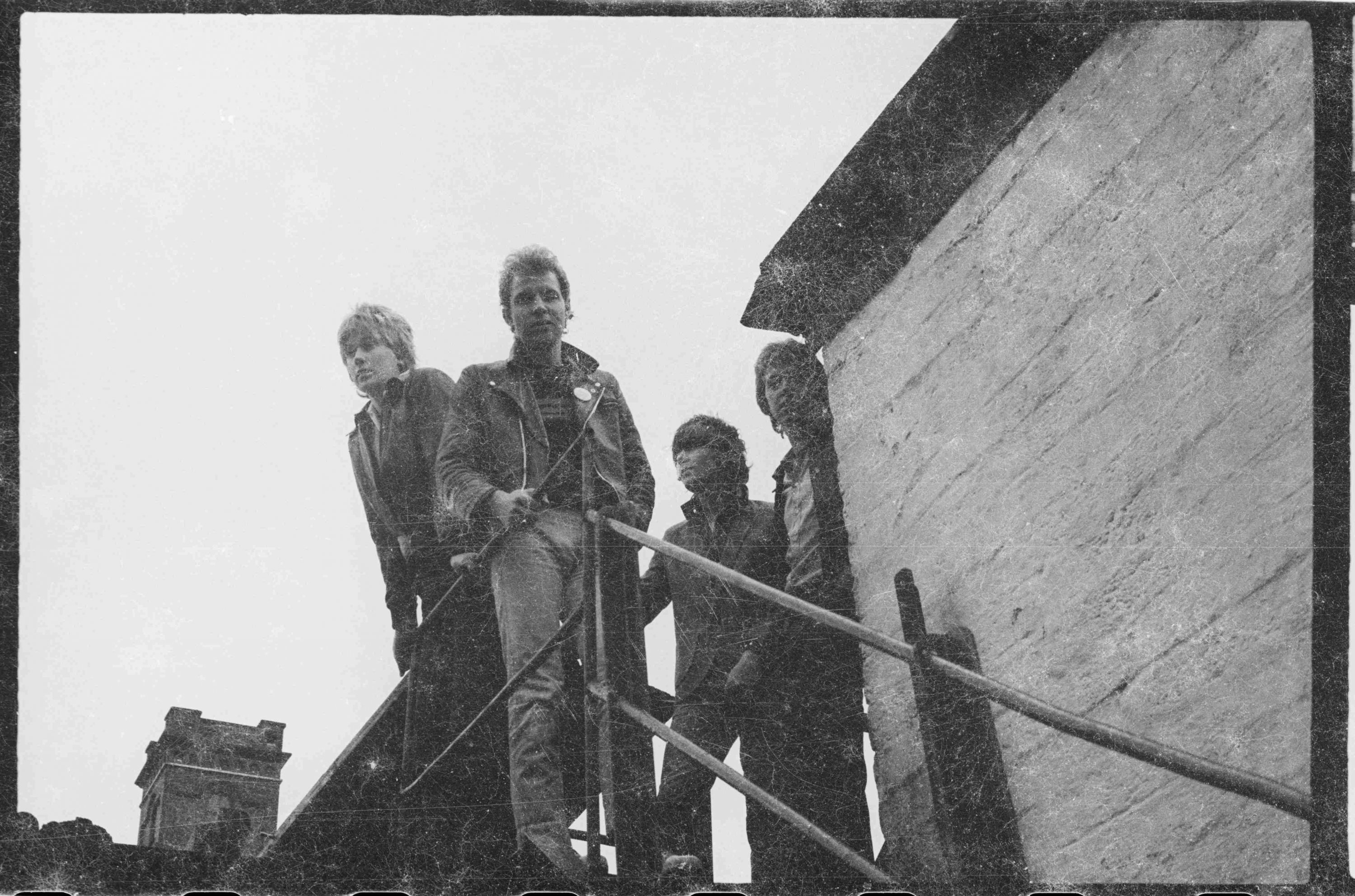

Nov 22, 2017
Breda - NL
hallo Frank
What are your experiences? I have fungus in a lot of my negatives, shooted in de eighties.
Do you think I can tread them as you mentioned? Here I show you one ofe the negativers, the image is about 10 % of the complete image.
Piet

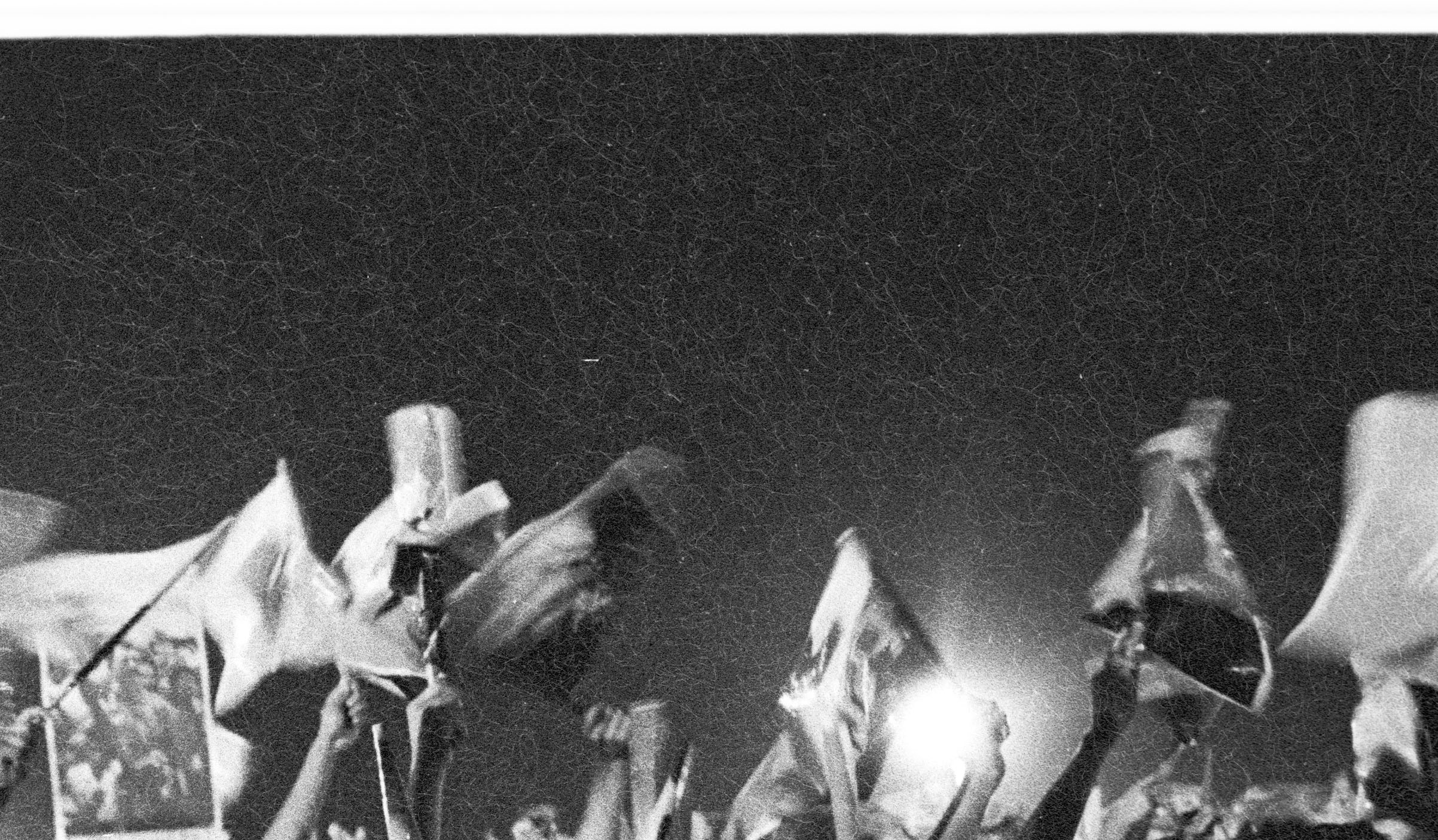

AliG
Feb 12, 2021
5
Belfast
Just trying to restore some negatives (HP5) taken in 1978 so really interested in this.
I developed the film myself using Paterson chemicals which were usually out of date and over used.
Their appearance is exactly the same as this image. The results you show are stunning so I would really appreciate your opinion on how to restore them.
Cheers
Al
Sirius Glass
Jan 18, 2007
50,338
Southern California
Cheers
Al View attachment 266413
A few scratches on the negative.
