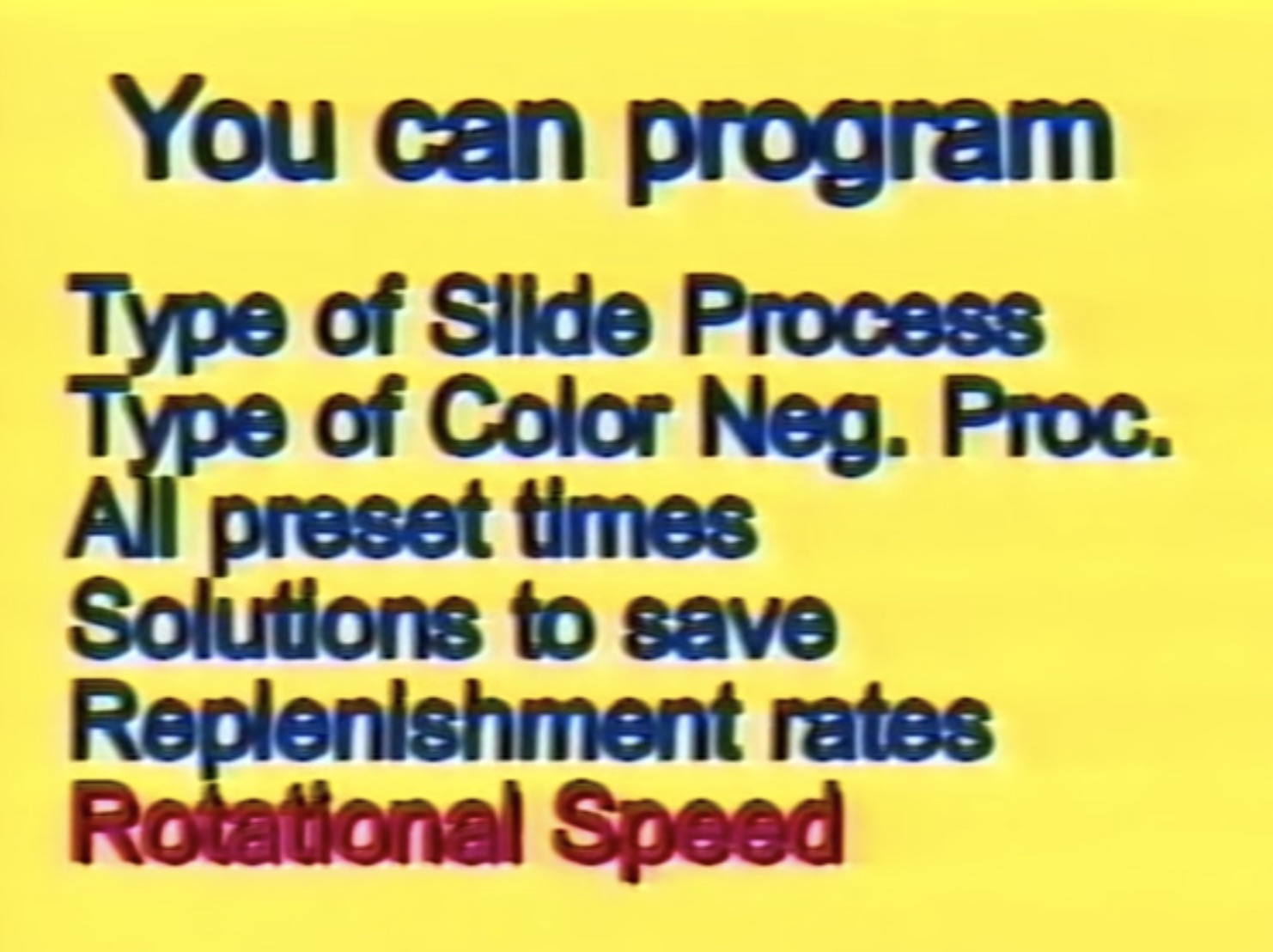

According to the video rotation speed can be programmed. Might be worth experimenting with.
