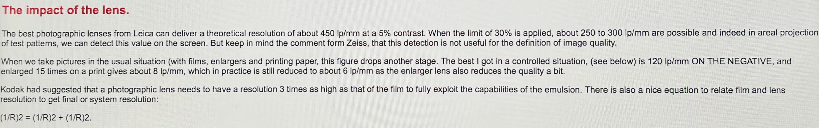

Here is something interesting…!
An interesting claim which seems silly when one considers that photographs are limited to a max resolution of 250lp/mm due to the limits of light itself.
The author of that last statement might take umbrage with your reply...!
If you understood the absurd complexity of thought possesed by the German intellectual, you would understand their habit of going to extremes.
I should have made my position clear by stating that the practical limit of the light/optic/film interface is 250lp/mm, which you need a laboratory-grade microscope to resolve!
Edwin Puts certainly had a passion for Leica cameras and lenses, and was able to parlay that passion into a successful career, but I don't think that by itself qualifies him as a German intellectual.

There must surely be something missing from that final equation? Unfortunately that undermines my confidence in the rest.
Back to square one...!
There are a couple of sorta standard empirical equations used in the business to estimate a "system resolving power" given separate film and lens numbers. One is: 1/system_resolution = 1/lens_res + 1/film_resolution. The other is similar, except that the res numbers are squared, meaning 1/R^2 (I presume this is what Erwin Puts was saying but was perhaps lost in a conversion to straight text).
In application say that a hypothetical lens and film each resolved 200 lpmm. When combined the first method suggests 100 lpmm system resolving power; the second, using the squares, suggests 141 lpmm. The uninitiated might expect to still get the entire 200 lpmm.
