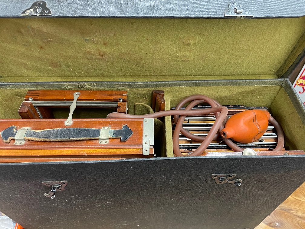

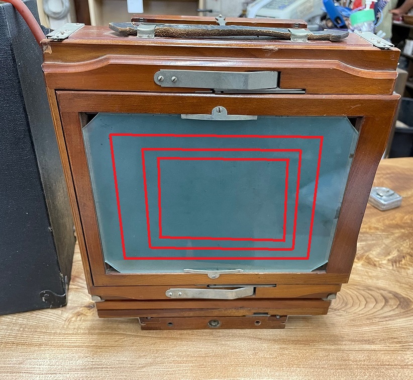

Hey all,
I am considering purchasing a Krona Full Plate camera kit, but have a few questions maybe someone more familiar with large format vintage cameras can answer..

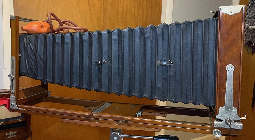

As you can see in the photos, it's complete except for the lens and it sports a Packard shutter. Of course, the pneumatic bulb is petrified from being stored forever and the bellows are quite "crackly".
Since it is not mine yet, I did not extend the bellows beyond a few inches but they certainly are dry and might be beyond salvage.

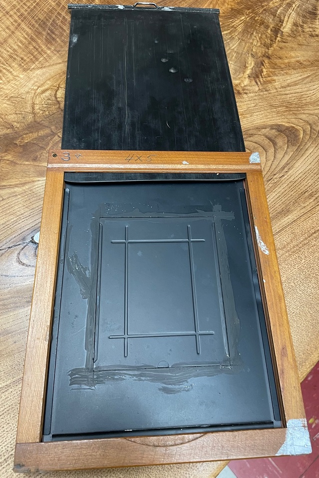

The kit comes with 2 x full plate film holders and 3 x full plate holders with 4x5 film sheaths glued to the back of the divider of the film holder. Was this a common practice or is this a home-brew solution to using smaller formats?

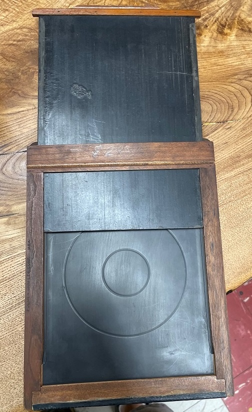

The ground glass has 3 etched sizes on the glass. I didn't have time to measure them, but assume the outer one is 5x7, the next 4x5 and beyond that I am unsure; 3.25 x 4.25?
I would be interested in shooting 5x7 with this camera, as full plate is harder to come by and probably not worth the added expense to me. How would I go about finding 5x7 film holders for this beastie if I should consummate the purchase?

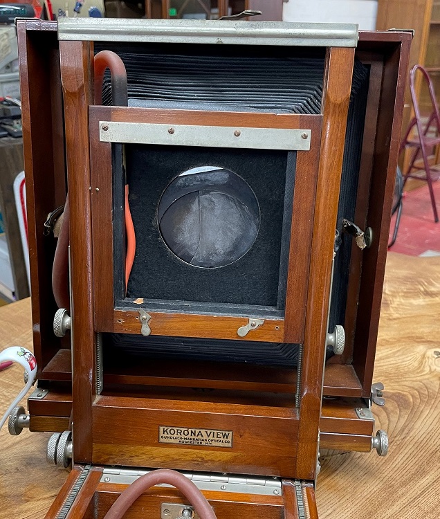

The packard shutter appears to be functional except for the rock-hard pneumatic bulb. I'd probably save that for the chance of shooting tin types or similar, but would probably make a another lens board for whatever lens I would purchase. Which brings me to period correct, but affordable lenses for this camera.
Suggestions for a vintage convertible lens that would cover full plate to 4x5?
Tell me your thoughts...

You can use 5x7 insert film holders like the 4x5. This is common.
It wouldn't be hard to convert to take proper 5x7 film holders if you have wood working skills.
Bellows can be expensive to replace, so factor that in the price.
Shutter probably needs servicing.
It may be better to buy a working 5x7 than pay someone to alter this one.
It looks similar to my Kodak Specialist view camera, which is half plate, but takes 5x7 film holders.

Don't discount the pleasures of whole plate! It's a wonderful format, it's almost as much bigger than 5x7 as 5x7 is to 4x5, but the camera/lens weight and handling feels about the same as 5x7. With the Ilford Large Format order window for this year just closed, you might be able to shake a box or two loose from somebody somewhere who ordered it and can't use it. Having said that, if all those holders are kludged up like the ones you showed and the bellows is shot to hell (I've had stiff bellows that were still light tight at shorter extensions), this may not be the perfect whole plate kit.
nosmok
Jun 11, 2010
698
PS: does it have any lens boards to go in front of that Packard? Ebay vendor zbima can make just about any lens board well, but that would be one more layer of hassle and cash.

Can't tell from the pictures what the bellows look like. Chances are they're brittle and maybe full of holes. A new well-made set will set you back about $200. If you plan to shoot a lot with this camera, you may want to upgrade the lens too. (Edit: just took a second look at your post and see this is on your agenda already.) Can't help with ideas for period-correct lenses; I like my Koronas for their ease-of-shooting qualities and have only ever used modern lenses on them.

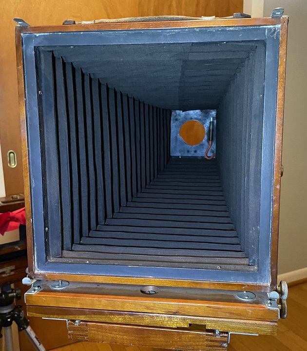

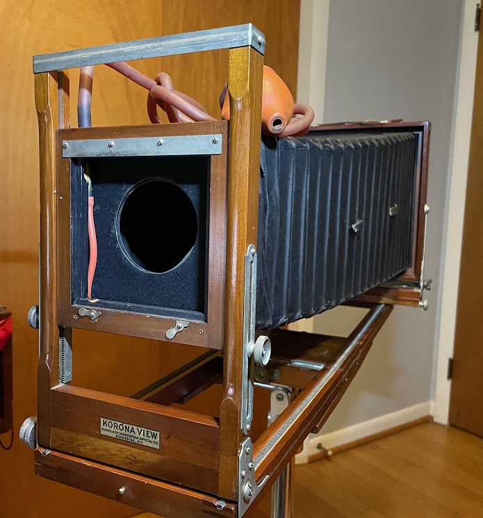

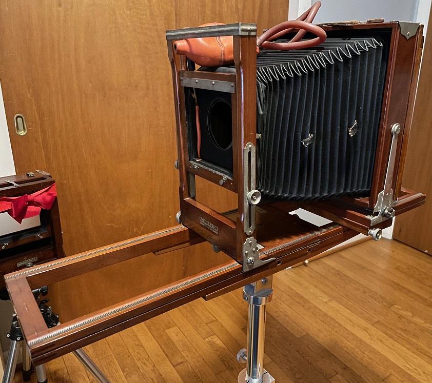

OK, I did manage to purchase the camera.
Of course, the bellows look like a Christmas Tree when you put a flashlight in side and turn off the lights. However, it was surprising the bellows extended the full length of the bed and extension without ripping apart.
Replacing these bellows is going to be staggeringly expensive; 28 inch/700mm draw!
Still not enthusiastic about how the last person punched through the bellows with the tube for the Packard Shutter and it seems "lazy" and the spring may need to be replaced or shortened, as it intrudes on the circle cut-out behind the lens.
I've seen instances where the pneumatic hose barb was on the lens board, rather than through the bellows material, so I might go that route instead. I'd like to keep the Packard Shutter for barrel lenses, but it can be sacrificed if need be...

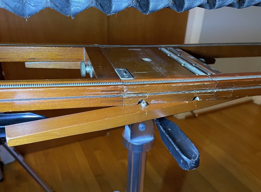

I was surprised it had these wooden reinforcement bars that slide under the extensions and camera bed to stiffen the entire camera; I have never seen that before, but then again I am not a knowledgeable Large Format photographer.
Other than the bellows, the camera appears to be fully functional; well worth the wait!
It's going to take a while before I get this one going...
