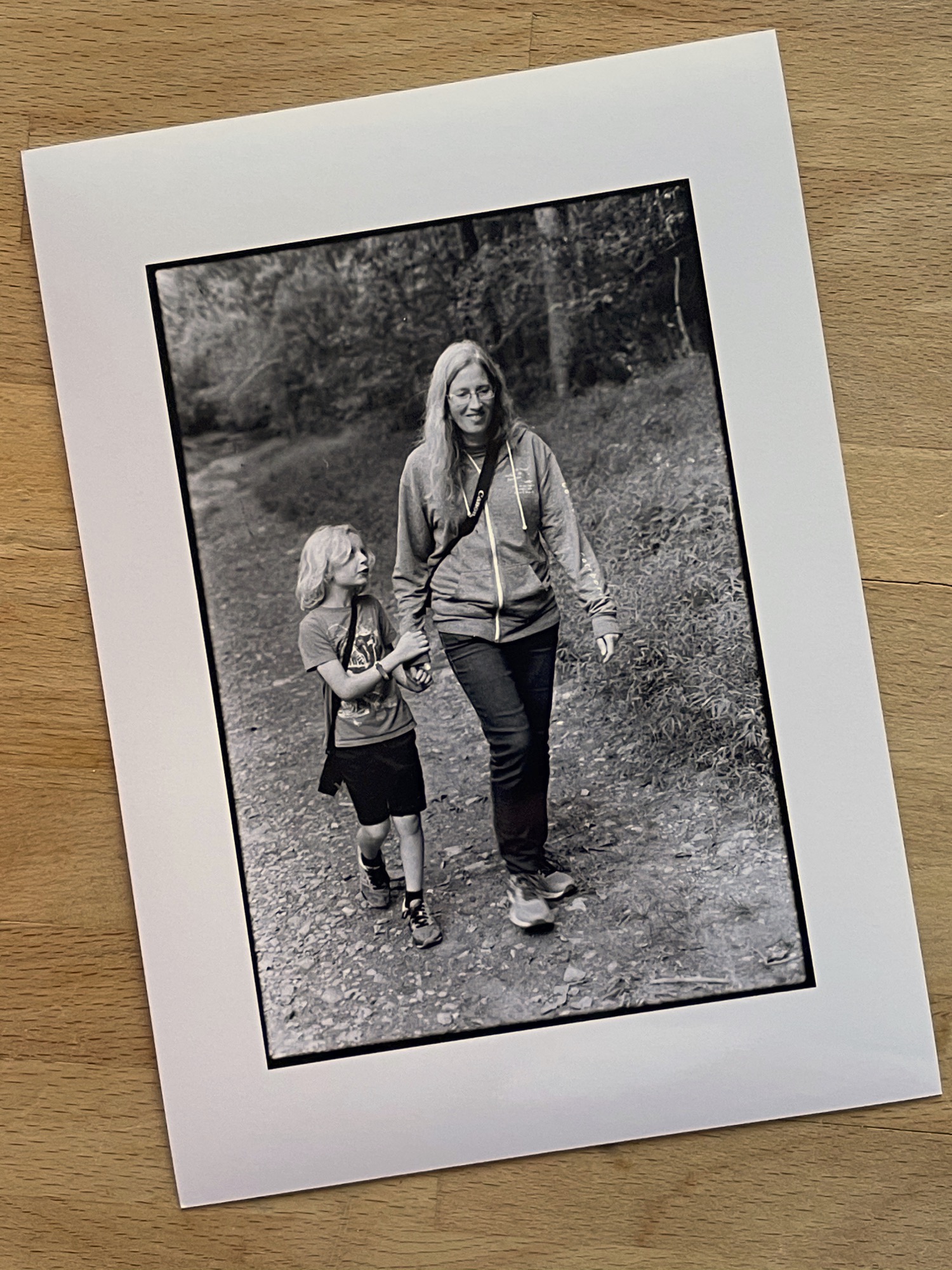

I have the Beseler 8055 full-frame and can confirm, it works beautifully for giving black rebate borders but no sprocket holes. You can combine with a four blade easel to quickly set up a centered image with a nice clean outer edge to the black:
