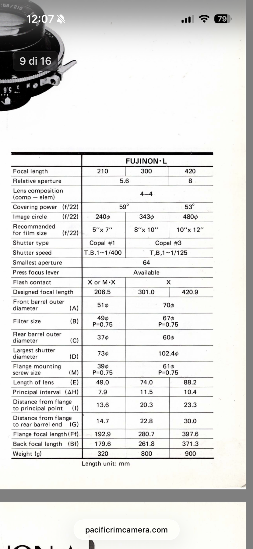

I checked the pdf and found following data
Distance from flange to rear end of the lens 30mm
Flange focal distance 400mm
Does it mean that with 3cm top hat lens board
I will have 3cm of focus range?

If your bellows extend up to 400mm, presumably you would have a little bit of focus range due to the thickness of the standards and the 5mm distance into the film holder. An extended lens board should enable you to focus closer.
If the camera has say 20mm of standard depth and you add a 30mm extension on that 50mm of focus range should allow for focusing as close as 3.6 6.3 meters according to the math. Not exactly a closeup but closed than I'd expected tbh

With a 2" top-hat you could do a lot. That's up to you to decide if it's enough, and as mentioned, that 420mm is a heavy mother. I use a Fujinon T 600mm on my Toko (NOT Toyo) 4x5 field camera -- which has 360mm of extension. The 600mm is large, but not too heavy, and only needs 385mm of extension, so a 2" top-hat works fine for me. Depending on your camera, a top-hat might work for you too, but there might be some logistical obstacles -- like getting the rear element to fit inside the top-hat without vignetting.
But there are other alternatives, like the Fujinon T 400mm (260mm of extension), but I doubt that the T lenses will cover your film. Anyway, here is their complete rundown of lenses with IC size and FFL:
http://www.subclub.org/fujinon/

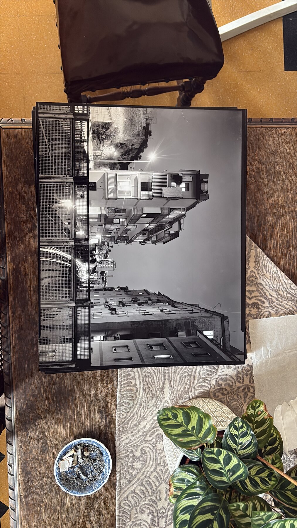

I was also Looking at more common lens, 450m NIKKOR F9, it has 430mm of flange focal distance, I Made some calculation and I coud focus it up to 10 meters with 5cm top hat board. I shoot only urban landscapes (image attached). At 450mm of extension 450mm shoud capture 4x9m kind of small for a building so im sure that ill be okay.
But can top hat lens board introduce vignette when heavy movement applied?

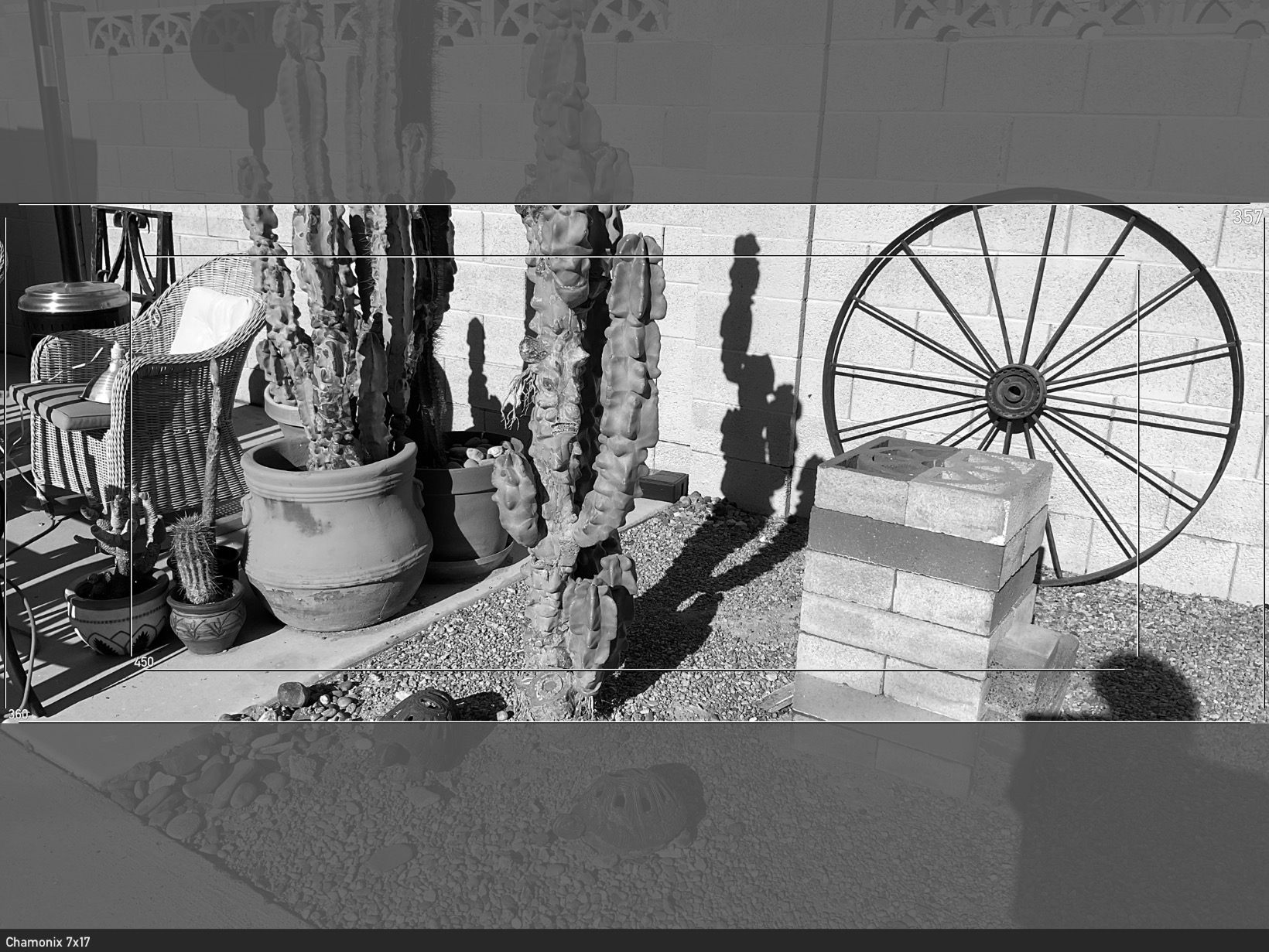

While you can make these modifications to use lenses longer than your bellows, my question is why? The perspective difference between 355 and 450 is miniscule in ULF. My “rule” is to jump up at least 50% when changing lenses in ULF.
Look at this [terrible] ipad image. The outer frame shows an image taken with a 360 and the faint inner line is that of a 450. A 420 would be even less of a change. Your 355 covers, allows images closer than infinity and simplifies your gear in the field.
A change from a 355 to 450 is significant in small formats. Not so much in ULF.
Just my two cents from 30+ years in ULF. Have fun whatever you do!
