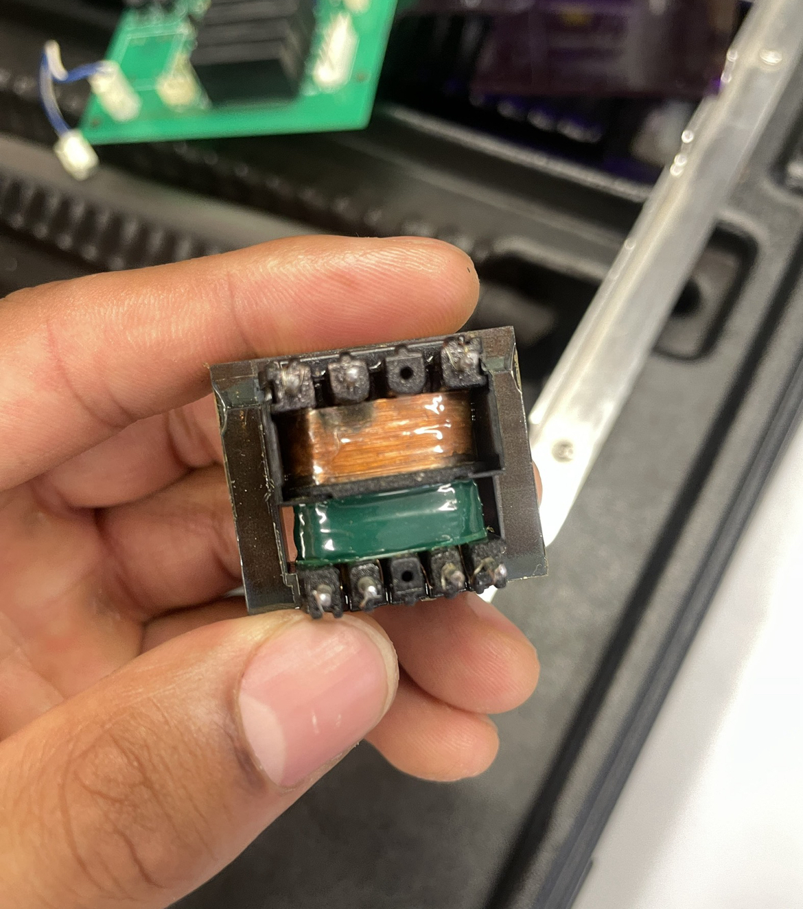

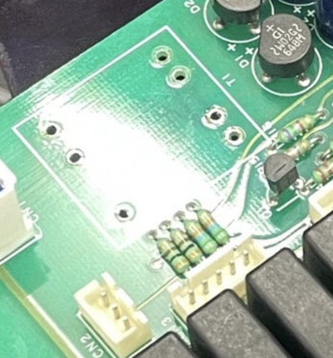

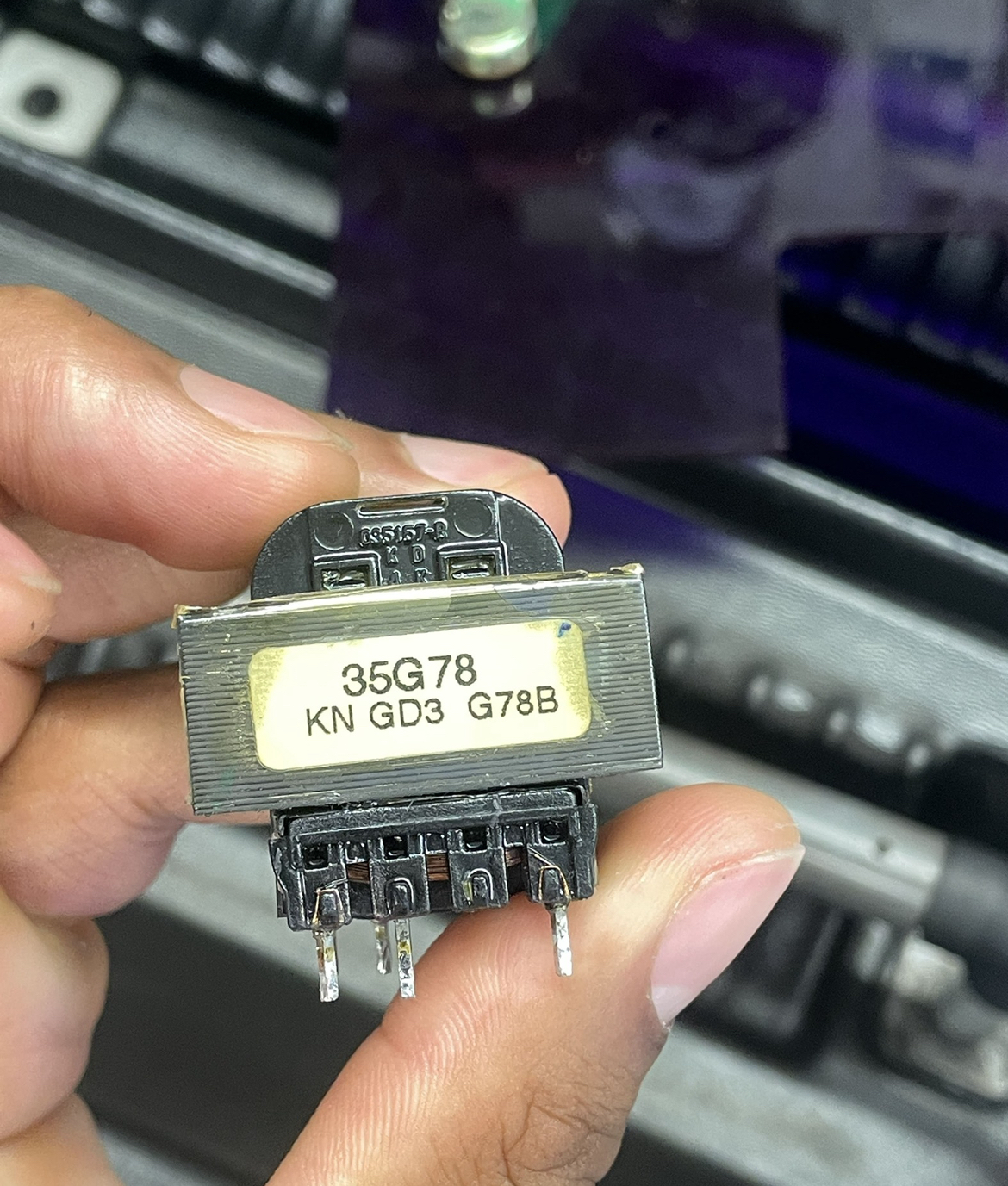

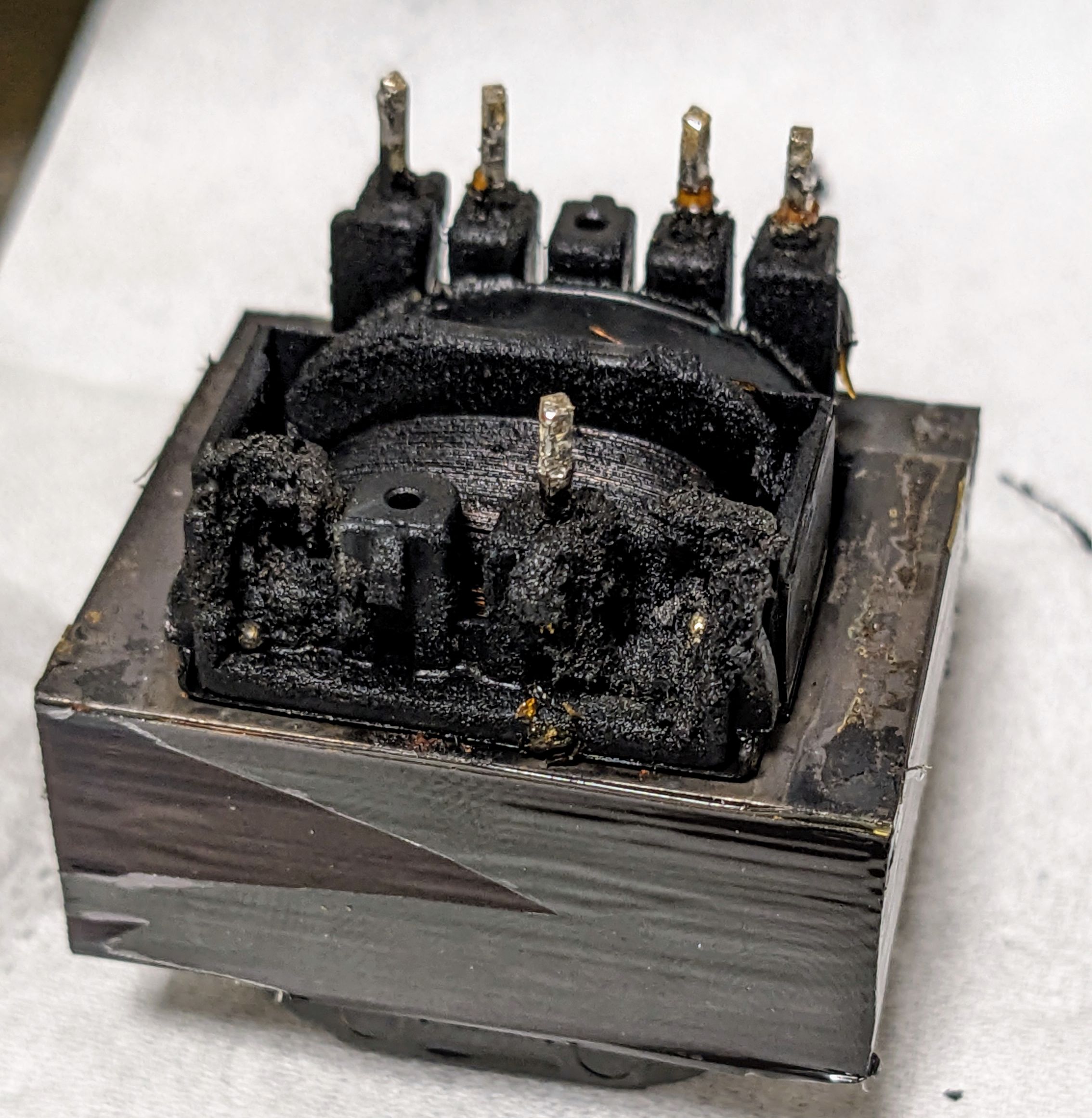

Hello everyone, unfortunately I made the stupid mistake and connected the device directly to the socket without stepdown, so the processor got 230V instead of 120V. Everything went well for 20 seconds and then there was a loud bang and it smelled like something was burning. After an electronics technician examined it, it turned out that the transformer was gone and was visibly scorched. Unfortunately, this transformer can no longer be found under the model number.
Can someone show me an alternative?
Alternatively, is it perhaps possible to install a transformer that can handle 230V directly?
** service manual: https://www.silveruser.ca/Manuals/CP31 Service.pdf

you may be into engineering work. first you have to figure out if twice the voltage fried anything else.
second if the rest of the unit is repairable find a transformer with the right output voltage, big enough curent output (YES the engineering part) with the primary for your local power system. (we call that Hydro here, but in some places it is the "Mains") then ofcourse you will proably have to work up a mounting.

It looks like the board itself is fine. The rectifiers, the electrolytic capacitors both look good, and the voltage regulators (these three legged ICs which look like big transistors) also look good in that pic. You may be lucky and it was really the transformer which took the fall for the rest.
There are companies, which will make you a new transformer to spec. For this you need to find out the label on these two voltage regulators. These labels will tell you their input voltage, and from that we can determine the AC output voltage of your transformers. You'll also have the get the exact dimensions of the transformer core, there's a very high chance it's a standard size which is available at outfits which make transformers.
If a new transformer is all you need, expect to pay 10-30€ for a new one, if the exact voltage and power rating is a stock item somewhere. If you need a custom transformer wound to spec, then expect to pay 50-100€.
Yes.
What's the text on both voltage regulators, the ones between the big blue capacitors?
The easiest solution is probably to get a generic AC-DC switch-mode power supply that outputs either the required voltage(s) directly, or one of both voltages you need, or something slightly higher (3V+ or so) than the highest voltage you need. Then make any other voltages you need with buck converter modules. There's a couple of ways you can do this; either you can make DC voltages that you feed into the existing rectifiers, regulators etc. Or alternatively you could bypass the existing rectifiers, filter caps and regulators and feed your self-made DC voltages directly into the output of the regulators.
It's possible that one of the voltages is a positive one and the other a negative and that the regulators are e.g. a 780x (positive0 and a 790x (negative); don't worry if this is the case since you can also use a buck converter to make a negative voltage. I suspect this dual pos/neg supply is what you've got given the placement of the first pair of buffer caps and the one regulator with the heatsink while the other doens't have one.
Yes, you could also try to find a suitable transformer; it may or may not be difficult to find. These days a LF transformer like this one is generally a little harder to find and a little more expensive than a similarly rated SMPS due to the cost of copper.
The main challenge with all this is to make your new solution fit into the original space. With a bit of luck you have some room to play with. If you want to make things really hard on yourself, look for a virtually identical transformer that will fit in the existing PCB holes. If you just want to get this show on the road, I'd very firmly recommend to drop that plan and go for a mechanically more flexible approach.
The advantage of using an SMPS is that they'll generally accept a wide range of input voltages; e.g. 100-240V, while maintaining the same output. With an old-fashioned transformer this isn't possible.

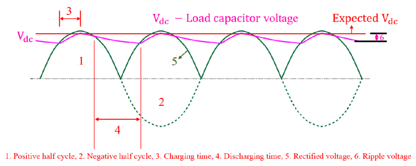

Good point with the manual, however: if you need 11-12V DC input voltage for these regulators, then you should rather choose a 2x9V output transformer, since a bridge rectifier plus capacitor will turn this into 9V*sqrt(2)-1.4V = 11.3V, which is all you need. Providing the rectifiers with 12V AC will just burn more power, which means the bare, uncooled voltage regulators may become very hot.
I had already addressed this point in my previous post:
(yes, peak is 1.4x larger but rectified equals peak only with zero current draw)
And, with a bridge rectifier, one also loses two diode forward voltages (silicon junction? schottky?)
Which is why selecting Veff equal to the desired rectified Vdc is a working approximation.
(credit: https://www.researchgate.net/profil...tage-waveform-by-FBR-circuit-with-ripples.png)
If the OP already replaces the transformer, OP may buy a transformer with 230V primary voltage right away and convert his box to European standards. There's absolutely no point in using a transformer wound for 110V and then using an extra step down transformer.
Sure, whatever transformer (mains ->12V) is easiest to procure.
Read the end of my post. The point is that pumps, transport, heater, will still require 100V. If they are still alive. It was that step down transformer I was referring to.
Virtually guaranteed to be Si, yes. Those bridge rectifiers as in the photograph are nearly always plain silicon diodes comparable to 1n400x.
Yes, and that'll work just fine. Using a 9VAC transformer will leave a 7809 starving, which means it may/will lose regulation.
No no. 780x regulators (99.9% certain that's what's used here) need something like 2.5V headroom. Double diode drop is another 1.4V, so you need let's say 4V above target Vdc. That's 13V, which means a little over 9VAC. Using a nominal 9VAC transformer may or may not work, depending on its specifics, operating conditions, effective line voltage at the wall etc. All considered it's an unnecessary risk, although it will likely 'work'.

As you all know, a 230-->9V transformer outputs 9V when driven to its rated current, something nobody in his/her right mind would ever do. Output voltage will be substantially higher at lower current draw, especially for these small transformers.
Therefore your 9V transformer will provide you with all the head room you ever wanted.

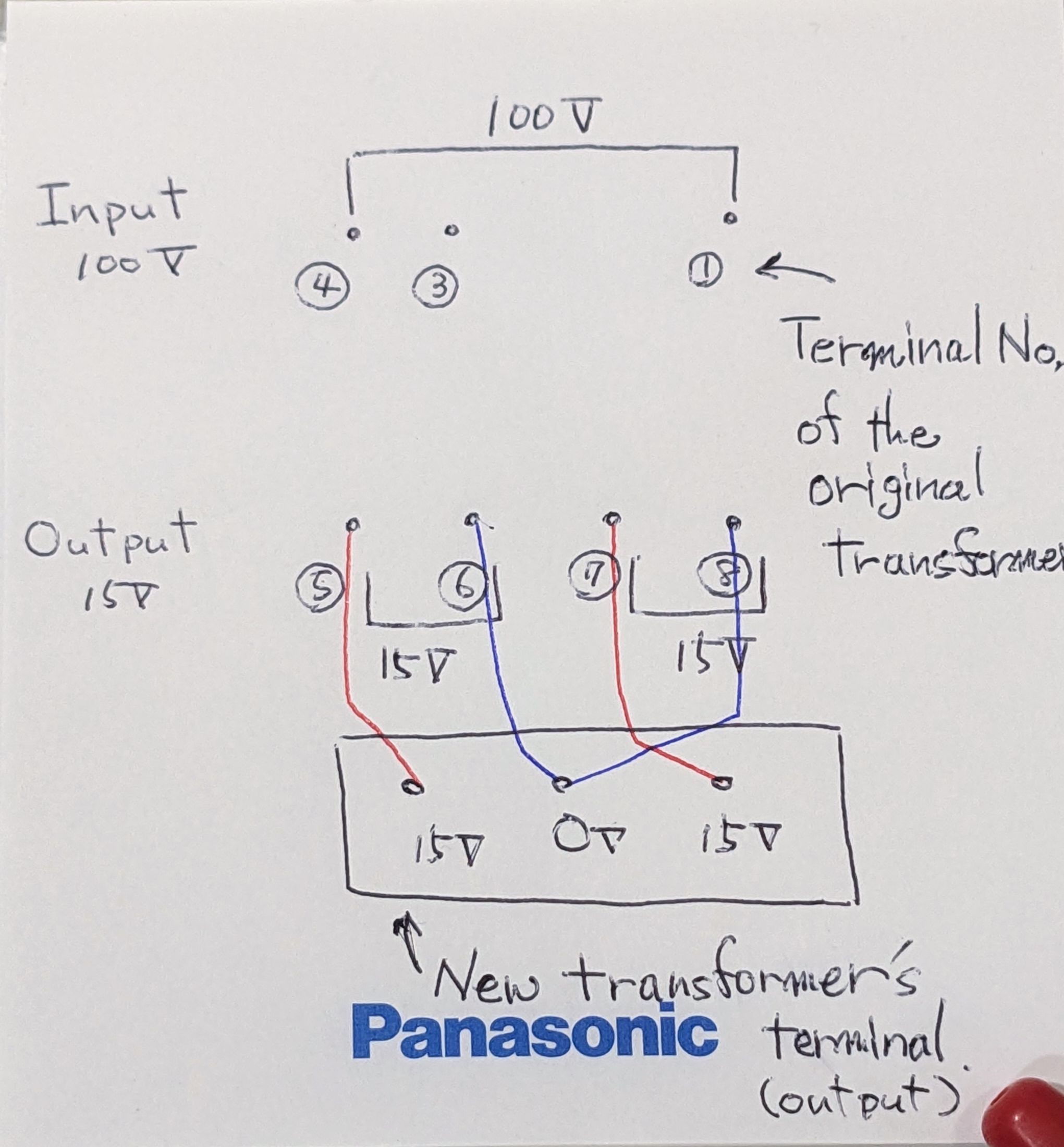

Hello.
I had the opportunity to maintain a CP31 that had a similar problem, so I'll share it.
In my case I had other CP31s that worked fine so I chose the transfomer based on that.
The specs are as follows:
Input Voltage: 100V
Output Voltage: 15V-0V-15V
Output Current: 50mA (…,probably)
So I chose a Toyozumi HP-155 transformer and attempted to repair it.
https://www.toyozumi.co.jp/products/hp.html )
Please refer to the attached note for wiring.
I believe that terminal 3 on the original transformer is probably for fixing to the circuit board and is not electrically connected.
I was able to fix it this way. It looks like a chimera now... .
The CP31 is a valuable color processor, so let's all repair it and enjoy silver halide photography forever.
