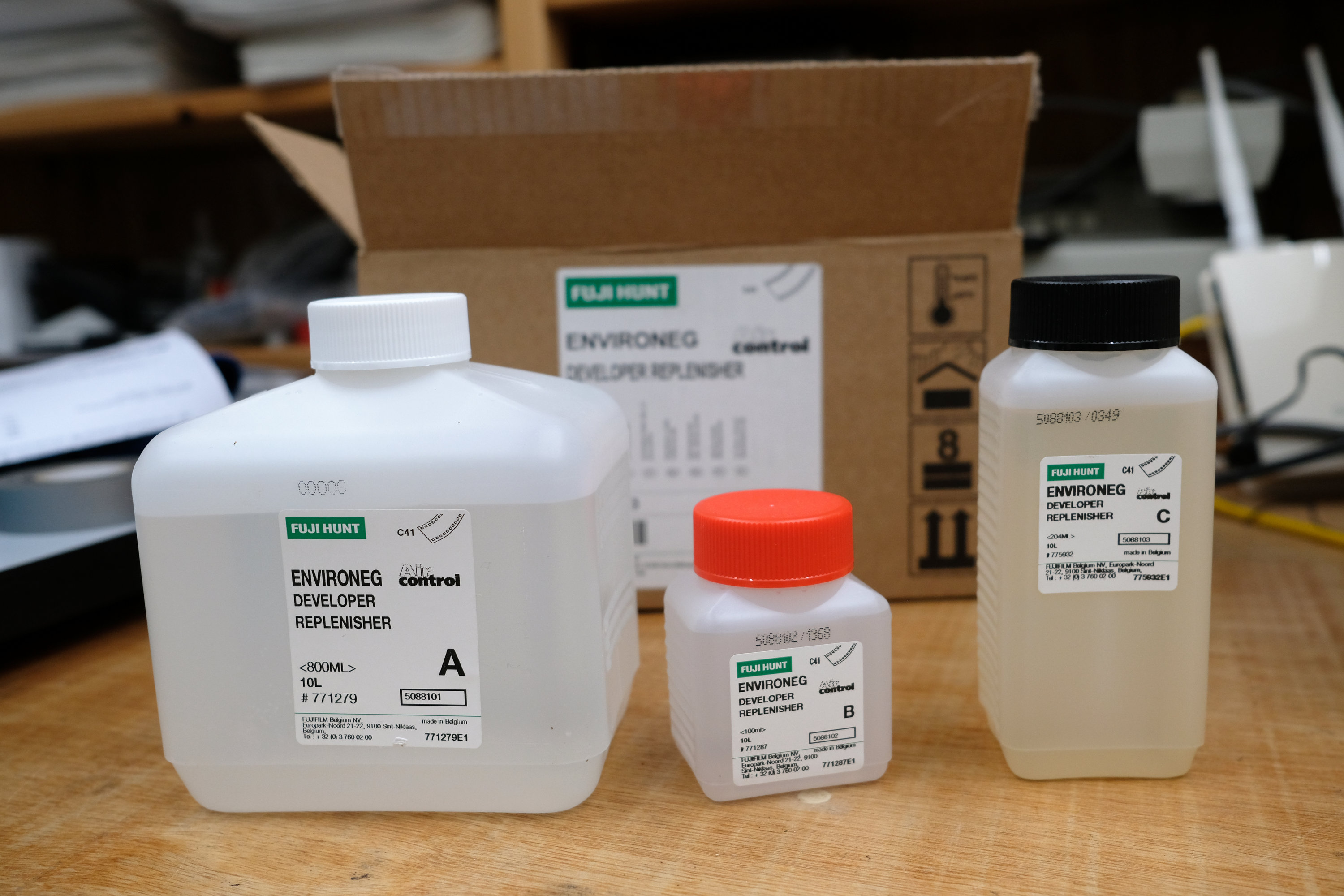

I mix the whole C-41 developer concentrates (most recently Fujihunt Environeg) into working solution at one time and then bottle individually, usually 1000ml, sometimes 2500ml - this works fine, and the working solutions keep well in full tightly capped bottles.

Last year I used enough C-41 film to get through the developer in reasonable time. The member here 'Koraks' introduced me to the Fuji Hunt chemicals and I found their 2x10L (or 2x 3 separate concentrates) product works well. I have the other lot of concentrates left and will mix these up when next needed.
