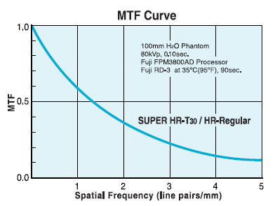

Anyway, as part of my research into what film to buy, I came across the Fujifilm datasheet on their HR-T30, which includes an MTF curve:

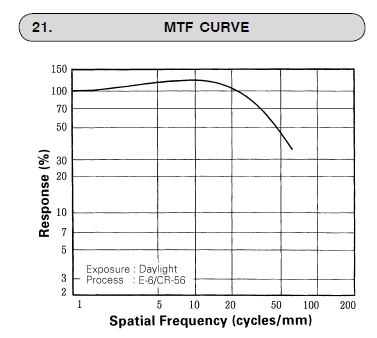

The numbers certainly don't look promising, the graph only goes up to 5 LP/mm. Compare that to Velvia, you're getting 50% at 50 cycles (which is lines or line-pairs? Either way, it's way better):
So I know comparing X-ray film to Velvia is rather unfair, and development method will have an effect (I plan Rodinal stand). But still, getting not much more than 50% at 1LP/mm isn't my definition of sharp. Certainly useful for pinhole no doubt, but is it anywhere near useful for regular-lenses?
Or do I have something totally wrong?

The numbers certainly don't look promising, the graph only goes up to 5 LP/mm. Compare that to Velvia...
First look at what you are comparing.
The HR-T30 curve shows the MTF for X-ray exposure under medical circumstances.
The Velvia curve shows the MTF for light exposure.
This again proves the limited usefulness of data sheets.

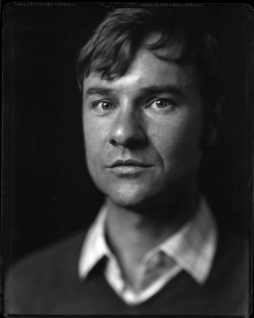

Dr Croubie, just use it and don't sweat the graphs. At 30 cents a sheet, it's perfect.
Fuji HR-S 8x10
80 ISO
Xtol 1:1, 6 minutes @ 68 degrees
Jobo tank, with continuous gentle agitation
Fuji HR-S 8x10
80 ISO
Very nice, that's the kind of thing I want to see. Even on a scan I can see it's sharp enough for me (I'll probably end up doing some 1:1 headshots just like this, my 465mm Apo-Ronar is my best lens for 8x10 until I can splurge again)

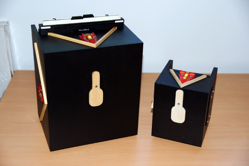

8x10 Pinhole Camera
120 mm
400 microns
X-Ray film - 80 ISO
Film purchased here: http://www.cxsonline.com/text/detailpage.tmpl?command=showpage&sn=182470&sku=GL1171818&cart=1402451295795009&location=10011002
15 minutes, 38 seconds exposure
D76 full strength
6 minutes, 50 seconds @ 65 degrees
Deep tanks, using film hangers.

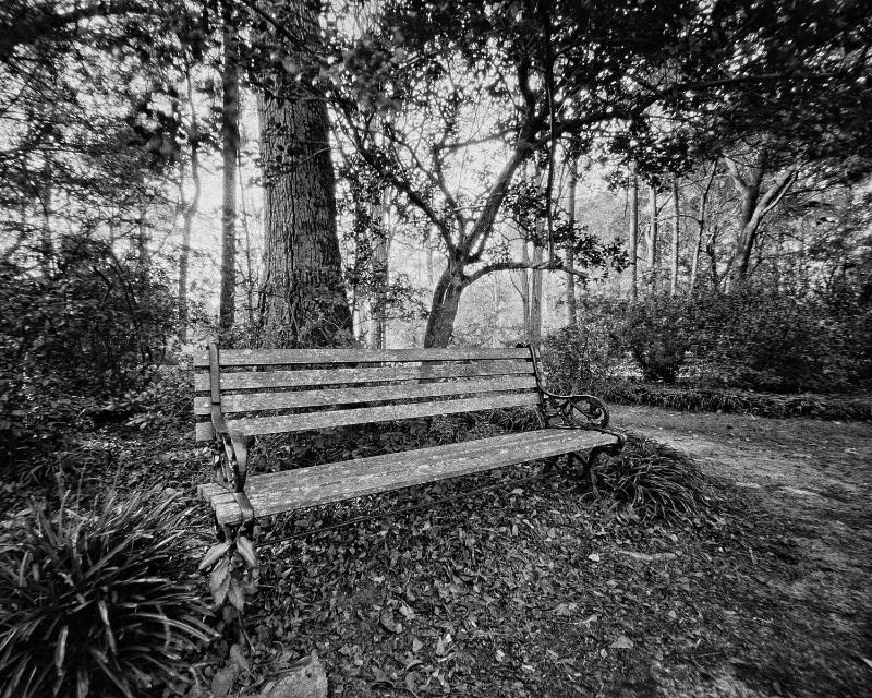

I'm using Fuji HRT green sensitive film and it's not as sharp as most convention film. I don't particularly care since I contact print the negs anyway. My bigger concern are scratches when I process it. I shoot it at ASA 400 souped in Xtol. I Also bought a batch of Fuji RX blue sensitive X-ray film and it's nice stuff also. Looks good at ASA 100 processed in Xtol also. Both I process under inspection under a safelight.
