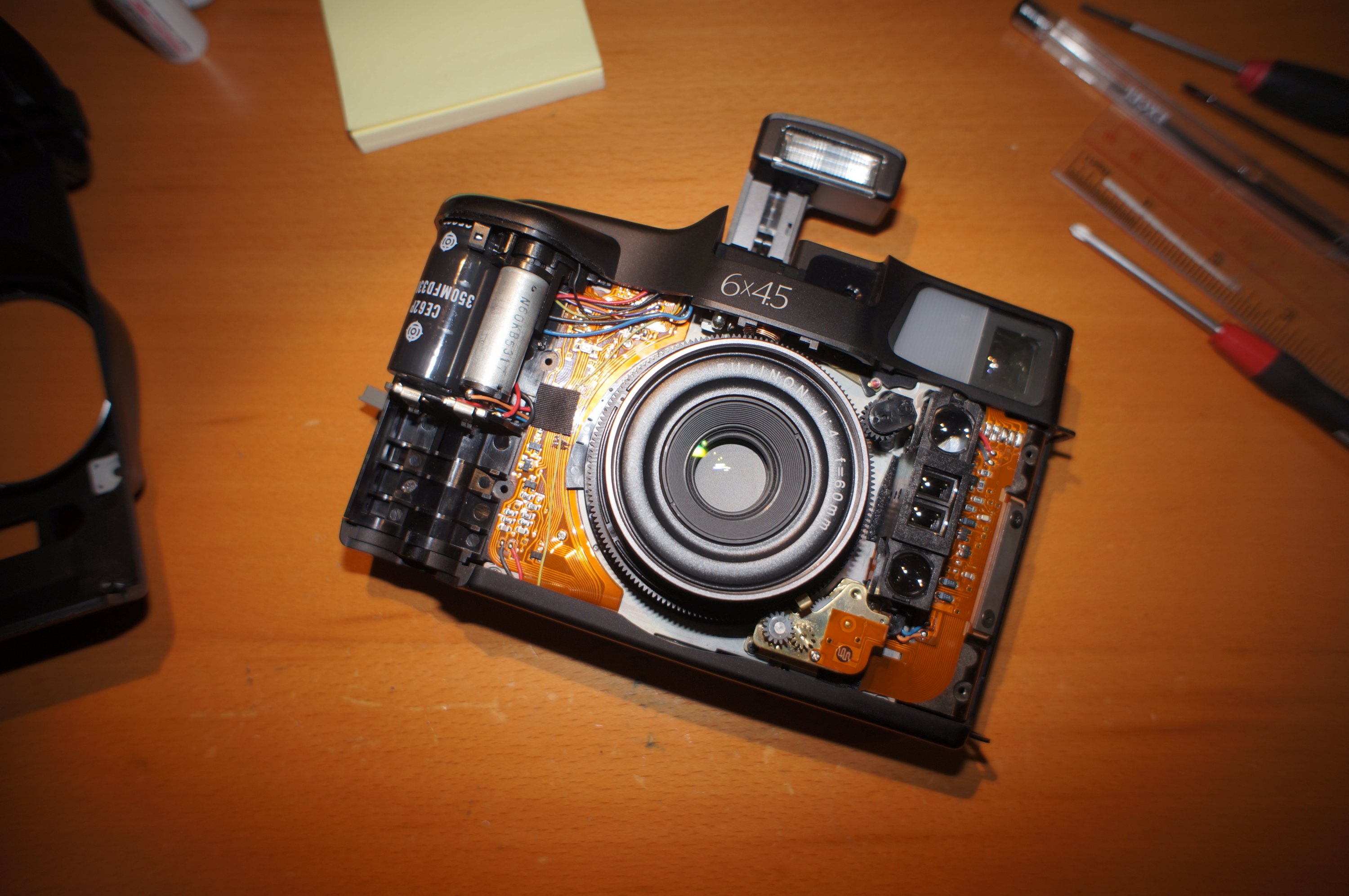

Hi All,
Nice meeting you all, I'm new and hopefully you can allow me to draw on your collective wisdom on the topic. So, the story goes:
I recently got my hands on a GA645 and long story short, it doesn't want to be turned on. I'll describe what i'm seeing:
Fresh battery, when I switch to P/A/M, the LCD would light up, I hear some kind of whining from the lens assembly, for may be half a second, and then LCD goes blank and it goes back to being dead. When I open the back and turn the camera on, I see that the whining is from the aperture contracting may be a stop at most, before returning to fully open and the LCD going blank. If i turn the dial to ISO, i can play around with the selections fine. I can even check the total shutter count (020 00).
I have taken the cover off the GA to see if it was dust or what not jamming the gears. The gears moved fine and there wasn't any noticeable corrosion or whatnot falling out, I assume the problem is from the shutter/ aperture unit. I imagine it's the coil motors acting up. Although I did fix the jumpy control dial issue entirely. The local Fuji camera repair center concluded that whatever's out of production can no longer be serviced and congratulated me on my handsome paperweight (joking).
I have tried leaving it *on* without battery for three four days to let the electronics reset, no luck.
So.... I'm all yours for suggestions...

Actually, when i took the top cover off, i managed to change the status quo when i was pulling at the M/A/P dial. I made the whining go away all together but the LCD went dark after briefly coming alive. When i carefully put it back together, the whining came back (which in my opinion is good because the camera at least had some physical part moving. I'm now massaging the command dial back and forth to see if it does anything...

The whining sound ind my ear (sic) as some drive taking too much current and the eletronics stop the operation just started. Normally I would expect a error message in the lcd, but you don't get one, hmm.
I would look for some tiny part of dirt or so in the mechanical part. The first thing my camera does is driving the lens out. If yours work the same way I would look at this first.

So you think it is some mechanical stoppage that triggers the camera's self protection to power down all together?
I manually turned the gears to get the lens to come all the way out and go back in when I took the cover off the camera.. so the problem isn't there...

Thank you for the advices. I recently got the camera when I was on a trip in Japan. Returning it would be quite out of the question. While it is tragic that the camera is not working, it is at least more alive than dead ... i suppose. I am still massaging the command dial .. to no effect though.
Can anyone confirm during start up, does the aperture do this contraction thing or does the lens assembly move forward without the aperture doing anything? trying to figure out if it has commenced the right start up protocol/ procedure but broke out of it or has it gone entire mad and is trying a completely different start up procedure entirely.

> Can anyone confirm during start up, does the aperture do this contraction thing or does the lens assembly ...
I just tried it. As said I have a GA645Zi. With open back I can see the stop. If the camera is switched off the stop is nearly fully open (I see around 0,2 mm of the stop edge). If I turn the dial from Off to P, first the lens moves out and then the stop closes to a medium value, I guess around f/8.

It brings me great joy to report that my irreparable GA645 has returned to life after a month at the local repair shop and about 150USD later. It was pretty weird because the repairman called me one day telling me it is futile and told me to pick it up ASAP to free up space on his shelve, and on the next day, told me he located the board.
