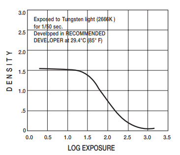

EI 0.2, Tungsten... with normal (for microfilm) processing. We’re probably talking about monstrous contrast that you’ll want to tame at least a little - but hey… EI 0.2!!!
Well, according to the plot you posted, not necessarily monstrous - just very high. Squinting at it looks like a 6-stop latitude, which might make it suitable for something low-contrast like heavily overcast weather.
The main issue I see is that density appears to be limited to 1.5logD. For a negative that would be OK, but for a positive, I don't see how this could ever be useful for photographic purposes; you want at least 2.5logD or so to have reasonable blocking power in the shadows. 1.5logD basically looks like mild grey; these positives will look bland and bloodless to the naked eye. You might be able to intensify them of course with permanganate or dichromate. But that kind of removes the advantage of a direct positive material...
So, I take it that this would mean that the dark areas wouldn’t be very dense at all?
I need to find my Mikrat Ortho slides but this makes me think that this stuff might be extremely similar in terms of DMax… which would be a bit disappointing.
Yes, indeed. If this material can't do much more than 1.5logD, you're stuck with a disappointingly flat grey instead of black.
Looking at Inagelink HQ, that has a density just over 2, and that looks alright? How much of a difference would that make compared with that?
Sorry, having a hard time visualizing.
Just over 2 is still not all that dense, but might be OK-ish if you don't backlight it too strongly. 1.5 will be significantly lighter; keep in mind that 0.3logD is one stop, so the Fuji stuff will look 2 stops less dense on its blacks than the Imagelink you've got. It's a significant difference.
If budget allows at some point, get a Stouffer step tablet or some other density reference; then scan/print that along with some of your own negatives/positives. You'll develop a feeling for how the log scale works and what to expect/aim for. Well, if you care about the numbers; there's no real need of course. Just eyeballing results is fine, too. But when reading a curve like this one it can help to have something of a benchmark/reference.

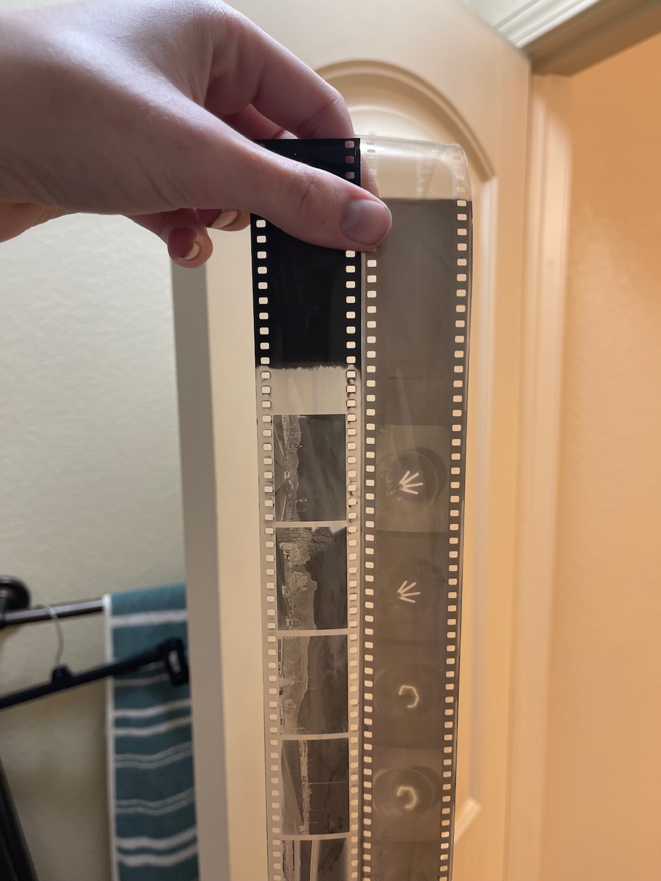

Found my DP negatives. Here they are compared to Imagelink HQ.
Would this be close to how the Fuji stuff would turn out?
The one on the right looks like much less than >2.0 to me; I'd expect that to be 1.3-1.6 or so. So yes, I expect that would be how the Fuji stuff might turn out if you get it to behave according to spec.
